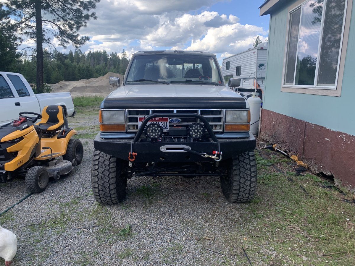

Finish front bumper - in progress

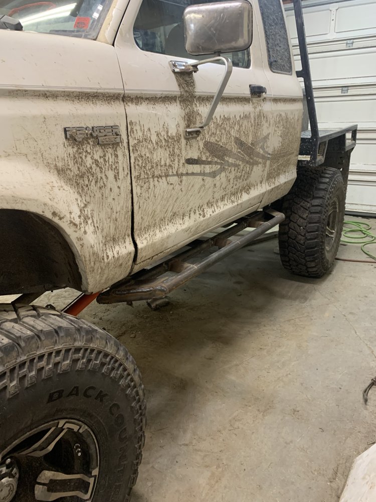

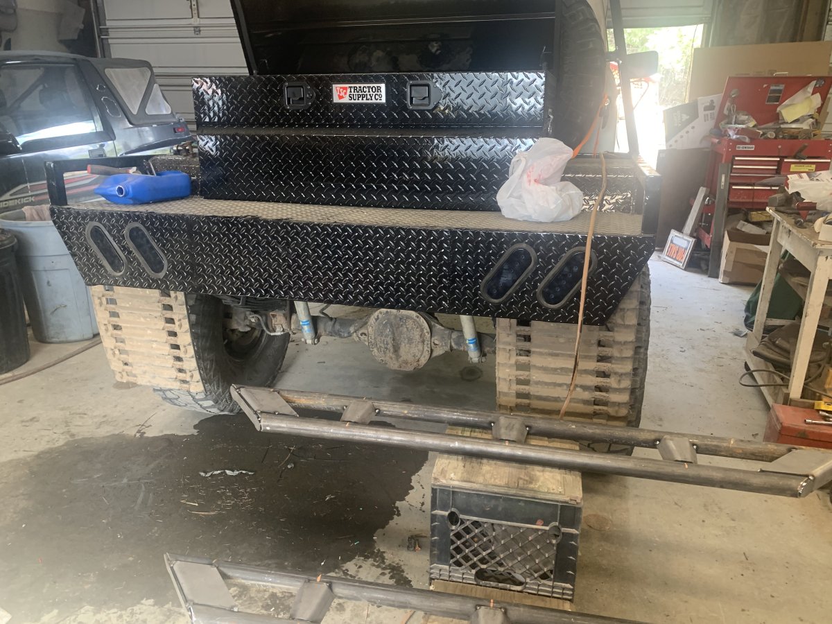

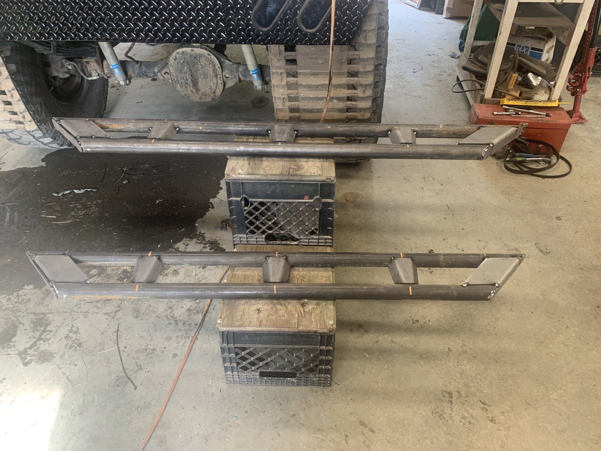

rock sliders finish and install them.

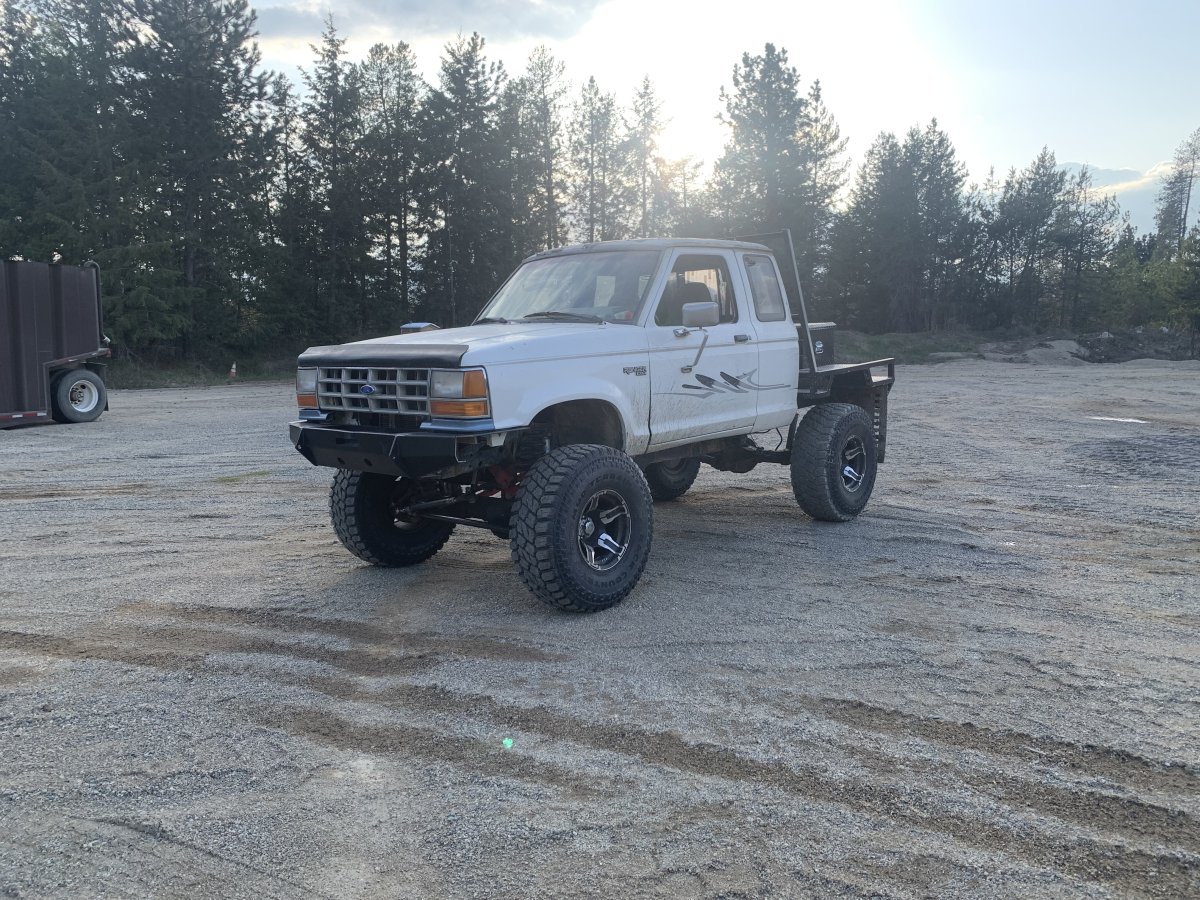

Got some more done. I moved the steering down to UTK and 45 mph I had very bad death wobble..... After swapping tires and finding issues with my track bar that I fixed. 10 years ago I guess i put the stock bolt back in the axle side which was 10 mm. The bushing was bigger and it ate out the axle mount. Drilled them both to 1/2 and had no play....Thinking I got it, I drove it and it was no change. Called the tire shop and ordered tires. I wanted new tires and I wanted to get rid of my 5 on 4.5 to 5 on 5.0 adapters. I had nice 5 on 4.5 10 wide wheels. so idk what was messed tires or rims or whatever but no more death wobble....I know my track bar to my tie bar aren't the same, and I'm going to work on that. I have more room there with my steering stabilizer mount gone, so I really think I can add one. Also my tie rod ends are rolling so i ordered some Cure kit from RS and I'm going to give it a try. I just am not sure how much work i want to do to this D30. If I can get my sway bar on and get my steering stabilizer on and see how it drives. Idk I want to put money into my D44 not this D30.... I'm tired of this d30 it is the bane of my existence. I know I was a cheap collage kid but I'm fixing issues I did then. lol olwell right. haha Next i'm working on the bumper and the sway bar. My Ebrake cables came in also. need to do the rock sliders also. I cant get into this thing. lol with the new tires its even taller...:cool:

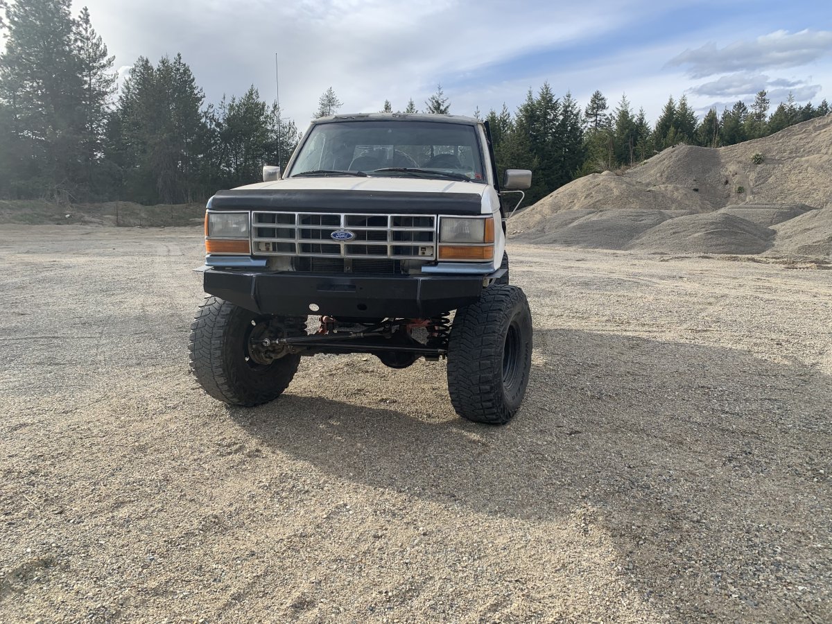

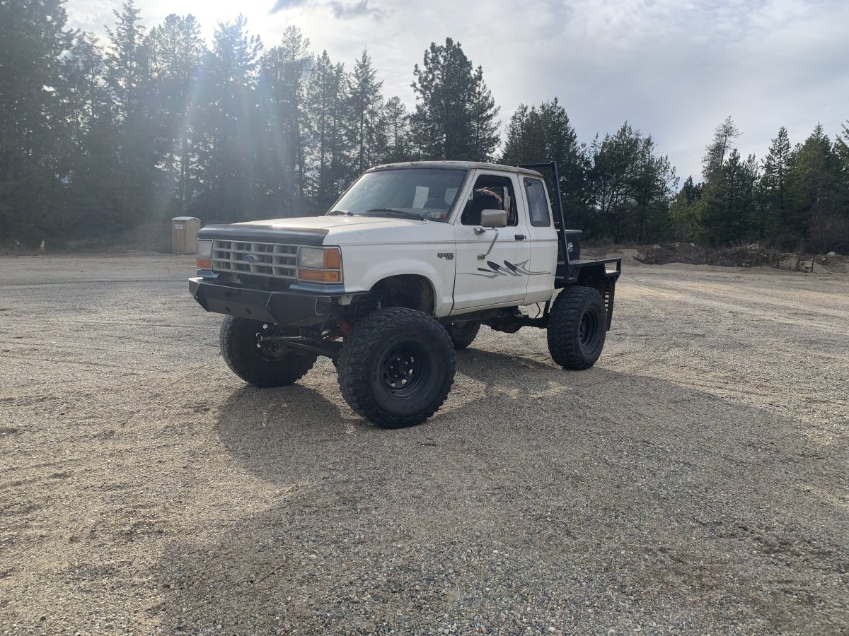

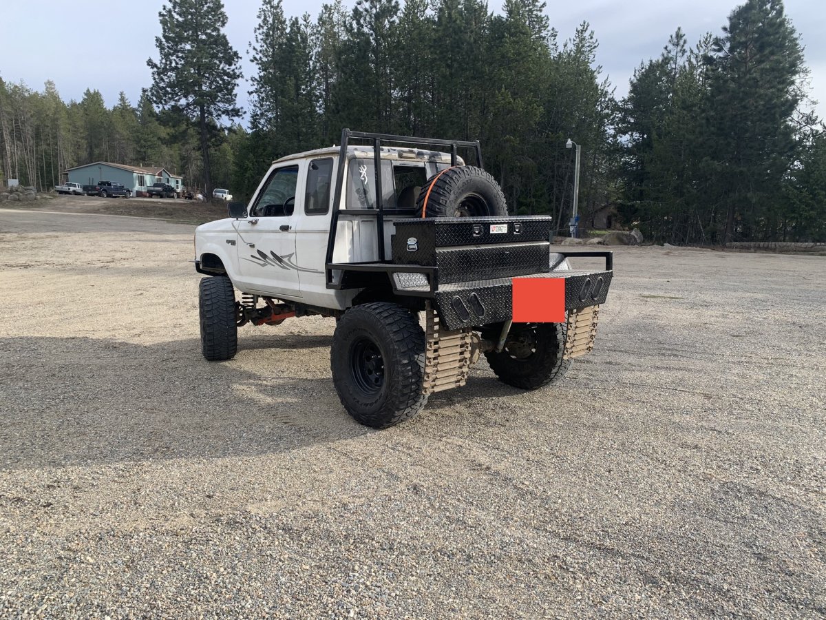

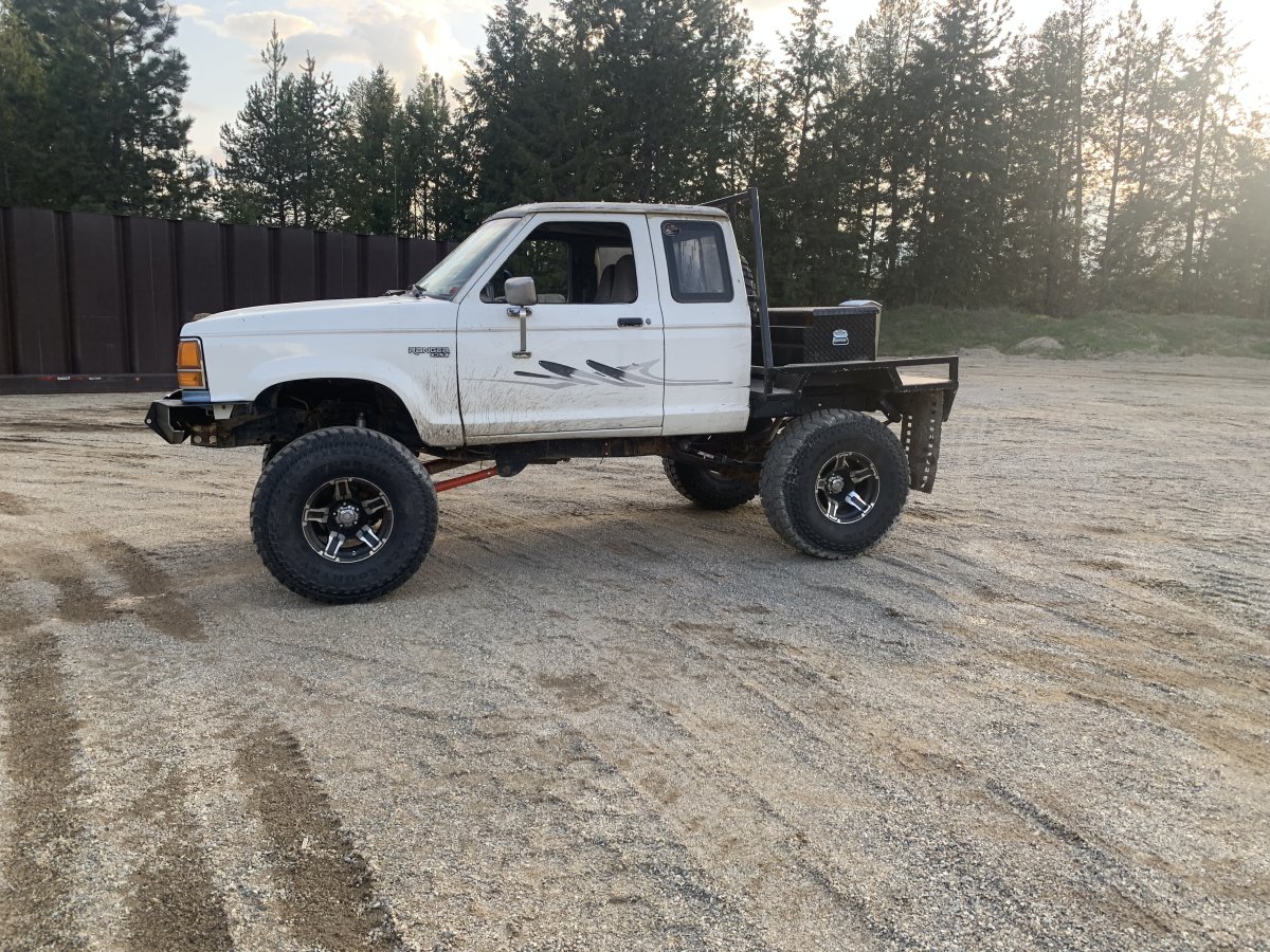

Haven't posted in a while. Here are some current pictures and some more on the ta-do list.
Install resealed and tapped steering box for hydra assist steering. Ram is here.
Sway bar is half done, have to weld mounts on the axle still, and build links but I'm almost there.
It drives ok, from 0 to 55. after 55 its hard to keep straight. I'm hoping the sway bars fix that and getting my steering done up a little tighter will help. Try to do something to it, when I'm home on days off. Its sure nice to have steps to get in it!!!

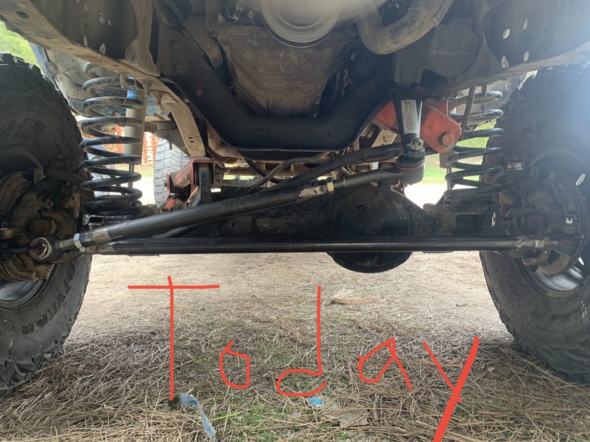

Your handling issues are likely your drag link to track bar geometry, the track bar is way too steep, the lower mount needs to be moved up, and the closer to the same length between the two the better...
What is the angle on the knuckles as well? IIRC it should be 6-8* for return to center. Anything less will give a death wobble. I only ask this because one of the images from the side, it looks like the front axle is set back an inch or two and maybe twisted the angle down.

It definitely could be, and it might be just time to put the D44. My D30 I put in it has the cad disconnect and i have very little room there to move the track bar mount. I just have to finish building the D44.

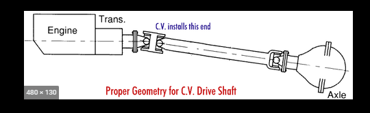

I just checked it but the problem with it is I can't adjust it any more. I have a CV drive line going to the front, and with that you have to point the diff at the transfer case. If you don't its my understanding the CV drive line will fail. My front drive line is to steep to have a normal drive line. Unless I'm wrong, but I'm pretty sure, that's how you are supposed to set up for a CV drive line.

My caster at the C of the knuckle if i remember was 0*s. But am wrong to thing that? I always thought a CV drive shaft should be pointed up to the transfer case in either a front axle or rear axle? I do have the front axle disconnect by passed. This is pretty much how I have it setup.
With offroad suspensions compromises have to be made... I'll have to let someone else chime in on how important the CV pinion angle deal is on a non drive axle compared to having some pinion angle, having a live front axle might just change things, but it depends on the use and how much pinion bearing and front U joint wear is acceptable, having the pinion angle within a few degrees should be acceptable...

I've got to add the sway bar mounts to the axle still. I had to build new mounts to move the sway bar on the frame side, it just hit the coils.

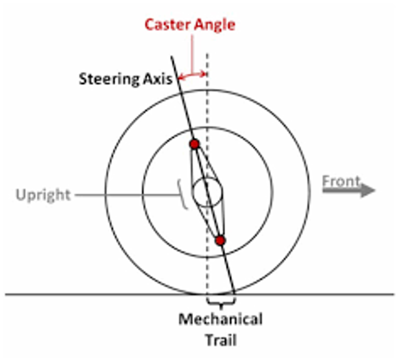

the "C" should be tilted for a return to center. I cut and turned my "C"s to change my pinion angle up. When I welded them back on I had IIRC a 6* or 7* angle. It should be somewhere between 6-8*.
Well I just adjusted my upper control arms. My caster went from 0* to 4.5* and I’m out of adjustment. But I took it for a drive and it drove night and day. I’m curious if I was able to get to 6-7* how much better it would drive.
