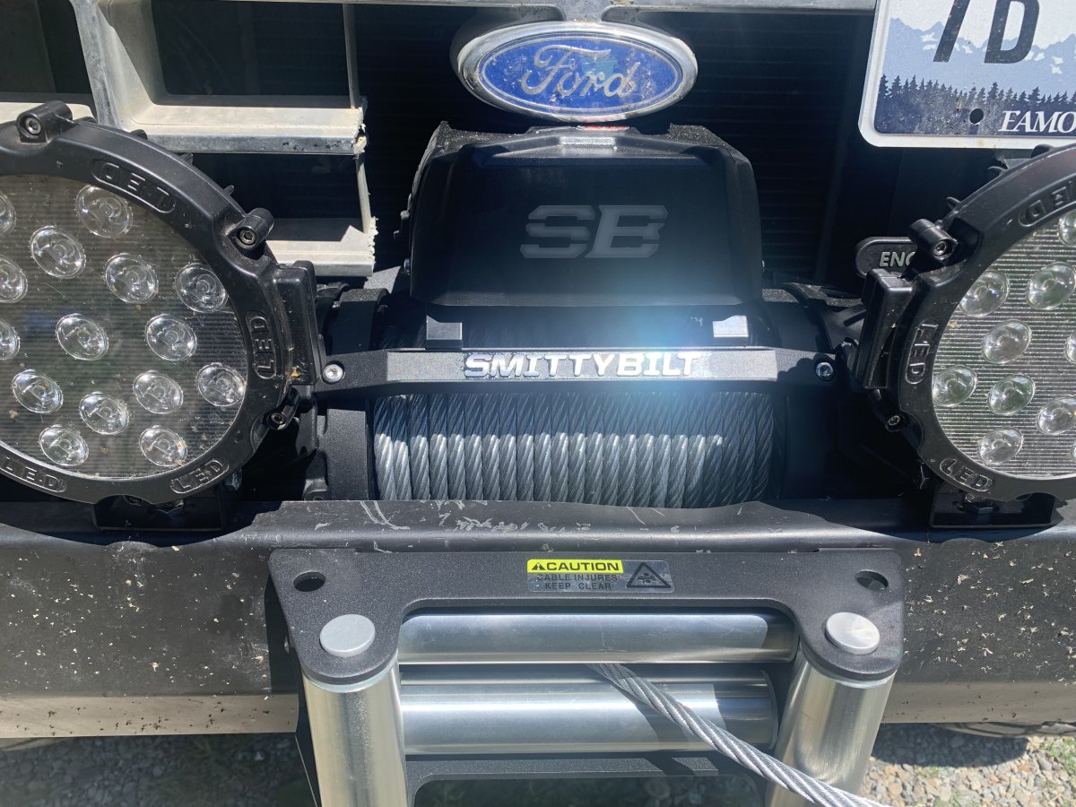

I've got a few more things done on the Ranger. I pulled out my Chinese winch and put my Smittybuilt in. Had to trim away more of my grille which olwell but I didn't really want to do any more but it fits and its on there.

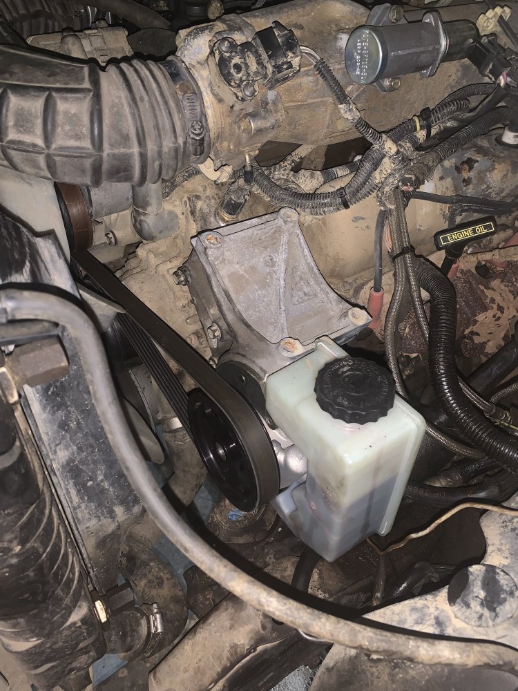

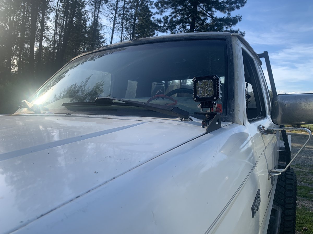

I did the power steering upgrade, to the jeep liberty pump. I'm not sure if it will be enough pump to do hydo assist steering now. But I'm going to try it. I have the underdrive pully on it, well see how it does. I bought a G3 250 amp alt, I'm excited to get it on there. Added some hood lights, Really like how they look.

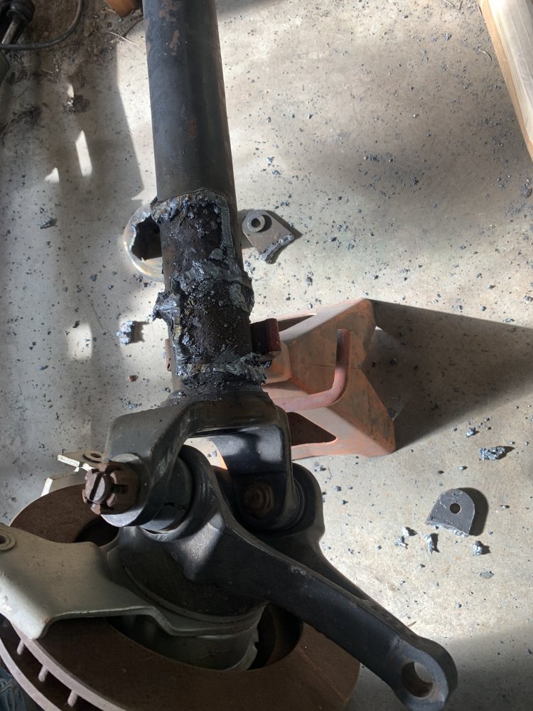

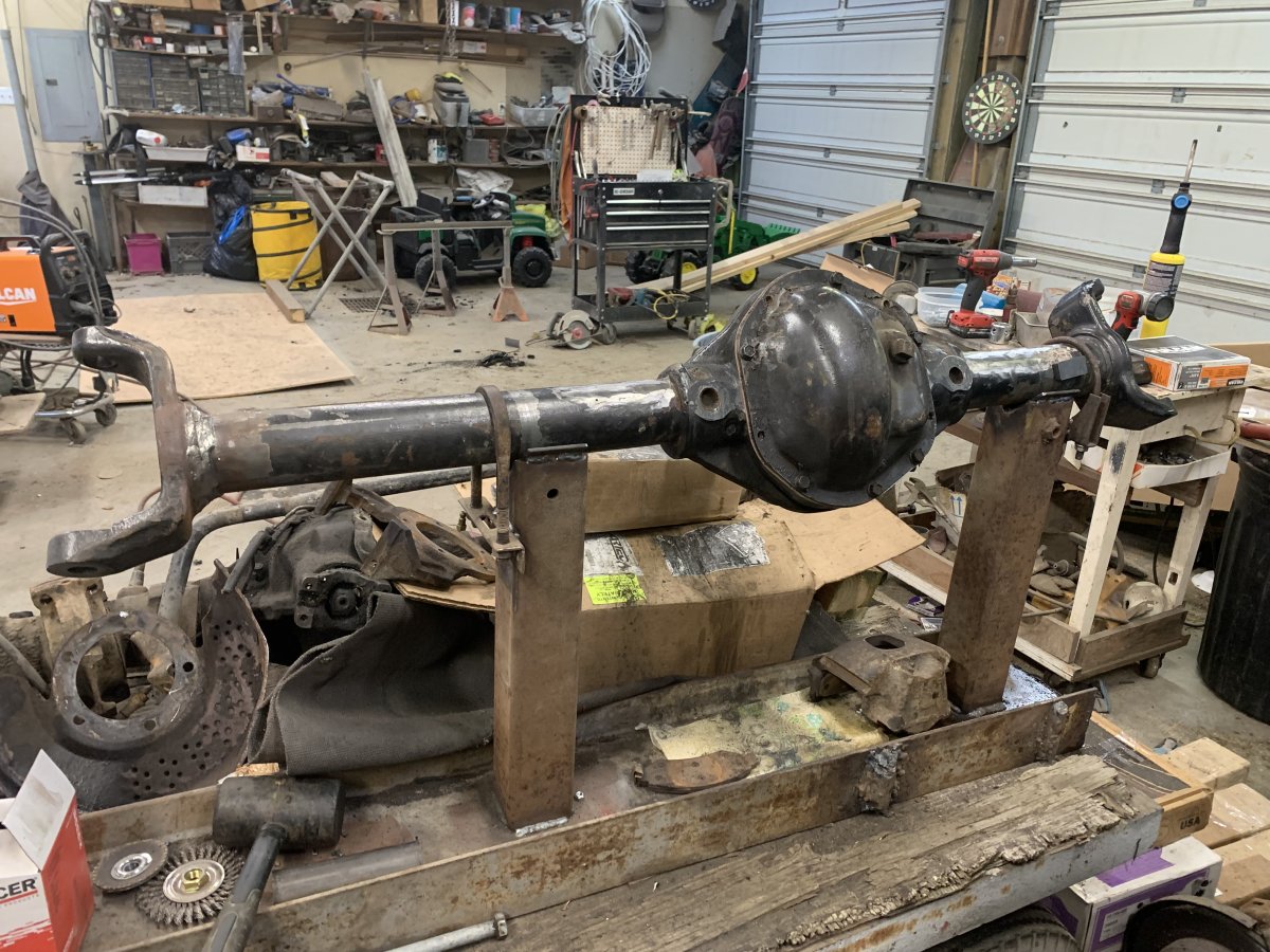

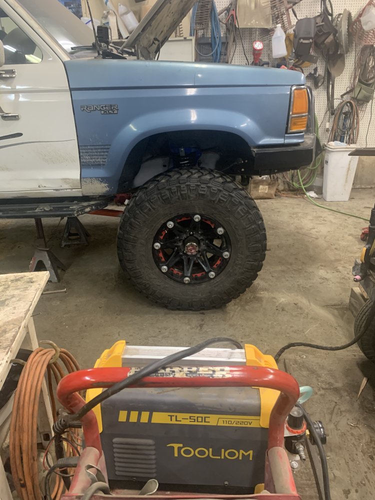

Well I didn't do anything to the ranger on this days off. I did buy a Brand new yukon grizzly locker ($300 bucks brand new in the box market place for the win) for the D44, ordered 488 gears and a rebuild kit. Started cutting of the long side coil mounts. Have some more trimming to do with the plasma cutter and all get ready to narrow it. I'm not 100% sure I want to do it yet, but Idk I don't want this thing to be to wide. I feel its close already, I get that i can buy custom back spaced wheels and all that but its already 10 in wider than the D30. I do have an early D30 that is narrower than the newer ones but still.

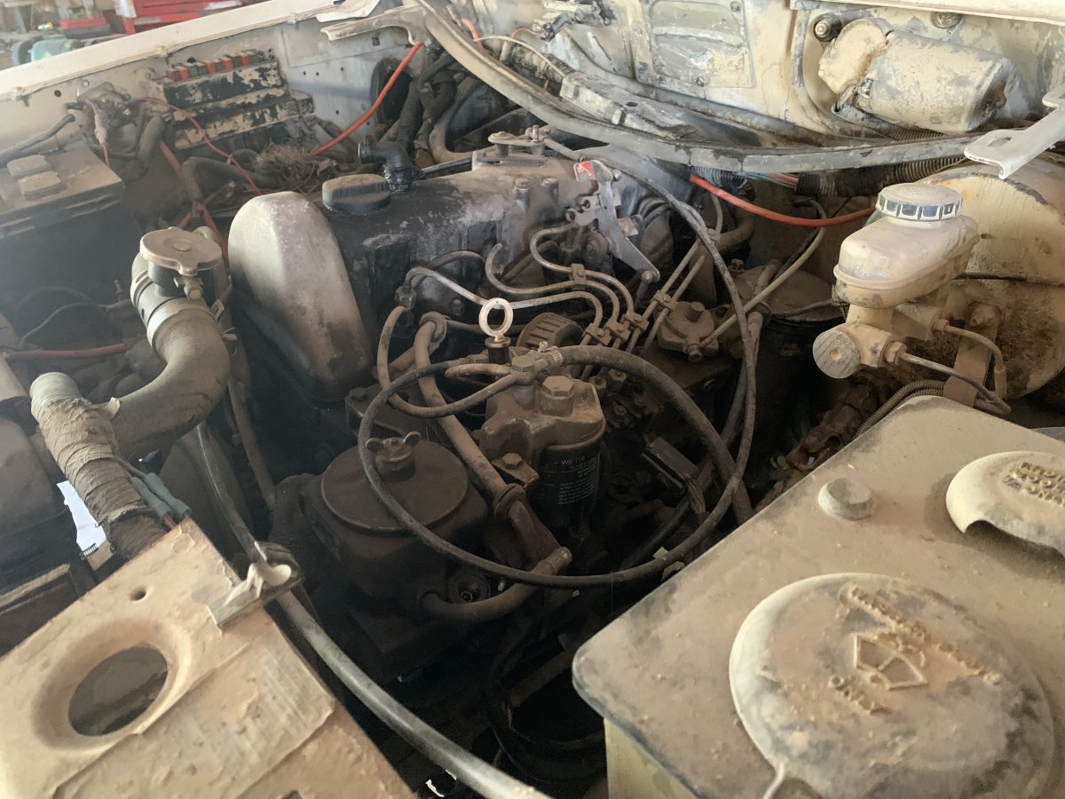

Also got the B2 into the shop, need to pull the engine on it, and see about a rebuild.

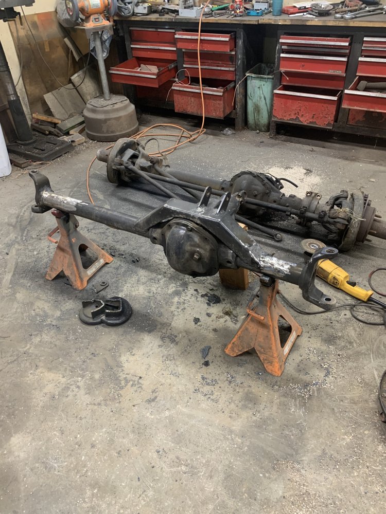

Well its been a slow go. I've got my D44 pretty much ready to be narrowed. I think i got a guy that will do it hopefully. Well see he was kind of being difficult as to what I wanted but sounded like he would do it. Well see hopefully it works out. I have another D44 from a 79 that I want to narrow also. I've the grizzle locker, bearing kit and 488 gears for it.

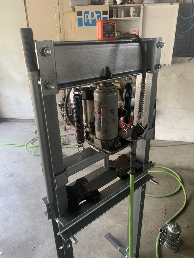

Well I don't have much to report on other than. My chrome moly axle shafts came in, and I checked fitment and it looks like it right were it needs to be! Got my press setup just a 12 ton that I added a 12 ton air over hydraulic jack to. Should do the job pretty well. My Detroit locker came in for 8.8. Everything is almost in place. Going to start building the axles as soon as the cold weather sets in.

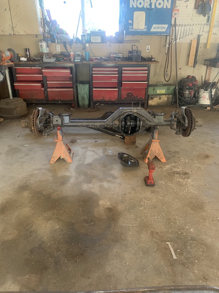

Well it was a lot of learning but I believe I got it. Re-geared to 513s and the grizzle locker installed. I'm working on getting the wheel ends on right now and will be getting it under the ranger! I'm going to work on a home made truss for it once I get it under the ranger and under its own weight. It had a home built truss/3rd link mount built on it, but I'm pretty sure it was going to hit and I want to put the 3rd link mount on the passenger side since I have way more room on that side. I already got the D30 out from the ranger so its go time!

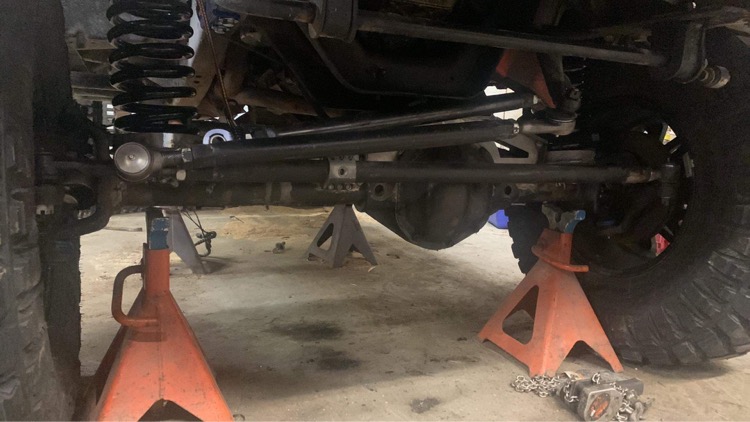

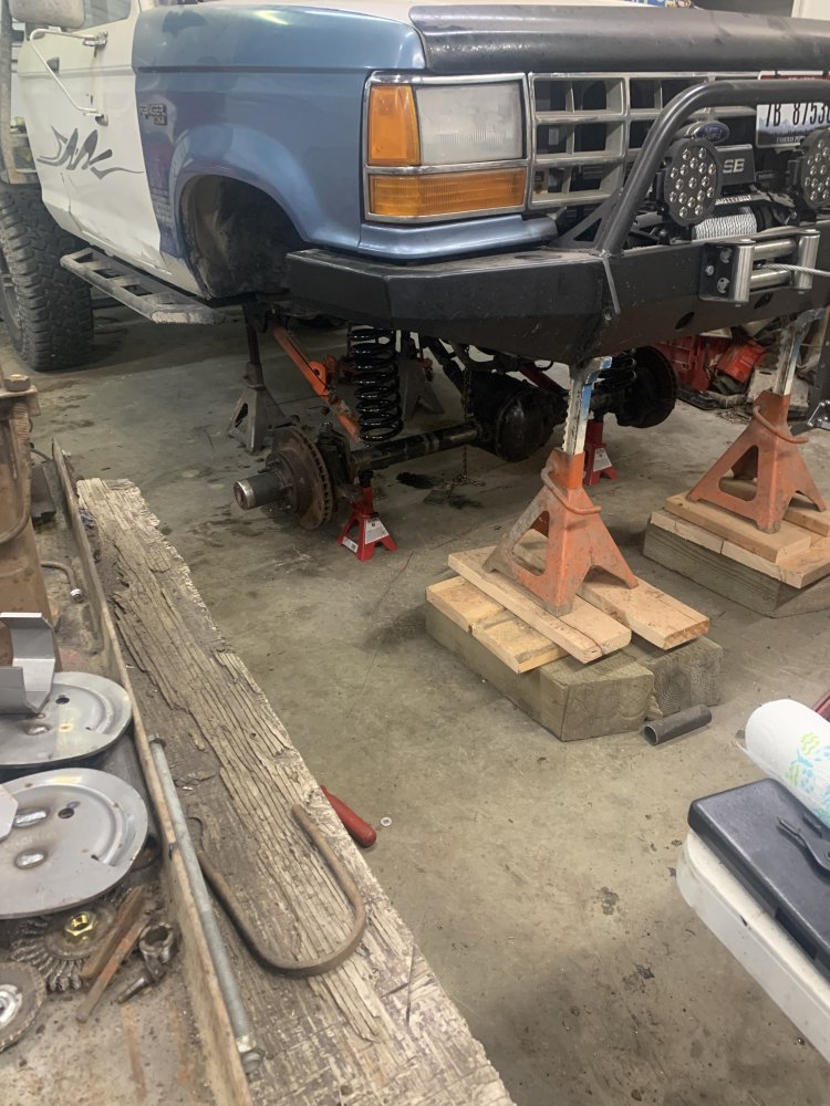

Haven't posted I a while. Got the axle pretty much together. Got my lower link mounts on the axle. I looks like I'm going to have to move them in some. It looks like my tires are going to hit pretty good if i don't. I ordered a few more parts, some came in, new duff coil buckets, mile marker lock outs. I had to order a truss. I wanted to put my 3rd link on the passenger side but that's just not going to work with the exhaust right there. I have some room right next to the front drive line, So i'm going to do the link there on top of the diff. Thats why I ordered a truss. I really wanted to get more done, but it was a busy 2 weeks over the holidays.
Got my Tie rod bar on, and went Over the knuckle and it doesn't hit anything! So it looks like Ill get some better angles now that I went higher. Now i just need to match it with my Pan hard bar, after I get my links taken care off.

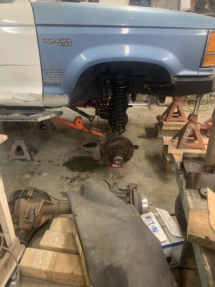

Well got quite a bit done this days off. I disconnected the fuel lines and got them moved out of the way. I'll let that air out while I'm out of town working. Hoping next week, I'll have the 3rd link built and the axle sitting on its own weight.
I'm hoping the tie rod from the steering box to the y link gets a better angle. Its still pretty steep even with over the knuckle. I really don't want to hack on the truss any more. Ive already cut a foot and half of it, and If i go with a the lower track bar mounting holes ill have to trim the truss. After I get everything looking ok, I have to pull the axle and weld everything up.

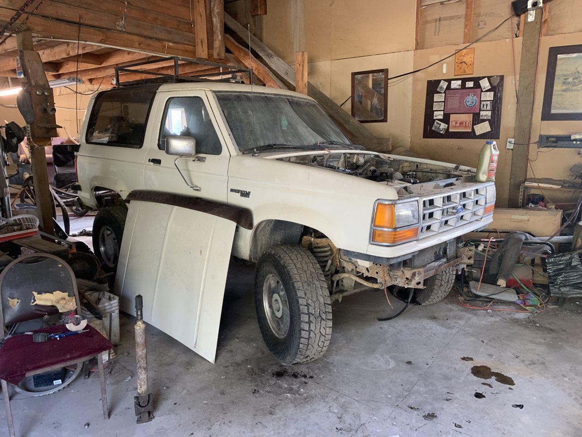

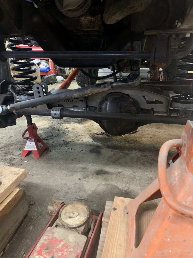

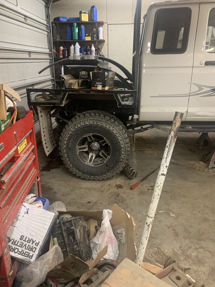

Well I'm getting closer! I made a deal with a buddy on his 37s he had, got them mounted up. Got my 3rd link welded on, had to trim a bunch of my engine cross member to get 3-4 inches of up travel. had to cut off my track bar mount on the axle and build a new one. I got a lot done. Got tires on and it sitting on its own weight. I like I said before I wasn't sure if they would fit, The wild horse springs compressed more that the xj rusty off road ones for some reason. Still don't have a clue why because there suppose to be super soft, some where around 130 PPI and the EB wild horse ones are way higher. Idk doesn't matter I'm committed to the wild horse springs and being that there progressive they should be better. But anyways, I should of took a final picture. Because my track bar is on now. Pretty much have to pull the axle weld everything up and reinstall and move to the back. I have more height now, it was hard to tell. until I got the tires on and Yeah baby! 37s it is, to fit 40s Id just have to trim some of the fenders and they would fit. I'm pretty happy. I was going to move my 3rd link down some but Its pretty much level and Cutting some of my cross member off after talking to a few people of FB seemed like a better move. Getting closer! pretty happy.

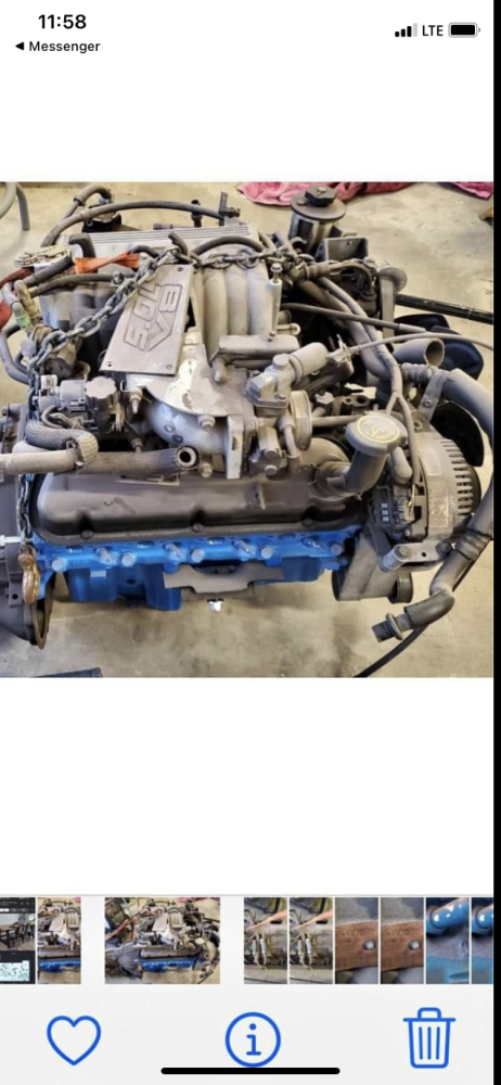

Should of took a better picture but I found a good deal! Don't know when I'm going to do it, but it looks like the goal will be to blow up the 4.0 this summer and go V8 next winter! 98 explorer 5.0. Guy said it was gone through, Idk, has GT40 heads on it. I've got a M5R2 from a 98 4.2 f150. Ill have to pull it out of the bronco. Also have a 205. Looking at different options for for EFI. I've looked for a good deal for a while and its been like impossible to find a 96-97 one. So I'm guessing that this 98 has pats. I'm guessing that's why the guy sold it. He didn't want to deal with it with his Early bronco. He decided to LS swap it instead. It was a mad dash before work to get it yesterday morning. So I didn't talk much. He gave me the wiring harness and computer.

For a lighter transfer case option, the 4406 from '97-03 F150's work nice, that's what I have in my V8 Explorer and have another for my other V8 Explorer :), slip spline rear output is less desirable but whatever...
Yes '98 will be PATS but I think most people go megasquirt or microsquirt but there's a bunch of options anymore... luckily I have a '97 mountaineer stashed for when I get to fixing up the '67 mustang and go from the 289 to a fuel injected 302 with 4R70W instead of C4... not against 289's or C4's but I got a $200 mountaineer...
