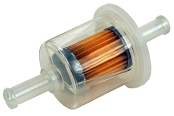

Ah. I understand now. I thought you were talking about one of these:
Now I think you might be talking about what's inside that? Otherwise, I'm not sure.

It's similar to what's inside that, but slightly bigger. I read up on it and it's another smaller canister inside the frame rail farther back than the other. On some models the canister opens up and has a little filter in it with an o-ring. Some models don't have a filter at all in the canister. And some don't have the canister at all.
Attached a picture of the filter, but I can't find one of the canister that it goes in.
Found a picture of the canister. It's called a fuel filter cartridge I believe.

That's the one I replaced. When I said canister I just meant the shape. Where is the one that I showed in the picture at and would it restrict fuel flow?
