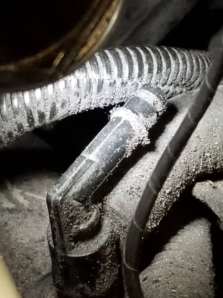

Got another problem, anyone who can help I'd really appreciate it ASAP. Started off this morning, following my grandpa to do some stuff. Right when I pushed on the gas pedal, I noticed it was sitffer than usual. Usually it feels like nothing there but now I had to put slight effort into pushing down on it. I noticed my acceleration was poor as well. Kept going then when I made it to the highway I could really noticed the difference, I couldn't get above 45-50 mph. Pulled over but everything was too hot to check so we went and did what we needed to and came back. Checked all the plugs and wires, had to push one wire down at the dist, but the others were fully connected at the plug and dist. Grandpa thought maybe it was my gas pedal or throttle cable. Checked that and it seemed fine. Checked my air filter and it was really dirty so we took it out. Drove home going 40-45 (couldn't go any faster) the whole way. On the way home I noticed the pedal had returned to normal. Anybody have any ideas?

This is the only suspicious looking thing I could find. Not sure if anything was connected to that little piece before, but there sure isn't anything connected now. Anybody know what it is or what it does? It's on the passenger side near above the #3 plug on the valve cover.

The picture looks like a pcv valve with an extra vacuum tap. Mine has that and the extra vacuum tap is plugged on the end. If you need the extra tap you are supposed to cut the end off of it before you put a vacuum line on it.
