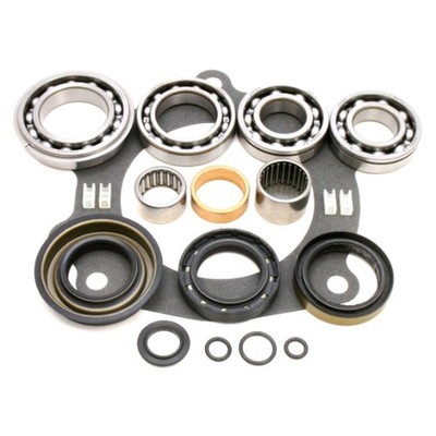

Here's a bearing and seal kit - RockAuto has them or eBay: USA STANDARD GEAR ZTBK1350
If you don't want to replace the bearings while you're in there (check the outputs, I have found those to be severely worn fairly often) then you just need an input seal, both output seals, a shift shaft seal, and some o-rings. I can't find all that together as a kit.
I found just a seal kit on ebay, https://www.ebay.com/itm/174217096158
Though with my luck, the bearings will be on their way out since I didn't order the bearing AND seal kit
