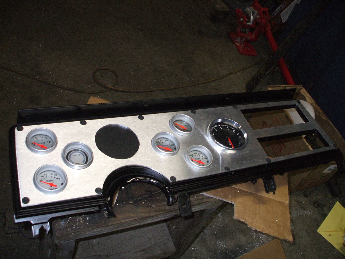

I got my dash bezel installed finally and except my speedo all gauges are in.
Just have a filler panel in where the speedo will go for now.

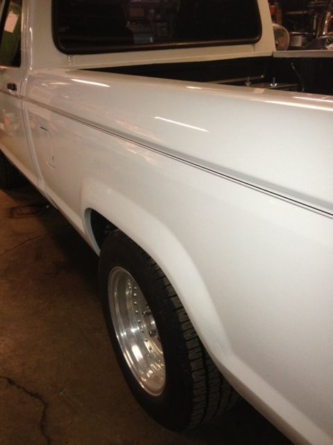

Warmed up the garage and finally got around to laying down the pinstripes. Truck looked good but very plain to me. So I picked up some silver tape to outline the black on the hood and tailgate.Then I did a small black/silver stripe down the side. Very simple and easy but dam do I love it.
