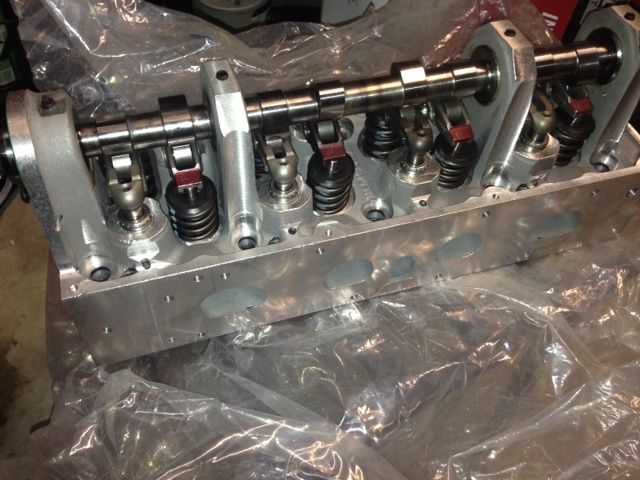

Got Essy head all finished up and it looks great. The chambers are done,runners all cleaned up,titanium retainers and machined keepers,B&B Performance stepped head stud washers installed and spring pressure set at 124lbs on the seat.

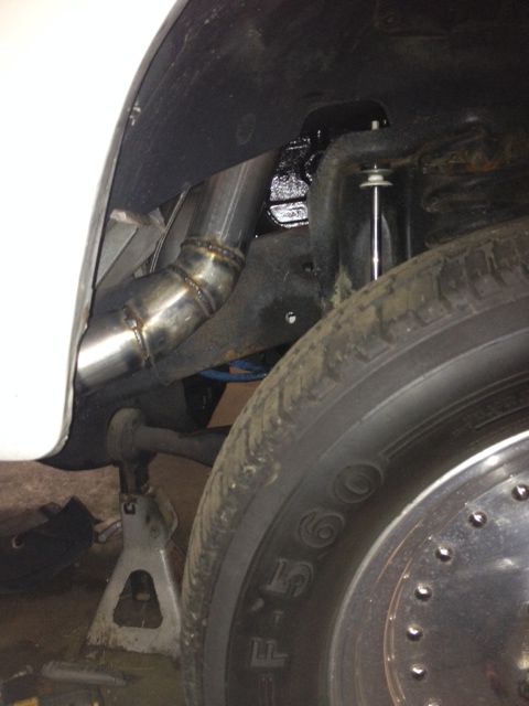

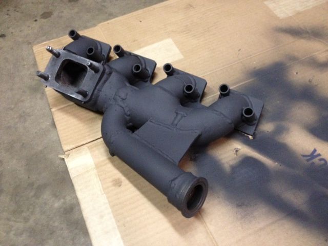

Then I decided to build my own log header and change my turbo location and run my exhaust over the frame rail {to get away from trans} and down the rocker with a dump just before the leaf spring.
