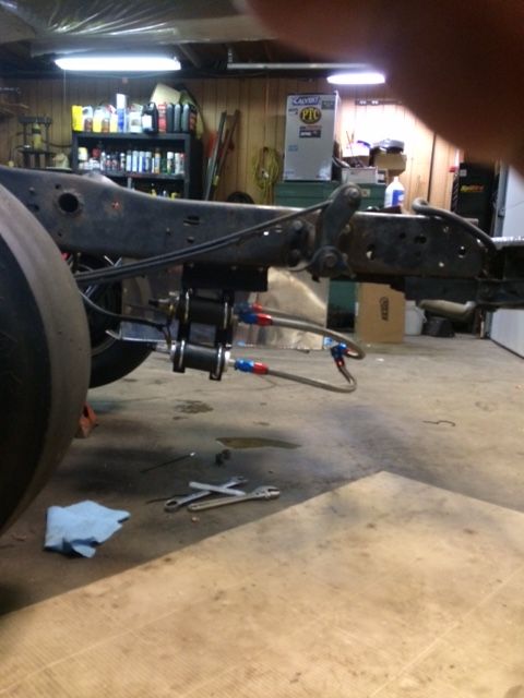

Then it was time to say bye bye to the stock fuel system..
88 Turbo Ranger resto
I mounted a 15 gallon cell thats plumbed to twin Walbro 255's with pre and post filters.

I have -8 lines going to the rail and back to the tank. I put together a stock fuel rail with tube nuts on it to except the AN hose ends but not sure if Im going to use that or a billet rail Im making.

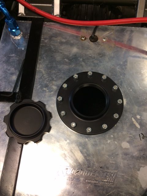

Today I got my new filler cap for the fuel cell. I bought a Earls spin off 3" cap since I hate how the other style lets everything fall into the cell when you remove the cap. This one is raise above the top of the cell so nothing will collect arond the cap and fall in now.

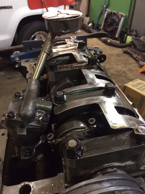

Im almost ready to drop a new bullit in and this one is going to finally let me push this truck with no holding back. On top of that it going to be one sexy lookin motor since I had almost everything powder coated this time.
.030 over block
JE pistons w/Total Seal rings
Childs & Albert 5.2 rods
Esslinger main straps and studs
Esslinger billet aux shaft kit
Esslinger windage tray
m127 pump

Looking good, I like the wheels!
How much power this going to be pushing
At 30psi and spraying the water/meth Im hoping to put at least 450 to the wheels
What Head gasket are you going to use??
I would go with multi layer copper, or multi layer steel.
Truck does look really nice.
how much did those door panel cost if you don't mind me asking.
Robert
posted using a can of corn and chicken wire.
Im using a felpro 8993 gasket. No need for anything else.
Panels cost me $150
Nice was that a ranger engine or one out of a mustang
No clue what the block came out of. Nothing else on the motor is stock or original. The crank came from Esslinger also.
