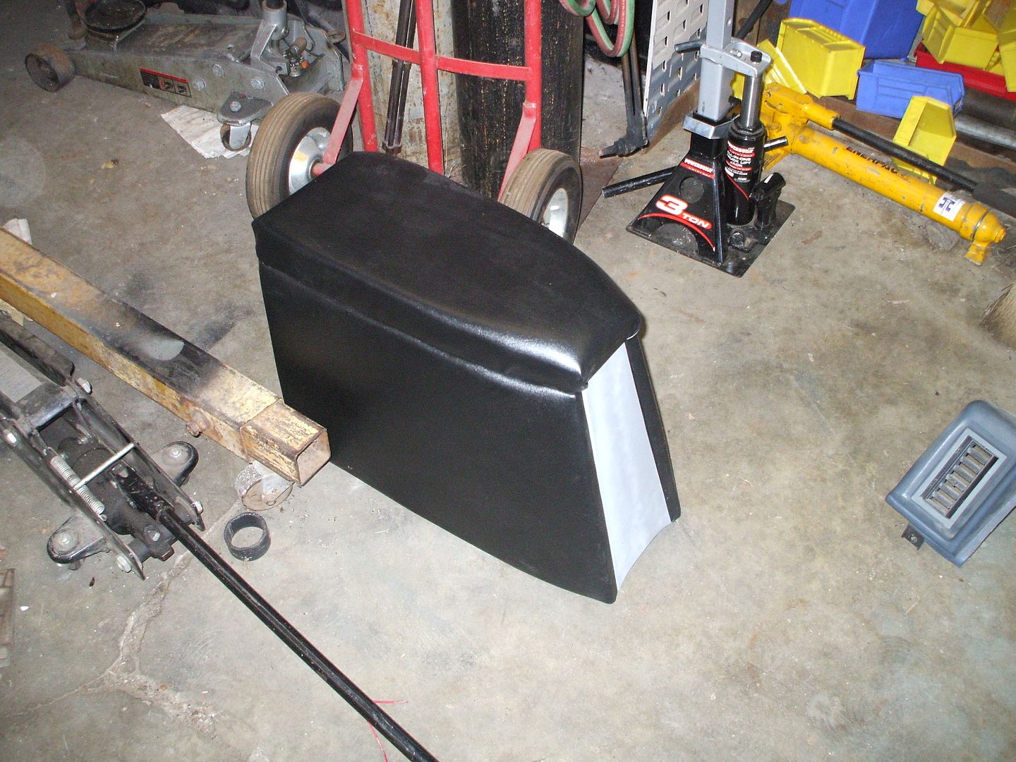

The console/sub enclosure turned out awesome and fits perfect.Uses a Jeep Cherokee lid and tray so it is easlily replaced should it get broken. Colors match interior alot better than they show up on my camera using the flash. Still might change color of the lid later tho.
And as a bonus I have a second console made that is longer and taller that will be going in my 83 Ranger truggy since its an auto trans.

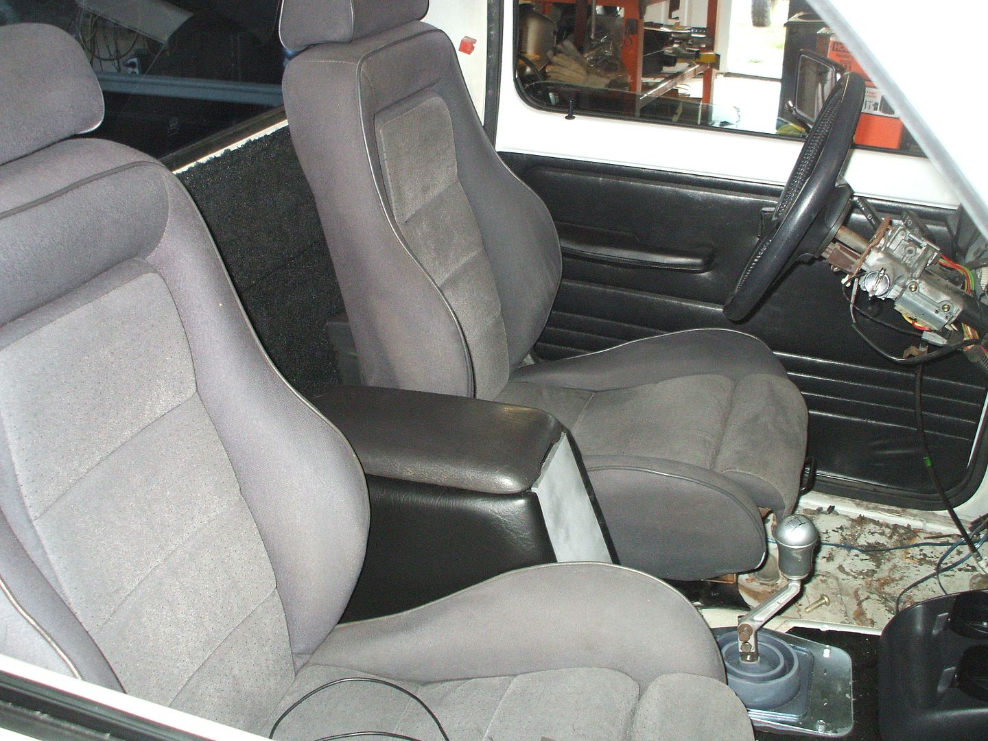

I got the shifter bezel all mounted down and the front console and love how they turned out! I welded cap screws to the floor seal plate and used them as studs. I just slid the boot and bezel down over the studs and finished it off with some stainless acorn nuts

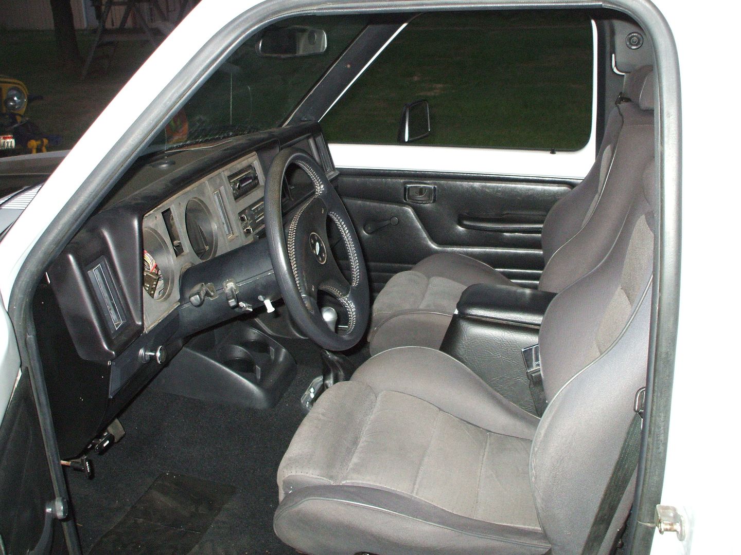

Still have a few details to take care of yet. Obviously no gauges installed yet,no sill plates,need new visors still,need tilt and have a couple rattles to track down.
But I did get to drive it for the first time today and put about 40 miles on it! Drives smooth and straight,exhaust is nice and quiet,very comfy interior,sound system rocks and even at less than half throttle it wants to roll out!

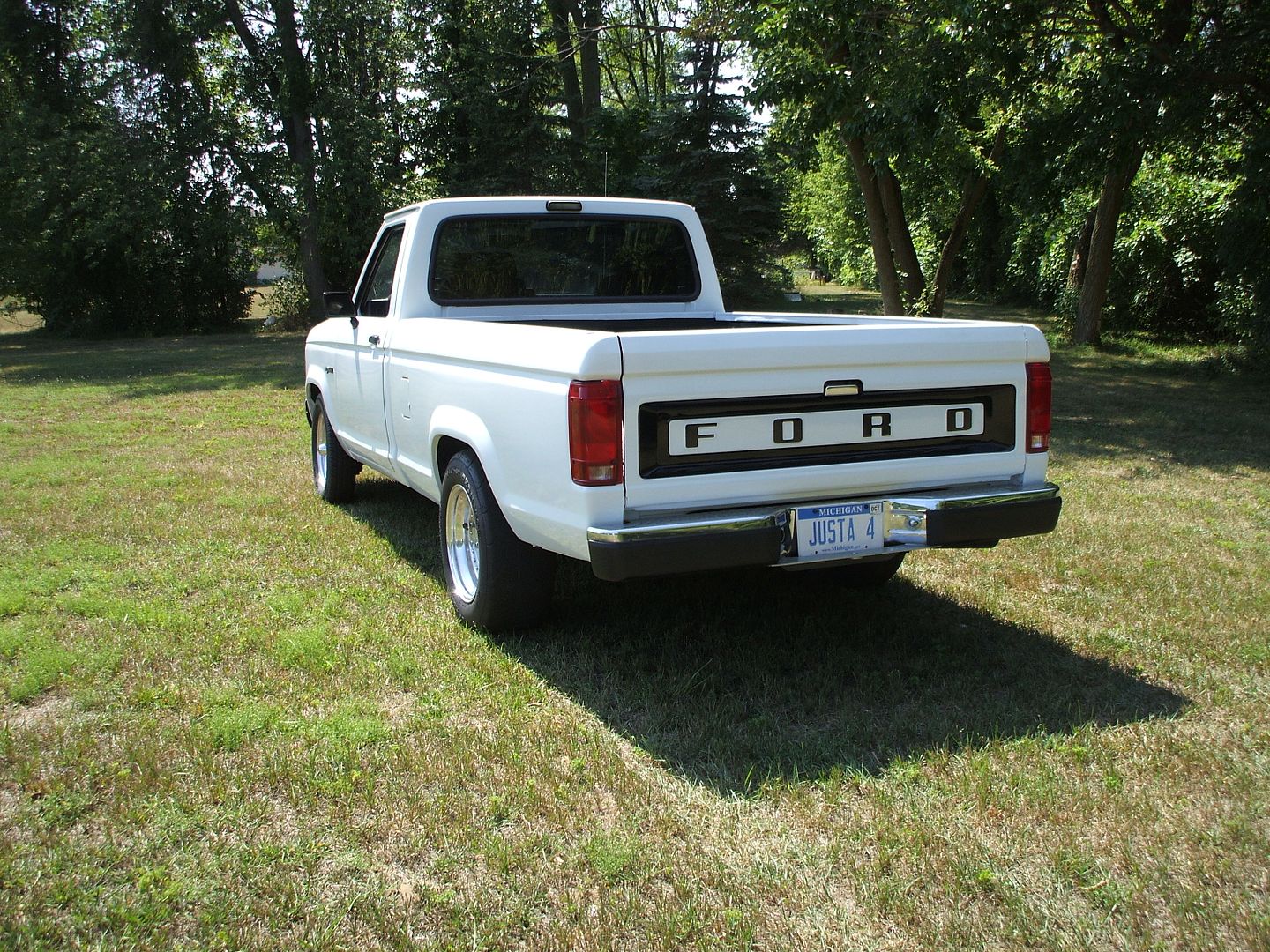

Drove it to lunch today then out to the back yard for some dirty shots.. Looks awesome out in the sun!
