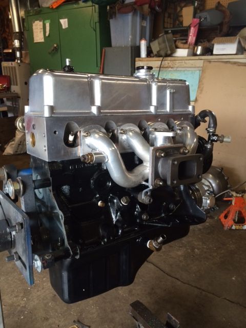

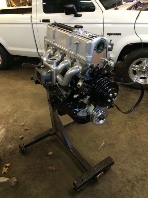

Motor looks amazing! :icon_thumby:
That header gives nice access to the plugs, did you build it? I am definitely going to look into a design like that if the one I have doesn't work out, locates everything right where ya need it! Nice
Its called a RodsHeader. Going to very hard to find another since Rod sadly passed away recently after he started making these again after a long time away from header building. Other than #2 plug being kind of tight with the gate flange its a dream to work with.

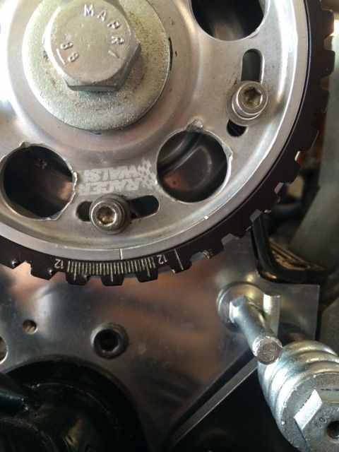

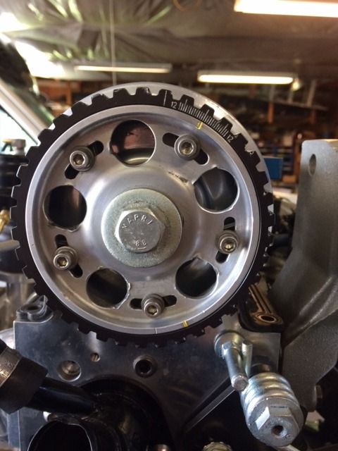

While setting up the cam I found when zeroed out and timing mark lined up it made the degree marks on sprocket read way off.
88 Turbo Ranger resto
So I re-clocked the outer gear and put new marks on it to now show a true zero on sprocket when cam is zeroed out.
Once I was happy with that she was dropped in to her new home..

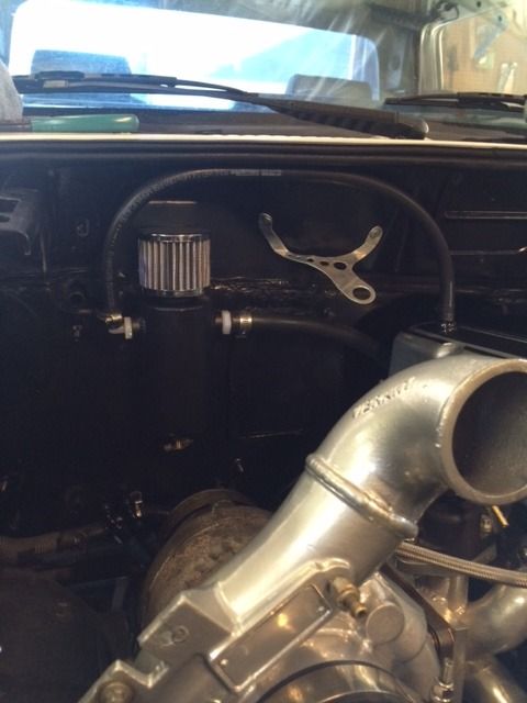

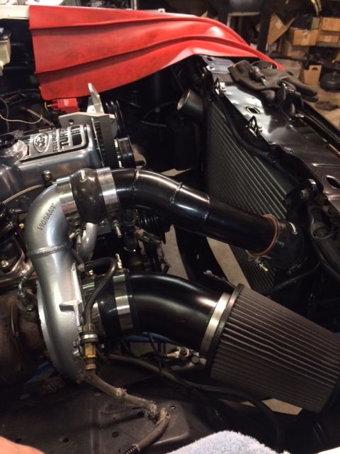

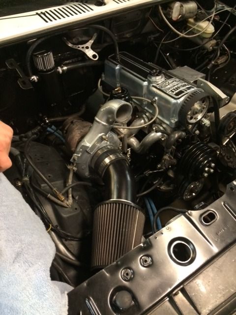

Got me new breather tank setup all plumbed and clocked the compressor where I think will work best. Grabbed some tubing and whipped up a new inlet as well.

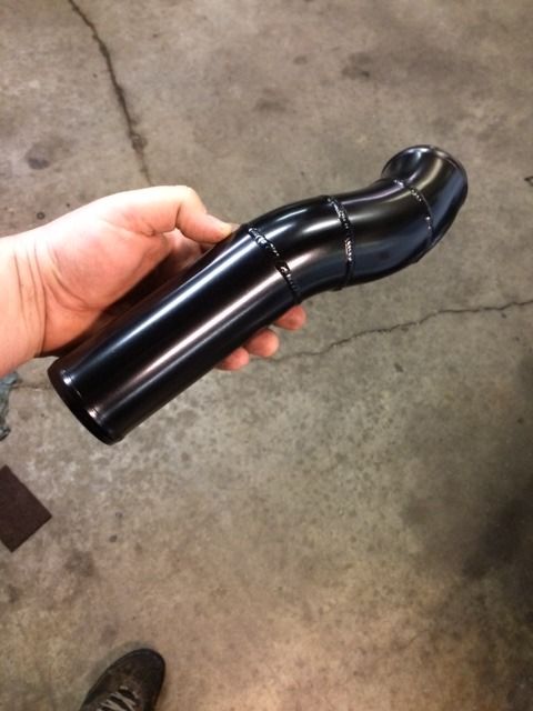

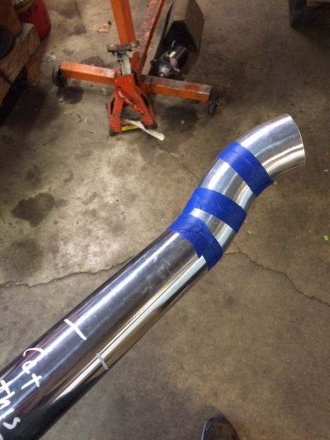

Started making new aluminum pipes to replace my old steel ones.

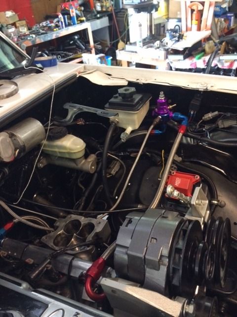

And I wasnt happy with how my pumps and lines turned out so I split them up and made new pump mounts for each side of the cell and ran new lines.

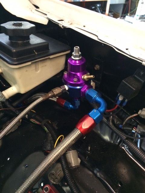

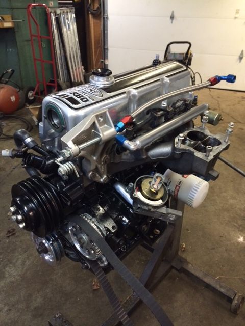

Fuel system now completed.
Magnafuel reg,my own rail,-8 lines
