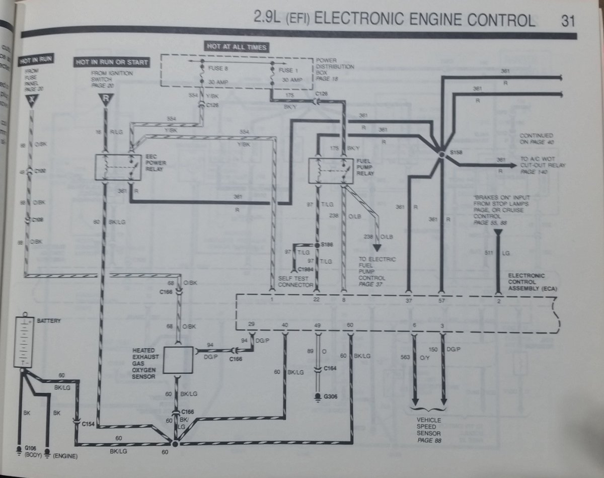

The new strange thing is the harness to the O2 sensor has 4 wires with one of them cut off. The cut wire goes to pin 49 on the ECU. The wire colors don't match the schematic I have, but I assume the ground goes to the black wire on the O2 sensor. The other 2 wires are white which I assume go to pins 49 & 29 on the ECU. I can't tell which goes to which wire or if it makes any difference.
I would have to check, but I'd assume that's the heater wire.
I don't -think- all the trucks had/need it depending on year and such
Here's a wiring diagram for the '89 2.9. For some reason it doesn't show pin 49 connected with the O2 sensor.
This page is from the Ford "Engine/Emissions Diagnosis" manual that you use with a breakout box. You'll see in the diagram that pin 49 is the O2 (HEGO) ground wire (that goes to the back of the passenger side head as I mentioned before). If fixing this ground doesn't solve the code 41 issue, you should read the rest of the page, and the note on "HG16" of the following page also.
