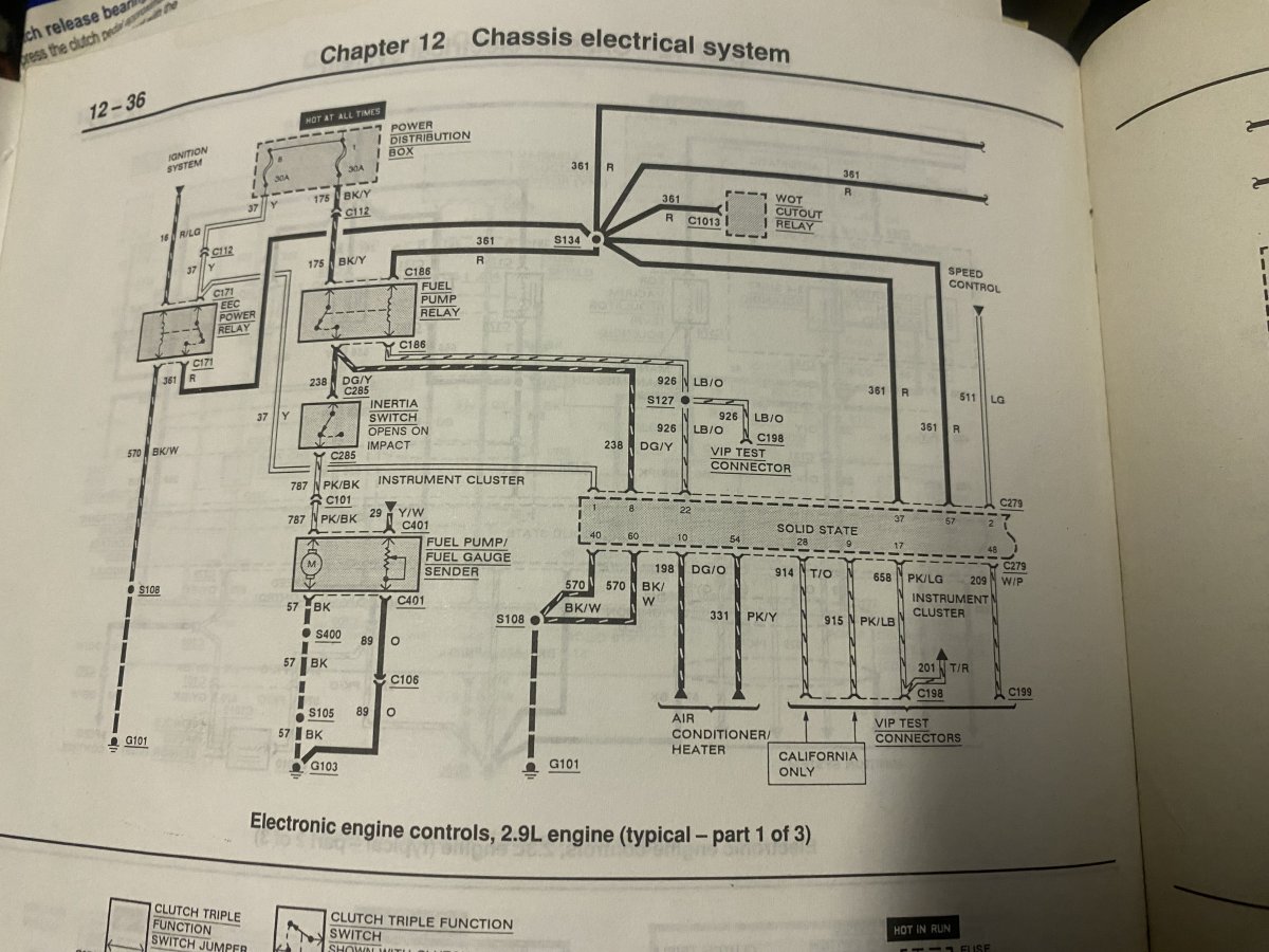

Can anyone tell me where the fuel pump sender ground and pump ground G103 is located? Is it on the frame near the tank?
Could anyone with the evtm for a 87 ranger snap a few pics related to the fuel pump power distribution and ground locations? I can’t find that manual anywhere

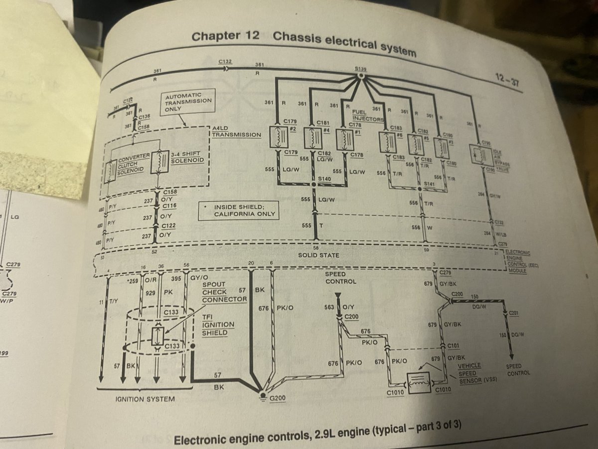

Ok I’m not clear on what would be considered eec to motor ground wire. Would that be pin 8 or pin 20? Or does it mean pin 22 on the coil side of fuel pump relay?
