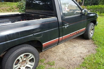

So here it is, the day I parked it in my yard, where it sat, for a while, until I decided to give it some love.

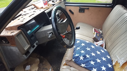

The interior was in shambles.

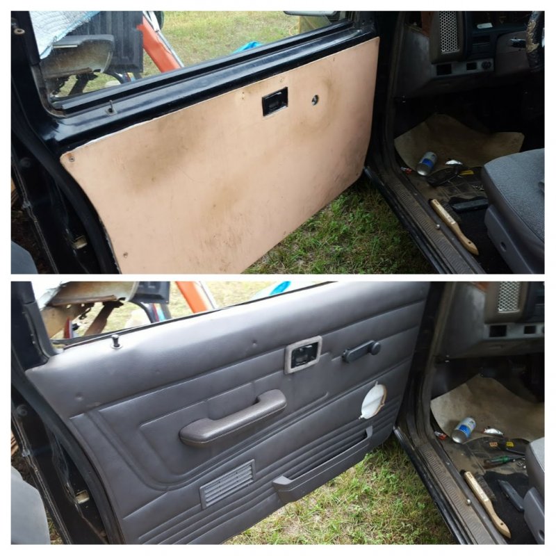

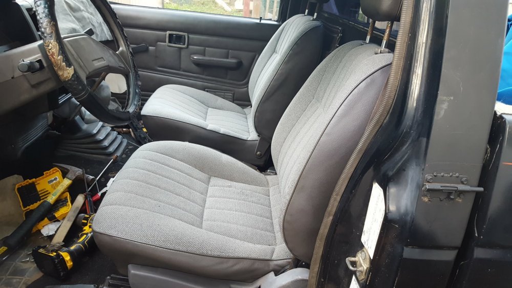

So I got a set of Buckets and some decent door panels
31746
I will be putting the Explorer console, from my Ranger, right between those seats. Gotta have cup holders. :icon_thumby:

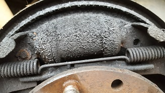

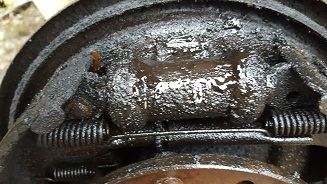

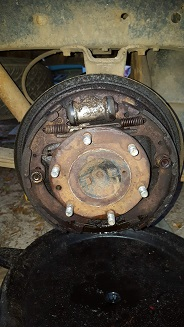

Now on the mechanical stuff. the first thing I noticed was the leaking cylinders. Since I worked at a brake shop for a few years, this was no challenge for me, and should be pretty simple for almost anybody.
59906
59907

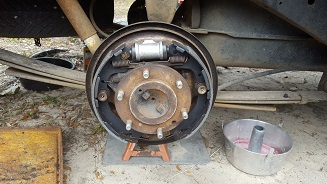

before and after.
59908
59909

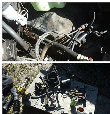

While the wheels were off, I did this
59911
Emissions Deleted!

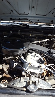

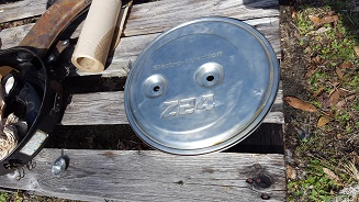

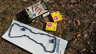

So the Valve cover gasket came, but I wanted to spruce the engine bay up a little while I had things apart. So I first stripped the paint off of a few items.
59913
I really liked the look of the bare metal, but knew I couildnt keep it like that. Just an hour after I stripped the paint, surface rust had already started. So, I painted it Gloss Black, and the rest of the Breather cap Flat Black. I also painted my Valve Cover Silver, but NOT that cheap fake aluminum Silver, I used Krylon Brushed Nickle, and I must say, It turned out pretty nice.
59914

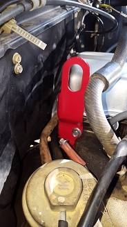

Also I painted the Lift point RED

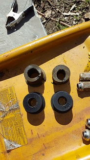

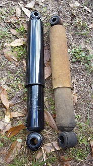

New vs. ols Shocks.
59917
New Leaf Spring Bushings
