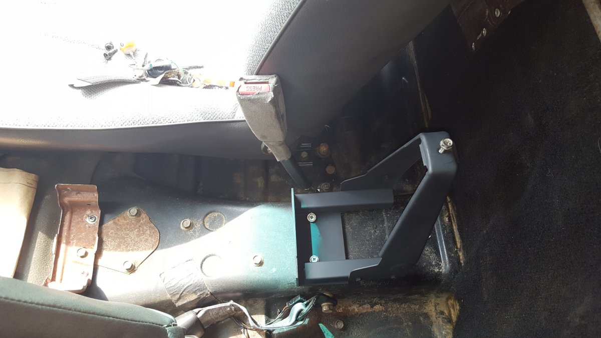

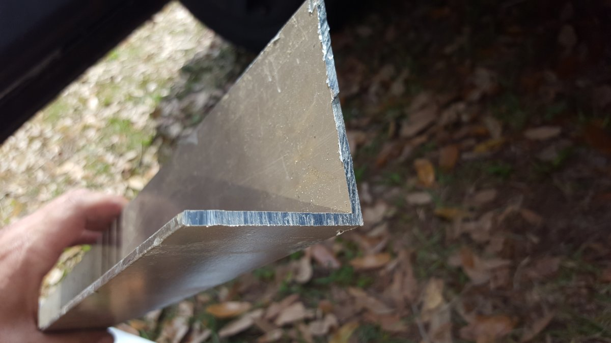

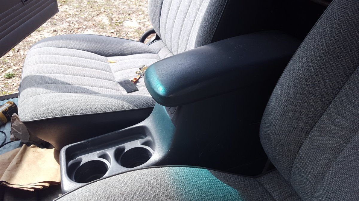

Didn't do the tie rod ends, waiting to get more parts. BUT, I did take out the explorer console that was in there and put in an actual Nissan console. It came out of a much newer truck and the rear bracket is supposed to attach to a small airbag computer that I do not have. So i had to fab up a bracket.
I started with a 4" piece of 2x3 aluminum angle
59920
And two 5" pieces of 1" aluminum square tube
59921
59922
Finished the home made bracket
And... Wha La
59923

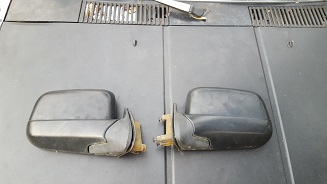

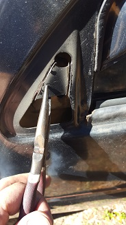

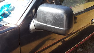

My Mirrors have always been a weak spot of the truck. The PS mirror had a huge round, convex, bubble type of thing bolted to it, and the DS mirror always tilted down when I shut the door.
59950

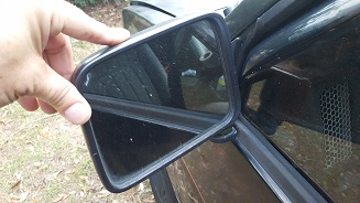

Not sure what year it was, I forgot to look. But what I did notice, was that the Xterra mirrors looked like they would fit my D21.
So I snatched one off the Xterra, and dry fit it to the HB in the yard, and WHA-LA, a match.
59951

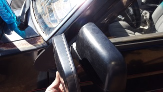

I dry fit them on my HB, and instantly noticed I had some cutting to do.
59952
59953
After everything had been mocked up and fit well, It was time for some protection on the fresh cuts, so a quick tape up, some sanding and primer before a shot of Gloss Black, Thankfully the mirrors covered up most of my work. lol
Just for comparisons sake. The Xterra mirrors are definitely beefier

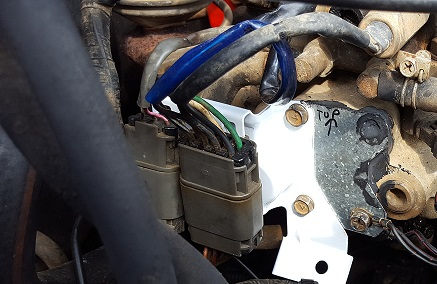

Well, With some extra time, I thought I would clean the engine up some more. I decided to remove a connection for hoses that I had previously just plugged, and make a plate from galvanized sheet metal. All thing were going well until I cross threaded a bolt and it snapped when I tried to back it out. FML
59957
My plan was to seal the hole with a bead of gasket maker around it. So that's what I did. But with the broken bolt in the hole, I couldn't get a good tight seal. I didn't want any air seepages, so I sealed the edges of the plate too. I decided to paint my bracket white while I had it off. IDK why, but I like it.
59958
Originally, each bolt on the right had a ground attached, so I just move the top on to the bottom. I hope that wont cause problems down the road.

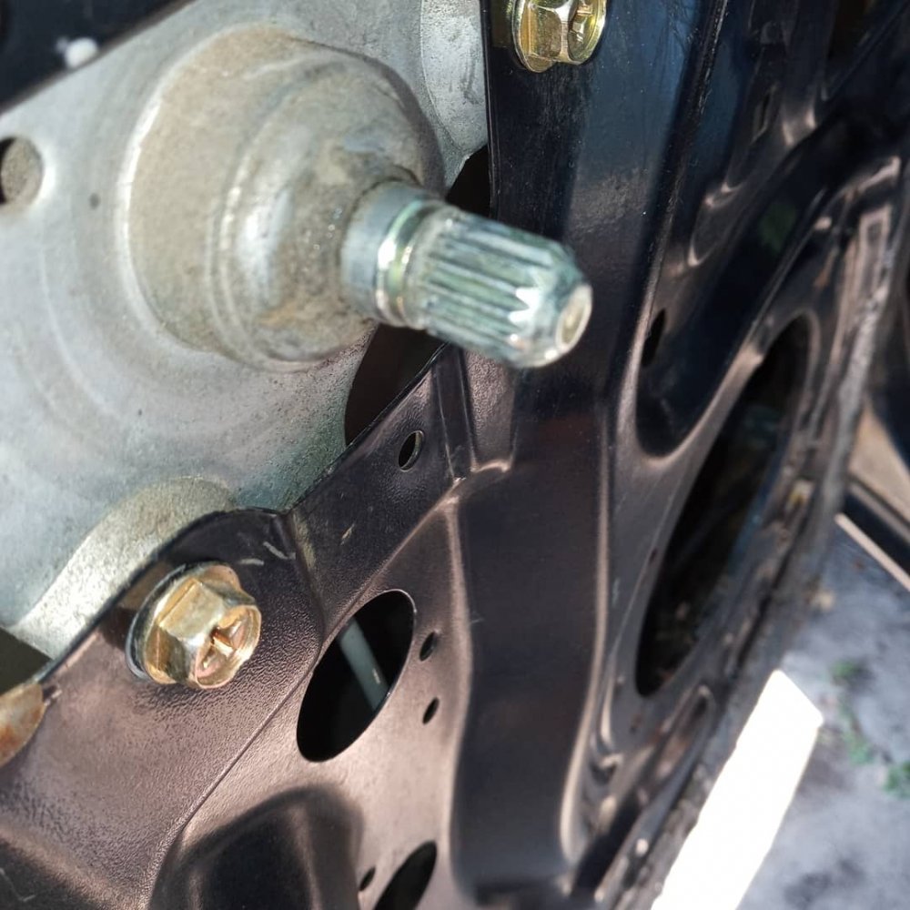

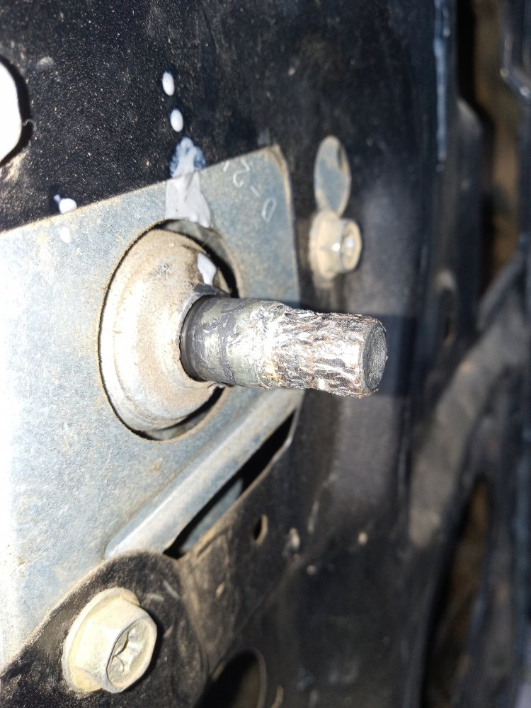

This is what years of vice grips for window cranks looks like.
So I replaced them
59974
