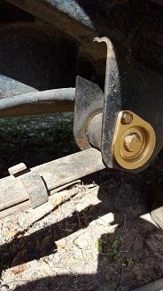

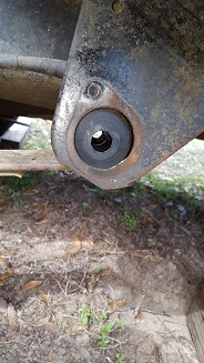

So I started with the Rears bushings., seemed like the right place to start to me. The old bushings came out fairly easy. And boy, were they ready to be changed out
60815

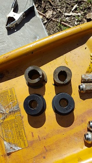

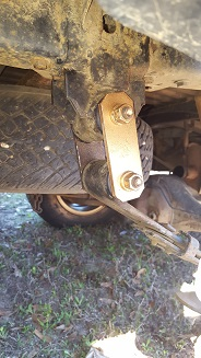

The bushings were stamped with part #'s, 9921,9922, & 9923. The 9921's were larger and obviously for the front, but the 9922's and 9923's seemed to be the same size, but I tried to keep like with like, and put the 9922's on the bottom, and 9923's on top. The tops slid right in with little force applied. The bottoms were a little more difficult. I eventually used a large C-clamp to squeeze the shackle through the bushings.
60816
60817
60818
60819
Old vs New

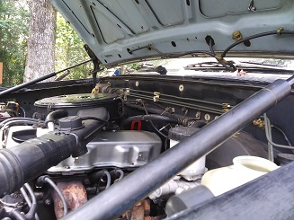

Adding gas struts to the hood ;
After several mock-ups, I have it complete. 2 struts.
So Here is what I did.
I bolted these home made brackets under the fender lip using 1/4-20 bolts and nuts. I used a 5/16' drill bit to drill the holes.
60820
This is the lower bracket/Driver's side.
60821
On the Uppers, I put the rod inside the hood hinge.
60822
complete, no hood rod

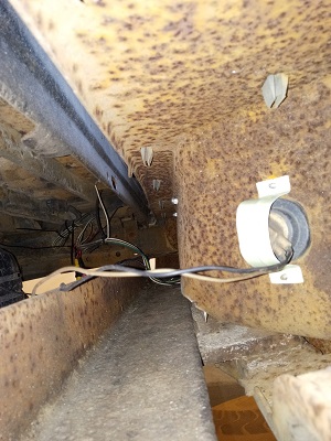

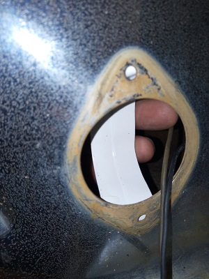

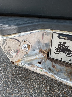

Fixed the license plate lights. fashioned some brackets from some old gutters

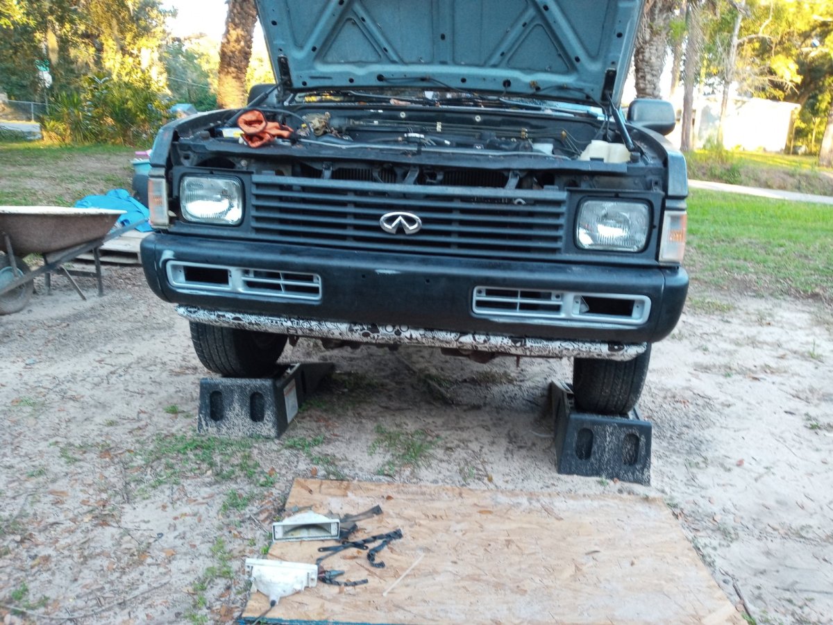

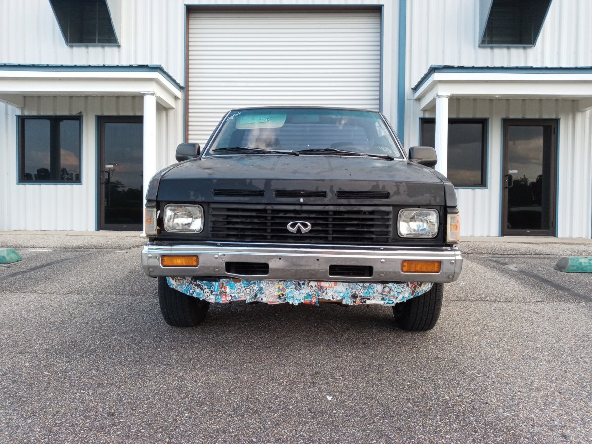

Did a front bumper and valance swap

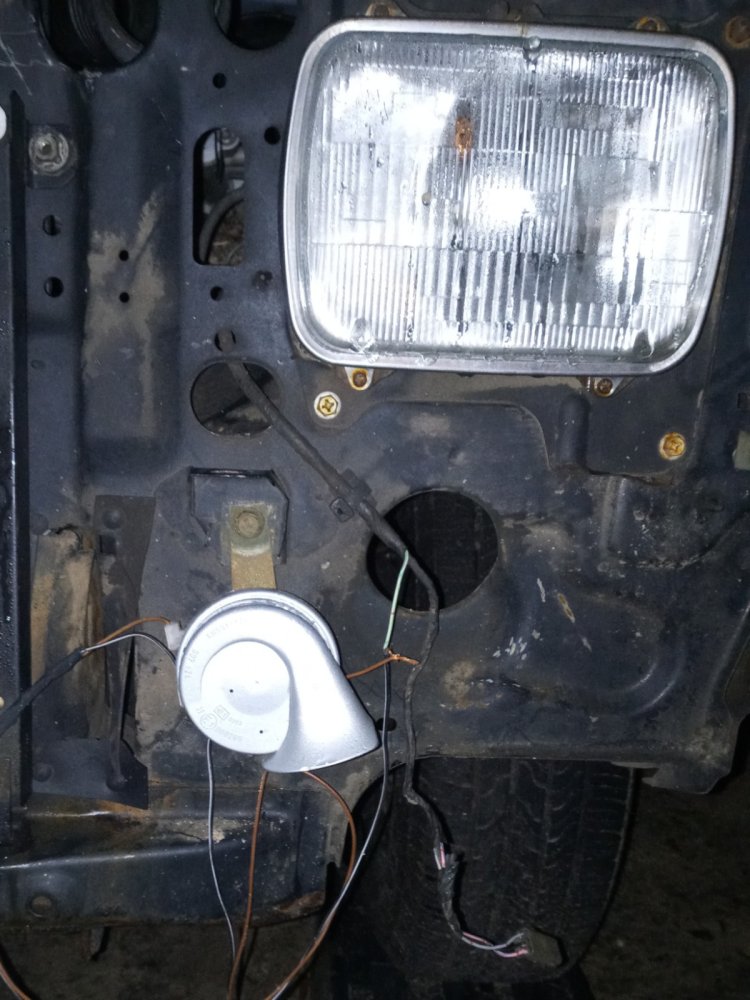

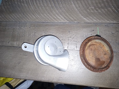

Replaced the old disc style horn with a Trumpet style from an old (Early 90's) Mercedes Benz 300 SE
This is where it went, but I relocated it under the hood, on the DS fender, where all the Emissions stuff used to live. (No pic yet )
