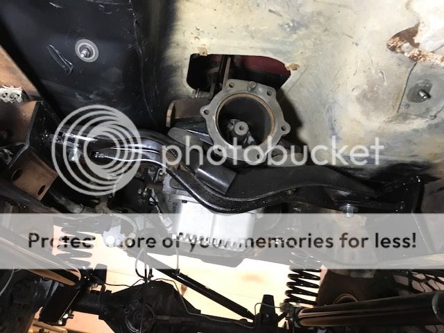

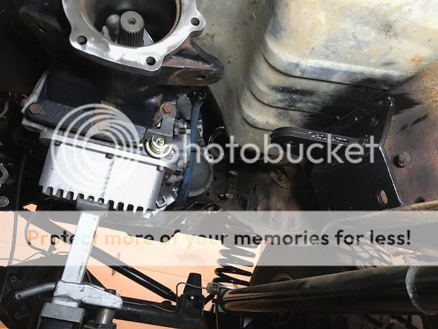

Slow weekend here. But, I got the trans lines plumbed to the cooler with -6 Pushlock hose and -6 AN fittings. I picked up a Lokar dipstick for the trans and made a little mount for it since its extra long.

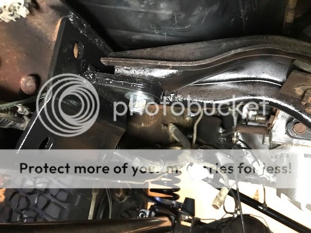

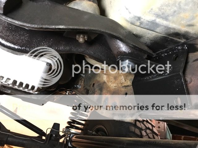

I cleaned up a stock Early Bronco trans crossmember and making mounts to the chassis was way easier than I thought it was going to be. I ended up setting the drive line angle pointing tail down -5*. I really couldn't get the tail up any higher,I was shooting for -3, since the tail housing was already getting close to touching the floor pan. I took some leftover brackets from my Duff kit that weren't used to make a small boxed section of the frame and welded some generic shock tabs to doubled up and welded together.

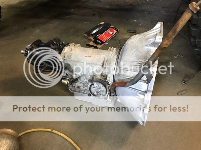

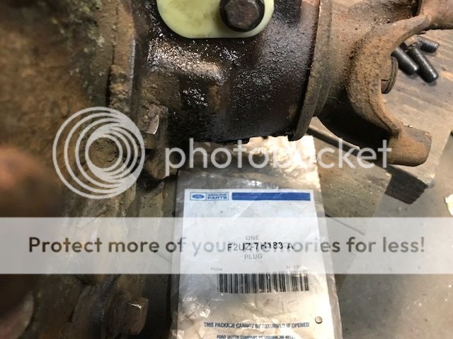

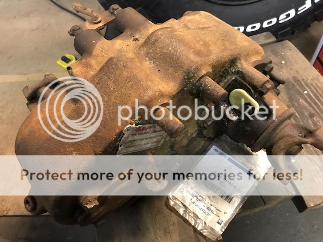

Fits like a glove and should be plenty strong.I also removed the speedo cable from the d20 and used a Ford plug to fill that hole since I'm using a GPS speedo.
So now I just need to figure out these 13 needle bearings that go in around the input shaft then I can stab the d20 in tomorrow.

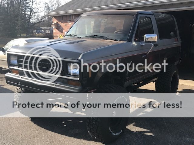

What did you use for the hood vents?
I don't see any issues. My last B2 had vents like these with no issues, my 83 TBird has open scoops with no issues but all these have a factory Ford rubber boot on the distributors

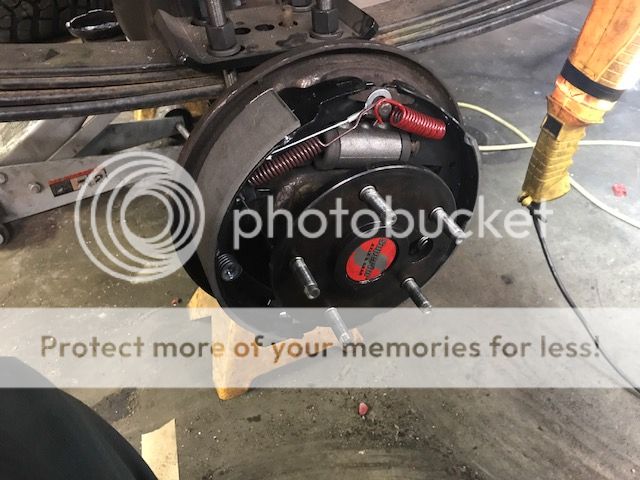

Had a good Sunday in the shop with a few buddies helping me out. We got everything reamed out and the Ruff Stuff 1 ton steering on and everything fits and clears good. Finally dug out the box of new rear brake parts Ive been sitting on for about a month and found out nothing fits! Turns out somebody had swapped out the 11" narrow drum brakes {1.75" shoes} for full size f150 11" drum brakes {2.25" shoes} so I had to run and exchange all my parts and thankfully everything was on the shelf.

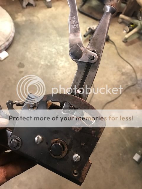

I also took apart my B&M Pro stick to modify the shift gate. I removed the reverse lock out and made it so I can shift from any forward gear to reverse in one movement and same going the other way. Only park is locked out.

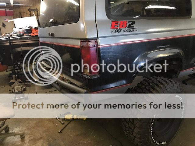

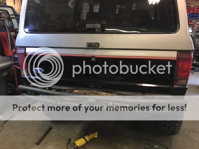

I then bolted up the James Duff rear bumper and started thinkin about the tire carrier.

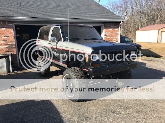

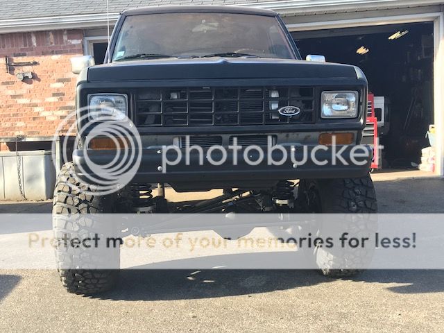

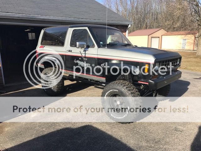

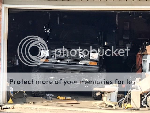

At the end of the day I rolled it outside for the first time so I could do a little floor clean up inside and took some poser shots. Man I love how its looking!
Looks great!
Perfect stance and height.
