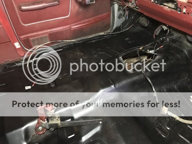

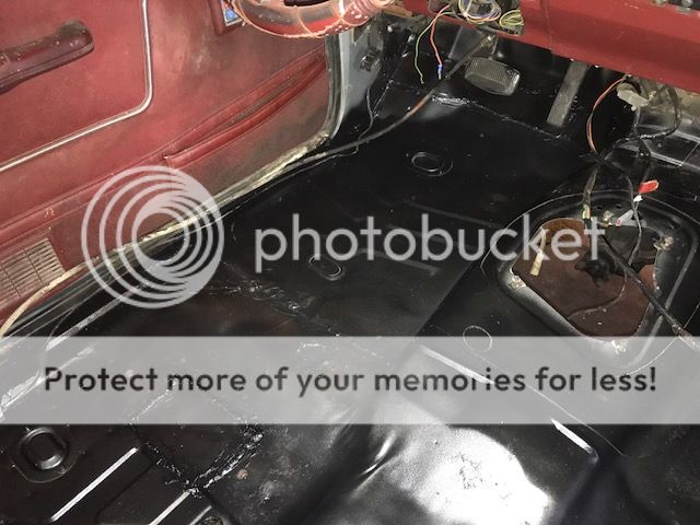

Floors are all sealed and coated inside and out. Very happy how it turned out and should last a long time now.

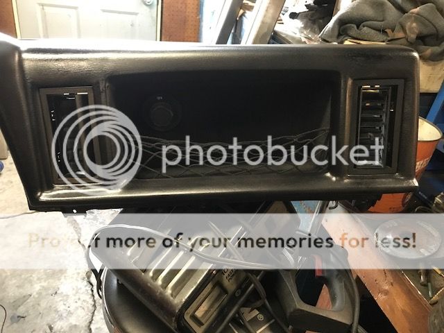

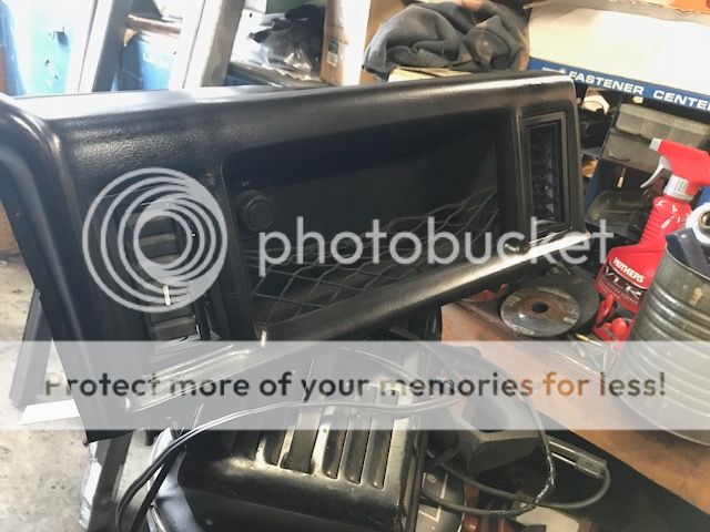

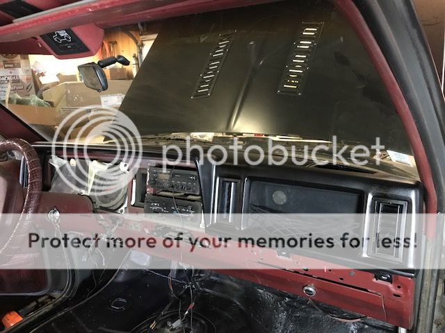

Ready to test fit seats now. I also pulled a mint black dash pad out of my parts truck in backyard and replaced the busted up red one. Then I removed the passenger side cubby and used some cargo netting to make that space actually useable.

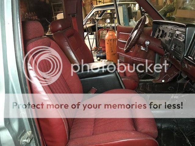

Today I dug out the 60/40 bench I pulled out of a 88 Ranger extended cab and pulled the seat track off. I have read that Ranger and Bronco2 seat tracks were not interchangeable but in fact these are. I am using 90s Mustang buckets and I pulled the tracks off and swapped the outside hinge mechanism so the Mustang seat still operated like the Bronco seats do when you flip it forward and slide it to the dash. I also removed the inside hinge bolt and used a Tbird seat belt latch that bolts to that location. This gets rid of the Bronco style inside seat belt latch that moves on that little slider track. Now I can use stock seat belts for street driving and I can use the torx bolts in floor to attach some old lap belt harnesses for off roading. I also test fit the new gauge panel which I fricken love. Speedhut just shipped out my tach yesterday so Ill be able to finish the dash soon.

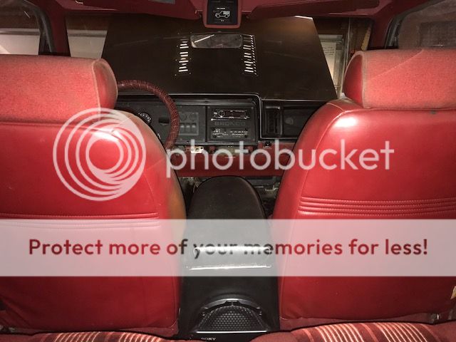

Good day. Both seats are bolted in for good now,threw the console in then climbed in and tried it on for size. Love the way it feels, fit like a glove.

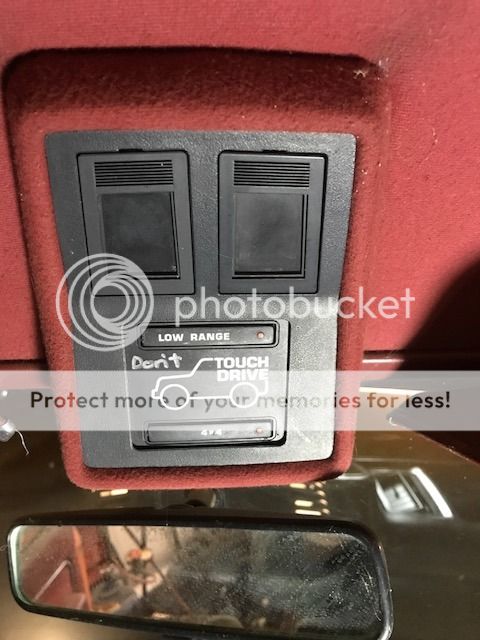

I also modified the stock tcase push button shifter to work with my D20

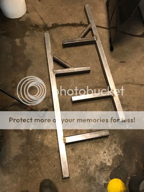

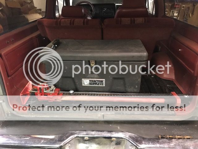

Threw in my storage box full of straps and such then welded some nuts to the floor pan to mount the jack.

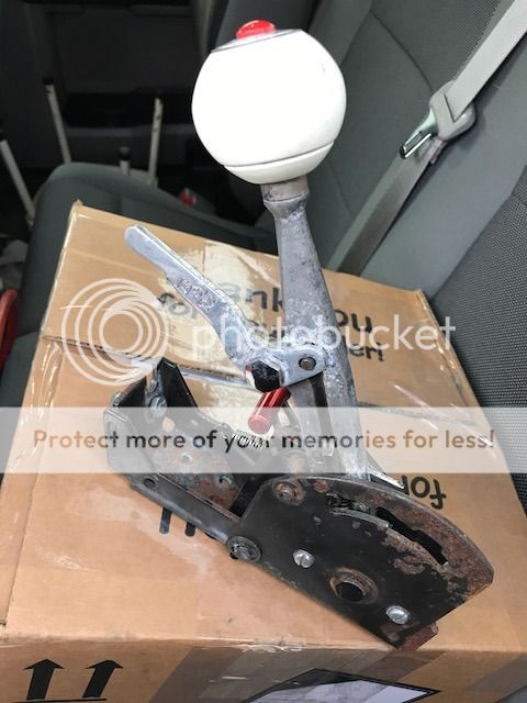

I grabbed a B&M shifter from a friend and Ill modify the shift gate for better use off road.

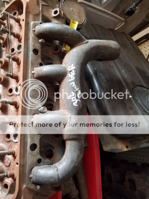

I also scored a set of old but perfect Advance Adapters v8 swap headers! Im welding V-Bands on for collectors

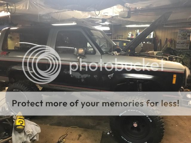

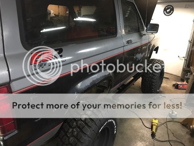

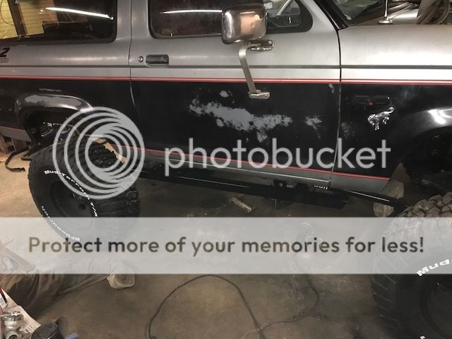

Forgot to add some pix from when I built the rock siders and the first pix of it on all fours

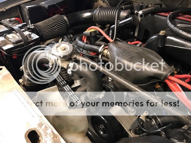

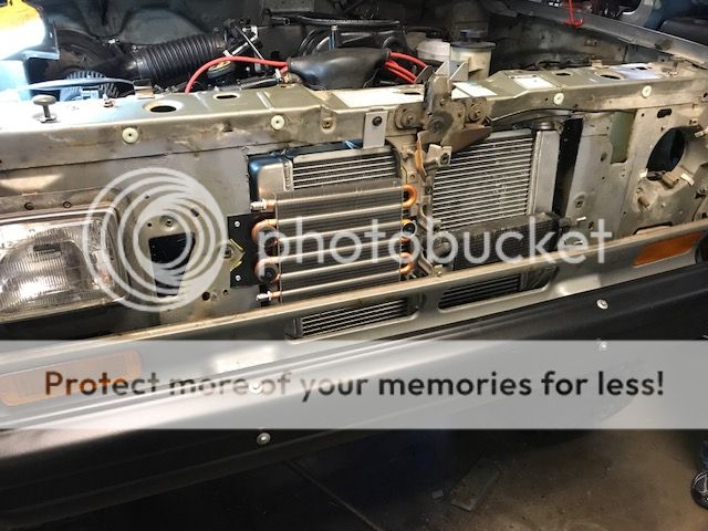

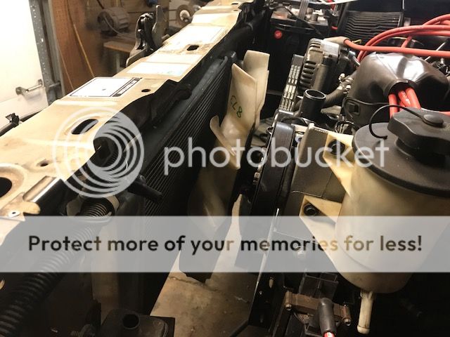

I now have the radiator mounted for good and the powersteering and trans coolers are on
The fan is on and I made up the hoses.
I also got the headers on,picked up a cover for the B&M shifter and to save me some time I dropped the c4 off at a local shop to just get it done. Guy only wanted $200 labor to rebuild it with all the parts I had bought so it was worth it to me since it will save me at least a weeks worth of work. Ill have the trans back on sunday.
