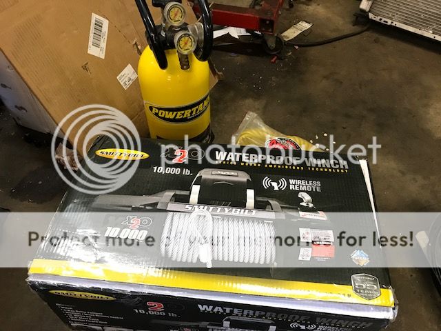

I got my rear bumper drilled for the spindle so now I can build my tire carrier. I also picked up a new X20 Smitybilt 10k lb winch and a 10lb Powertank setup

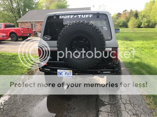

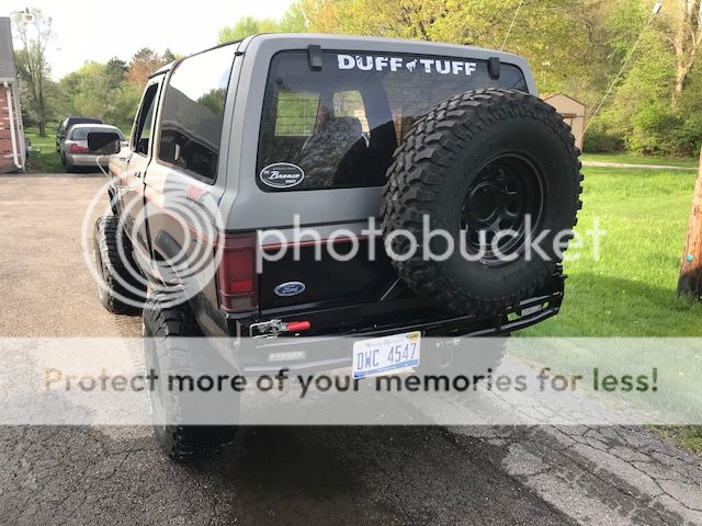

I built a swing out tire carrier on the James Duff rear bumper and it turned out awesome. I bought the parts from EMS OffRoad and have less than $200 in all the parts and materials.
Drilled a hole thru both tubes of the bumper then welded the spindle in good.
Here is a vid of the build.
https://www.youtube.com/watch?v=AeUduk2cp04
And finished.

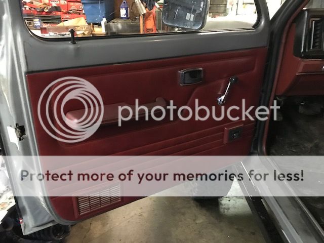

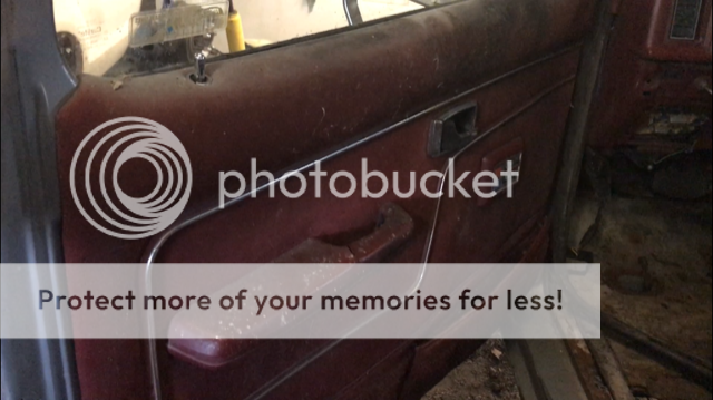

I also finally got around to gutting the doors and swapped in the full size glass and manual regulators. Put all new dew wipes and felts in too. Turned out great!

may want to consider plating/gusset the bumper now, though with low use and where the frame bracket is it may never sag.
i bent up my duff radius arms and had to repair them quite a bit when i had ttb....so....of course that was a looong time ago..
Bumper SEEMS pretty solid as its now but I guess time will tell. When its closed the weight of the tire is right over the frame mount and driving down the road even big bumps in the road hardly even make the spare shake. Feeling pretty good about it so far.
I had the same Duff TTB arms on my last B2 and I also banged those up a good bit but these EB radius arms are a different animal. If I bend these .250 wall DOM 2" arms I really had a bad day!

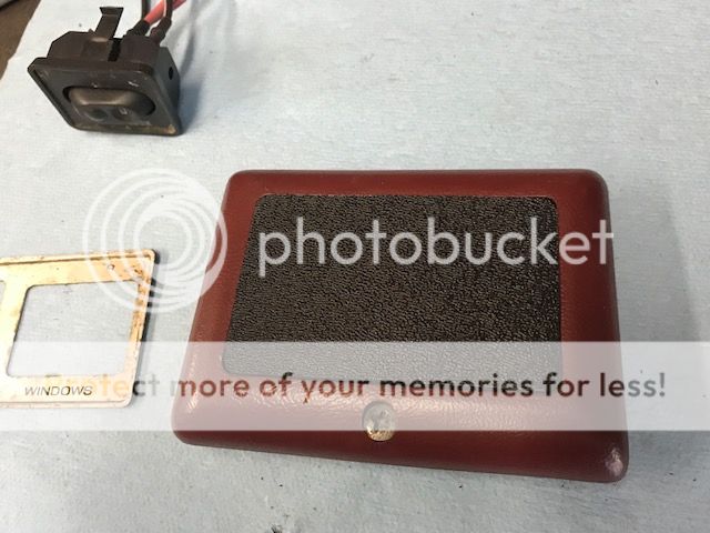

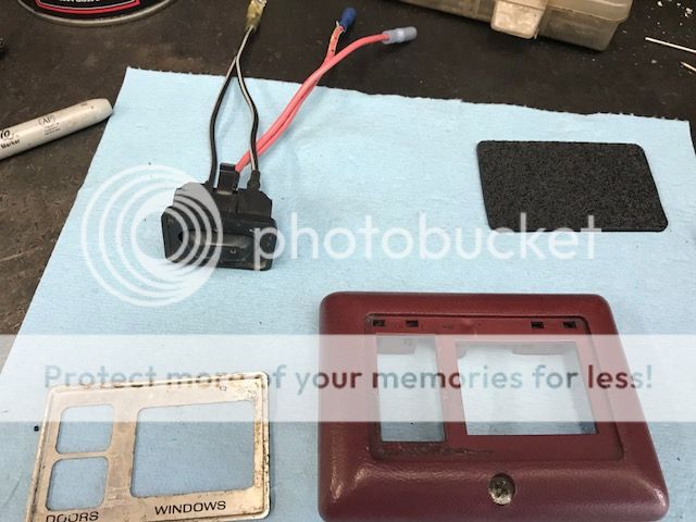

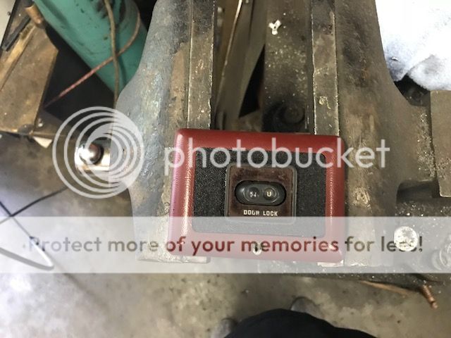

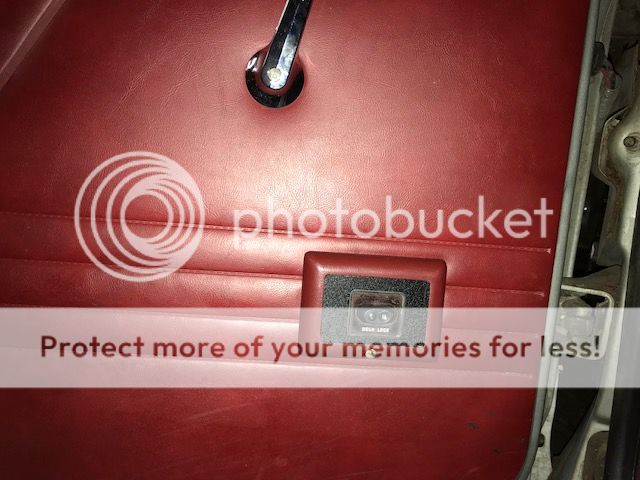

So I took the factory window switch plate thingy and changed it up to hold just one mustang door lock switch. Turned out great! Cant believe the difference the new door panels made for the interior.
Coming from the original cat hair and piss covered panels to the new stuff is amazing.
great detail on the door panel. :icon_thumby:

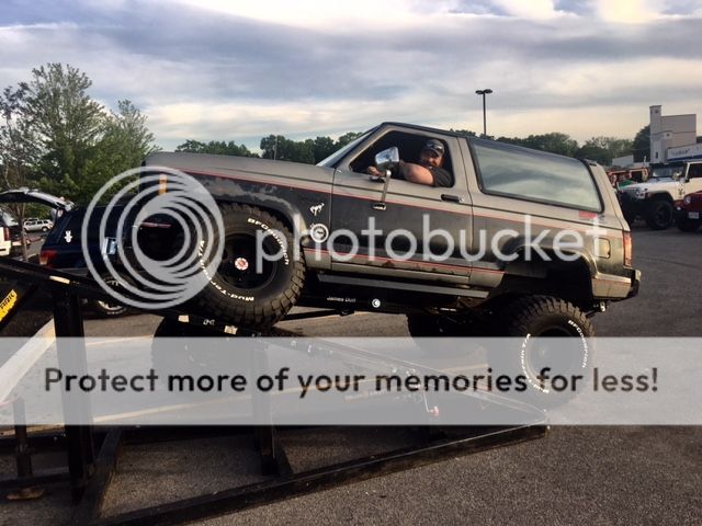

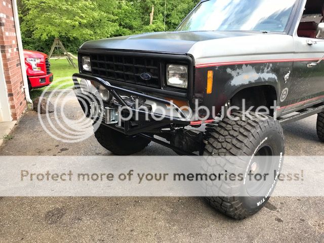

I did some cutting on the fenders and took it back to our clubs RTI ramp to check clearance and she all good now. I am super happy with the flex this thing has!

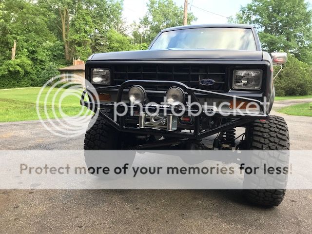

I also finished the front bumper and Im real happy with it.
