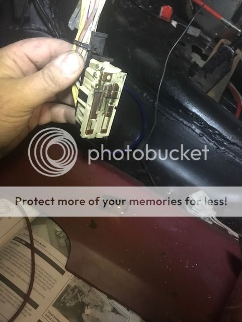

I couldnt get truck to start yet because the ecm is dropping its 12v signal during cranking. I went over my wiring and I couldnt find a single wire anywhere in the chassis harness that still had 12v while cranking. So I decided to start checking wiring in the steering column and when I pulled the shroud off the whole ignition switch fell off with plug still on. Hoping this is my issue.
I swapped in a different column I had but havent had a chance to retest yet.

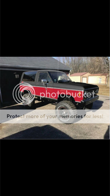

Just playing around talking with buddies we came up with a photoshop pic of what I think might be the new idea for the final paint job. I have enough red paint left over from my Tbird that we could make this happen for pennys.

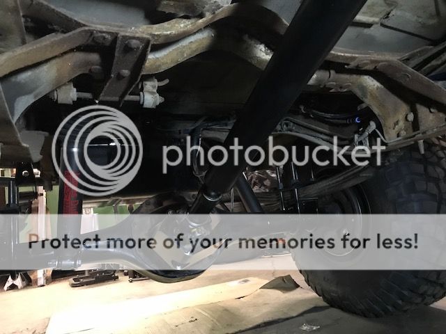

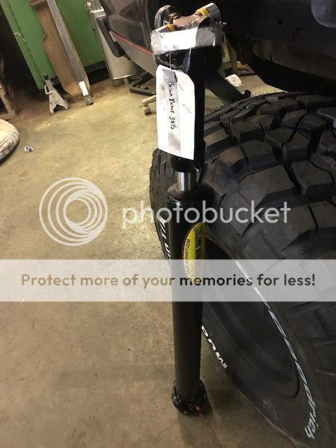

My front drive shaft is a stock 75 Bronco double cardon front shaft but its almost in a bind just sitting still at ride height. There is no way it will work once that front end starts flexing. Now I already have a Aussie Locker to put in it but I was either going to buy some chromoly shafts for it or try to trade off a set of full width RCV shafts I have in my 83 Ranger truggy for some EB d44 length RCV shafts. No luck with that so far. So now Im looking at the possibility of maybe cutting the knuckles off this EB axle to change the pinion angle and the caster to make it work.
But I still have my truggy out back with the full width d44 high pinion with the same gearing as the EB axle and it has the RCV shafts. It has all new disc brakes, ball joints {EB axle still on drums} and I dont think I will be using it now since I really would rather put tons under that truck. So now Im thinking is it worth cutting down the passenger side housing the 6" to make that one fit under the B2 and then just see if I can cut and respline the one RCV shaft to make it all work. Then Ill have disc brakes,best shafts and hoefully the high pinion will fix my front shaft angle issue.......
Well I spent all day Sunday in the shop and its now ALIVE! Nothing like that feeling when a new motor fires up for the first time. Turns out all my wiring I did was good and correct but the broken ignition switch was the problem. Plugged all the wiring in on the column and it fired right up first crank. After a big sigh of relief I moved on to other stuff.

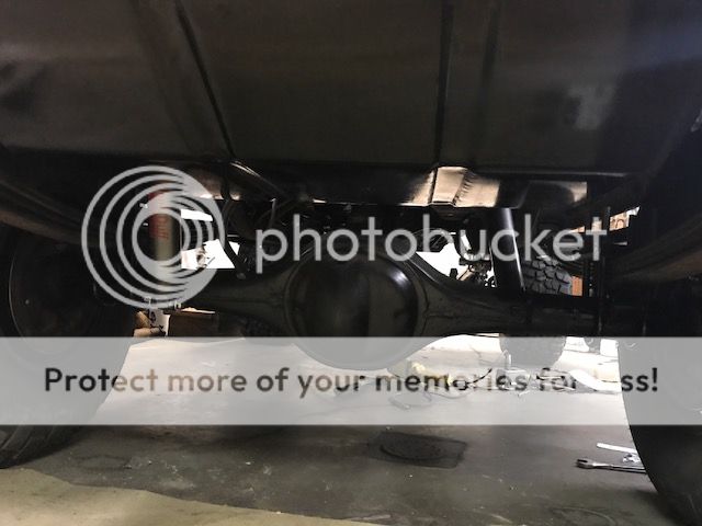

I got the pinion angle set and welded up the perches, welded on some shock tabs and mounted up the Duff shocks finally.
So I just need to bend up a brake line across the housing and the rear is finished.

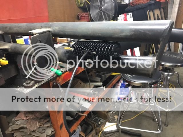

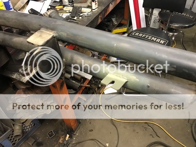

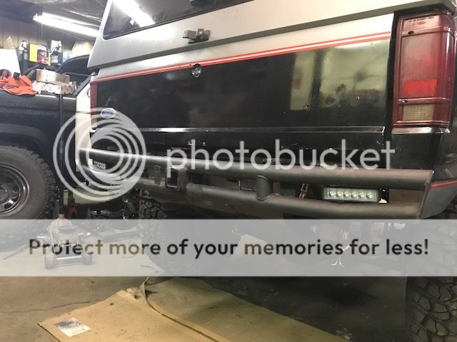

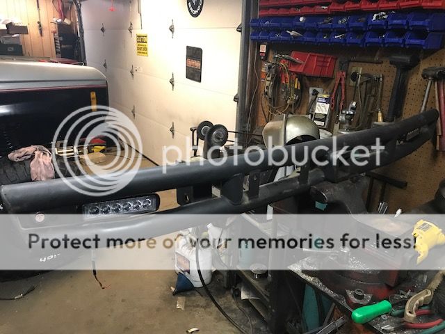

Then just to check off an easy one off my list I welded up some tabs on the rear Duff bumper and mounted up the LED backup lights I had.

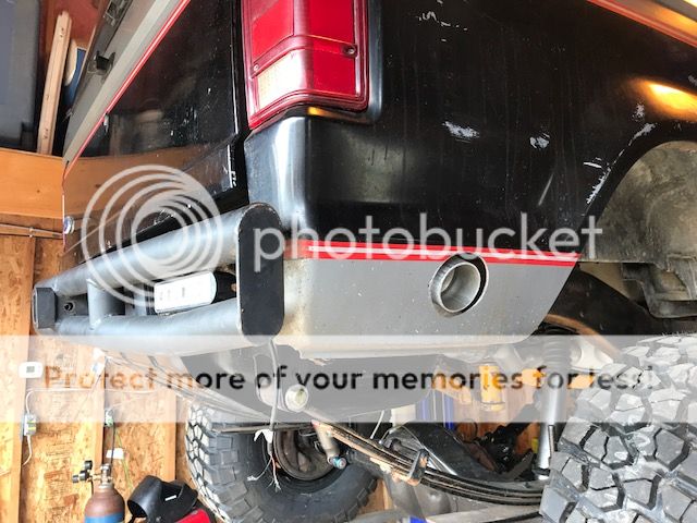

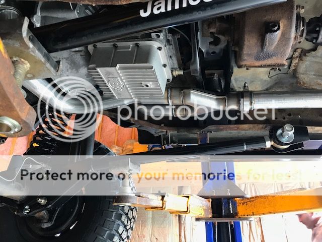

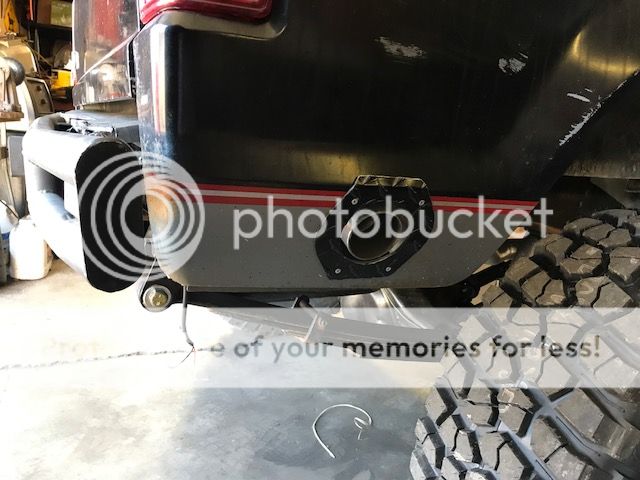

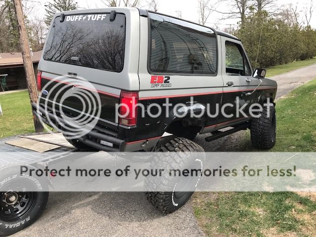

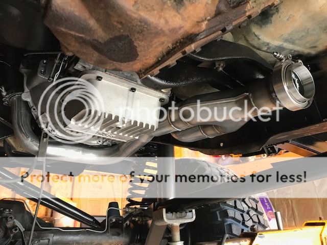

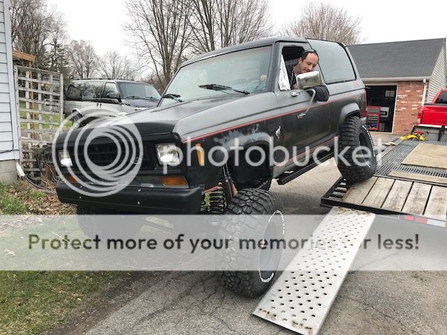

Got the exhaust done over the weekend and it turned out perfect! Truck is as quiet as a brand new truck. We did a 2.5" Y-pipe with V-bands at all 3 ends, used a 2.5" Dynomax muffler with a fender exit tailpipe.

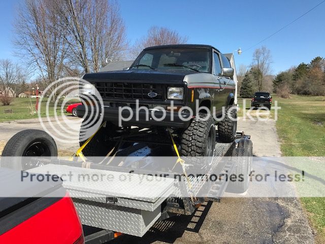

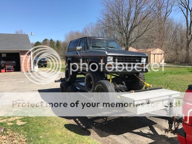

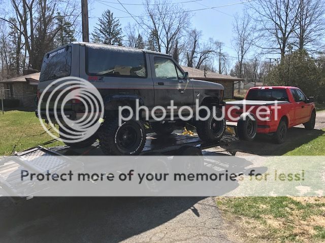

Then when I got home we flexed it out on the trailer for the first time so I could check fender clearance,shock lengths and brake lines. So far everything clears,fits and no rubs.

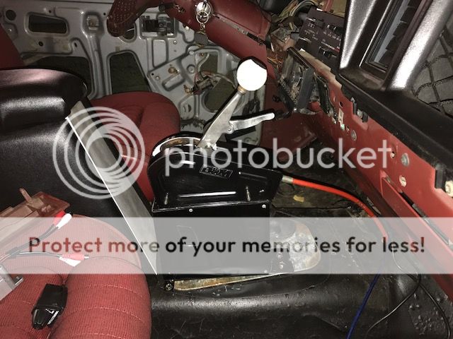

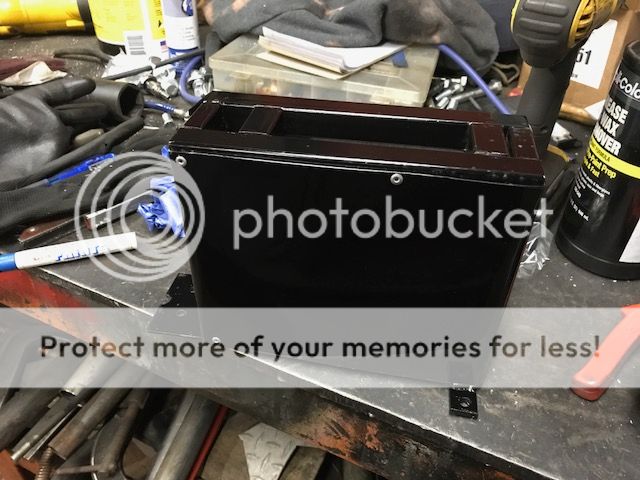

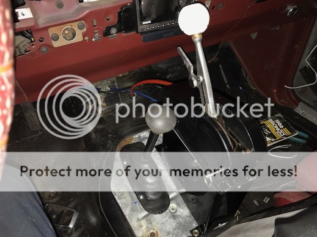

Then I sealed up the floor, put on the t-case shifter boot and built a little square tube stand wrapped in aluminum to mount the trans shifter to. Im real happy how it turned out. Its positioned perfect to be strapped in seat and works with the center console.
