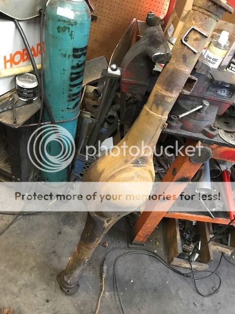

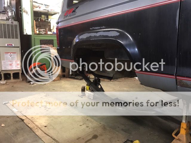

After a couple days of cutting and torching I got all the rear suspension out of the truck and the Skyjacker Softride leafs with Belltech shackles are in. I cut off the shock mounts and perches off the 9" and right now its hanging up letting the fresh chassis black paint dry.

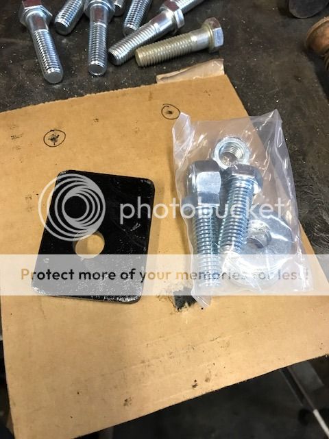

I also made a discovery. I mentioned above that when I installed the drivers side coil bucket and track bar mount I needed to add a spacer and longer bolts because it looked like Duff hadnt thought about these parts being used together. Well when I was digging through my pile of parts from Ballistic I found one small random bag and when I opened it I found some parts obviously from my Duff pile.
So I want to stand corrected

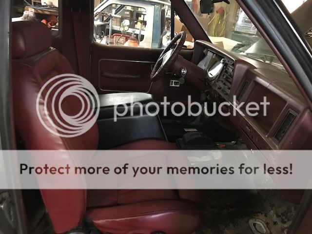

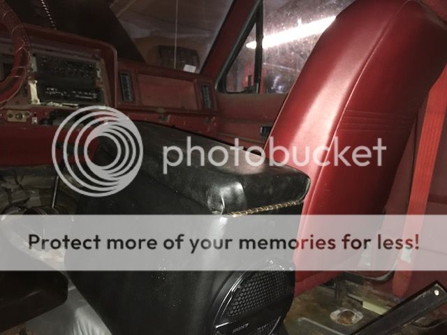

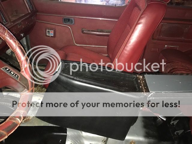

I also dug out the mustang seats and a center console I have been sitting on for a while that was made for a different project that didnt work out. Looks like it should work nicely in this truck.

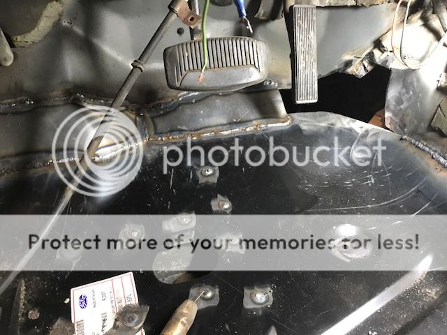

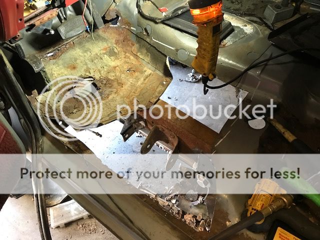

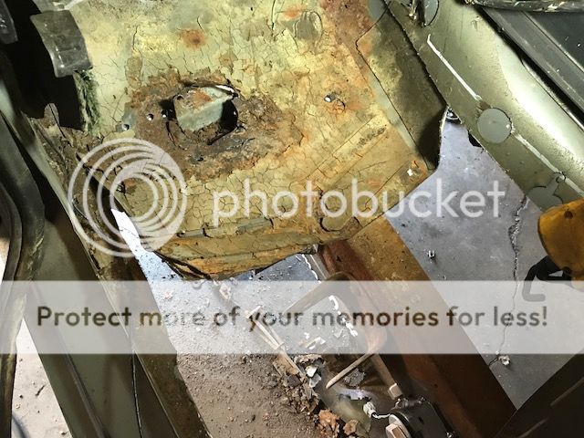

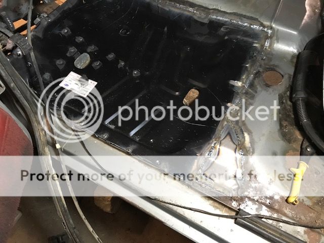

Slow progress but I have the driver side floor patched up now. Drilled out the spot welds in the braces on the bottom side of the floor pan and removed all of the pinch weld from the tunnel to the A pillar. The new pan didn't cover all my bad spots so I had to hand make a few pieces to get it all.
Just waiting on my order from Eastwood with the seam sealer now

I'm no structural engineer but it sure looked like the inner rockers and the leg for the body mount were galvanized because they were completely clean and spotless yet everything spot welded to them was rotted.

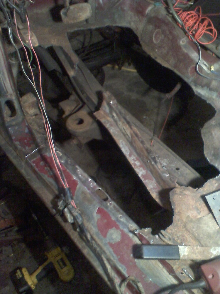

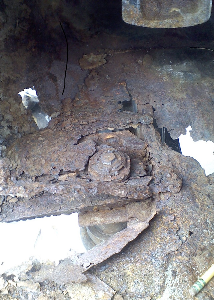

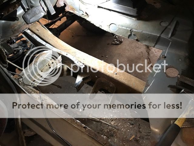

this is what my floor looked like after it crushed down...I did have the front wheels off the ice/lake/ground though:D it went from...man that floor is getting ugly to the cab falling down noticably pretty quick...I thought I had more pics...but this was quite a while ago...different puter...and I am not to good at taking pics...so I really appreciate your efforts to take the time to do this sort of thread...its definitely a bit of extra work to record these things.
I cleaned rear part of my cab out the rest of the way today and looked close at it... its bad. :shok:
I am leaving for work soon so I wont be fixing it till summer...its worse then I thought. but I would drive it to florida right now....just have to throw some felt and matting in there to keep the breeze down:icon_rofl: but I cant do any serious wheeling in it...I think Wellsville knocked all the rust free back there last summer...

Wow........That's horrible. Its to bad nobody makes a full size floor pan for these trucks because I bet there is a small market for them.
