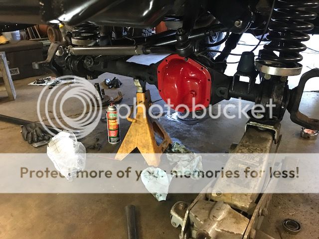

So I finally got around to getting the front axle upgraded.

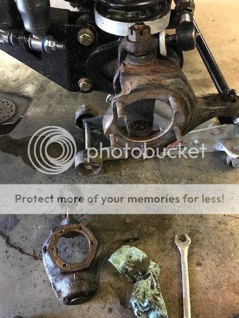

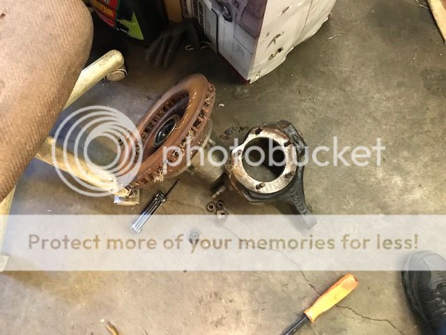

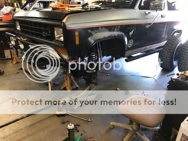

I pulled the knuckles,brakes and RCV shafts from my full width d44 in my truggy.
Then I gutted the Bronco axle and started swapping parts.

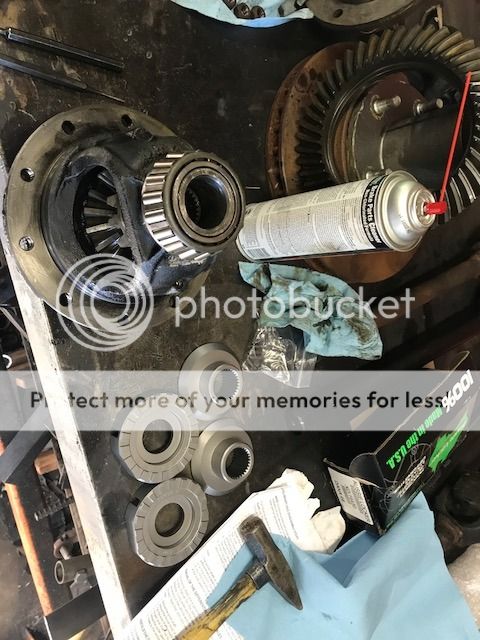

And I threw the Aussie locker in.

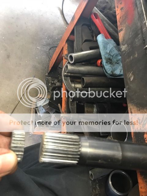

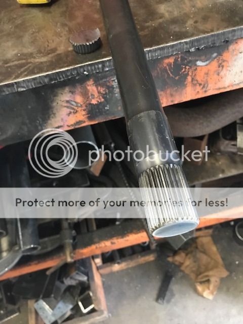

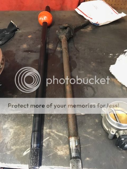

I bought a new shorter EB d44 passenger inner shaft from RCV and the driver side I cut .600 off the end.

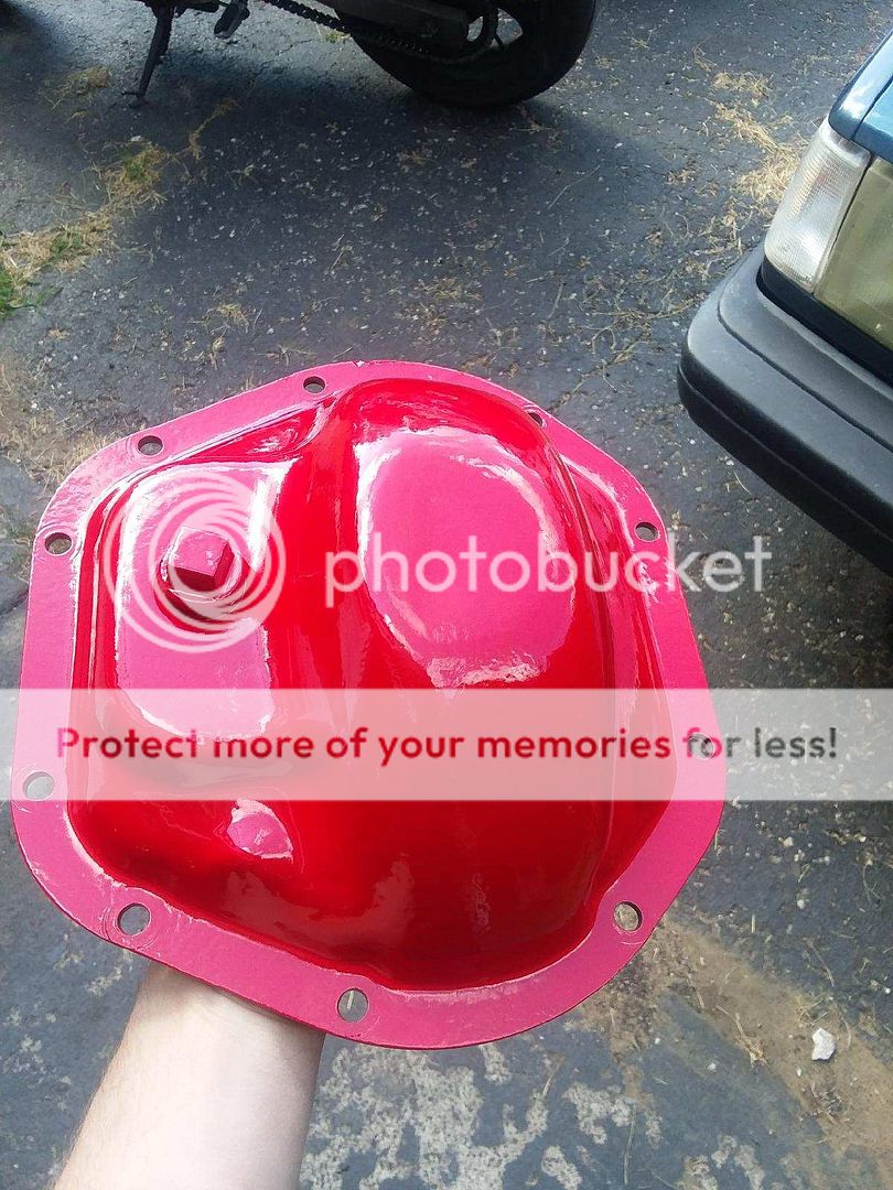

I bought a new set of Warn Premium hubs and the RCV 30 spline adapter gears. I had the diff cover powder coated and threw it all back together.

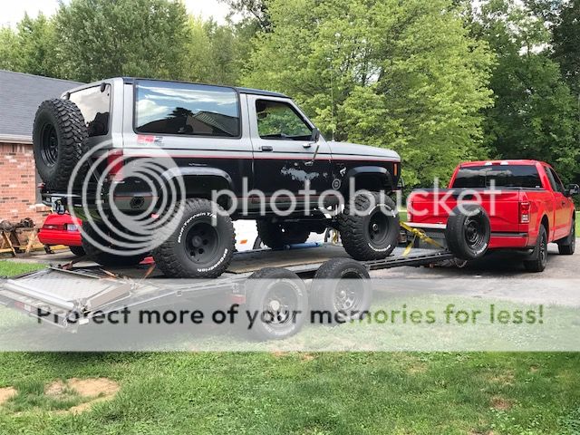

So truck was all set at this point and I loaded it up for Silver Lake Bronco Takeover.
