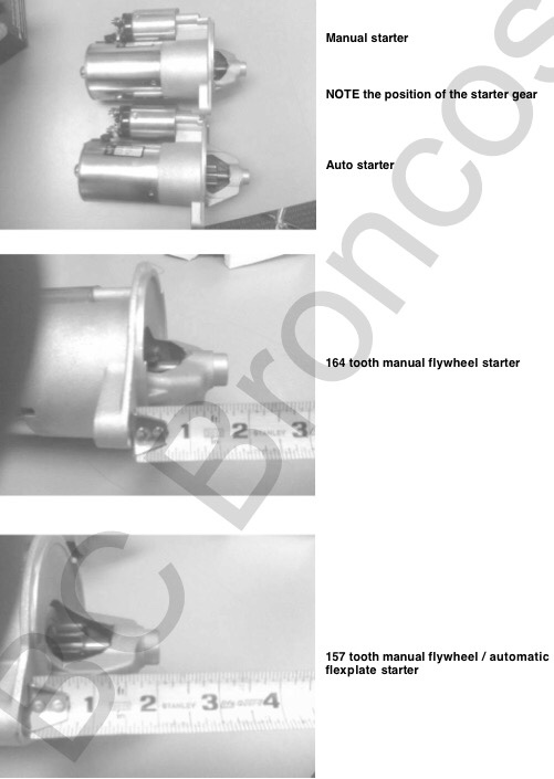

You can see the page I got this from in the picture

I did not mod the holes on the bell housing. just the holes on the starter. I do have the correct starter according to every parts store I go to. they continue to tell me that the fm145 trans auto and man trans were the same starter... which I don't believe... but I cant find any other starter.
and now that I said all that I did find a starter that has a shorter cone than the other one. I put it in and it wont even touch the flywheel... but the gear didn't seem to sit inside the housing like the pics show... anyone have a NAPA, Auto Zone, or Advanced auto part number for the correct starter?
