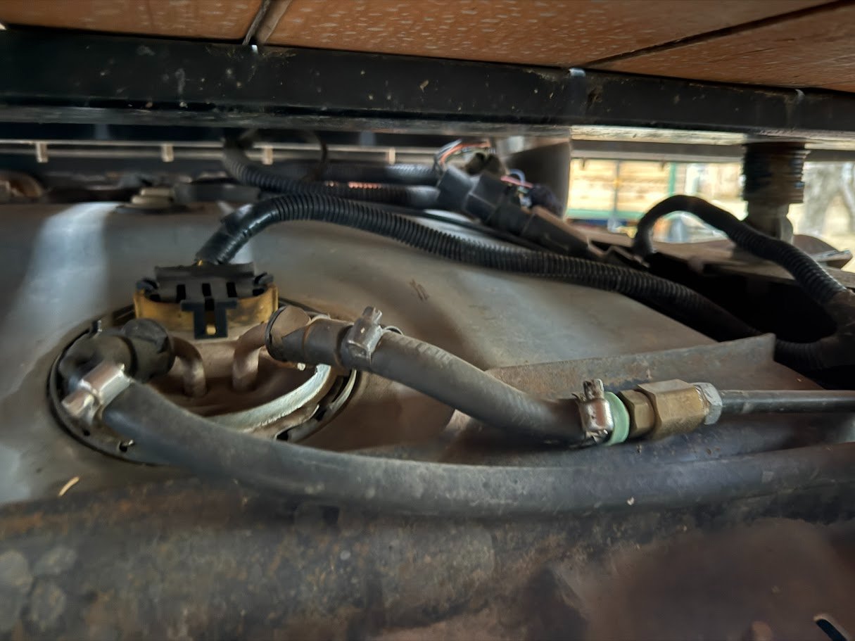

This is what I did for the fuel line when I did the pump conversion. Steel brake line between the filter and the tank, then just a short piece of high pressure rubber hose with a barb fitting on one end and the normal plastic connector on the other. If you slit the factory nylon line just a bit with a razor blade, you can pull the fittings right out and use them with rubber.
Return line is still all rubber, I will fix that eventually but it doesn't hold any pressure so it's been a low priority.

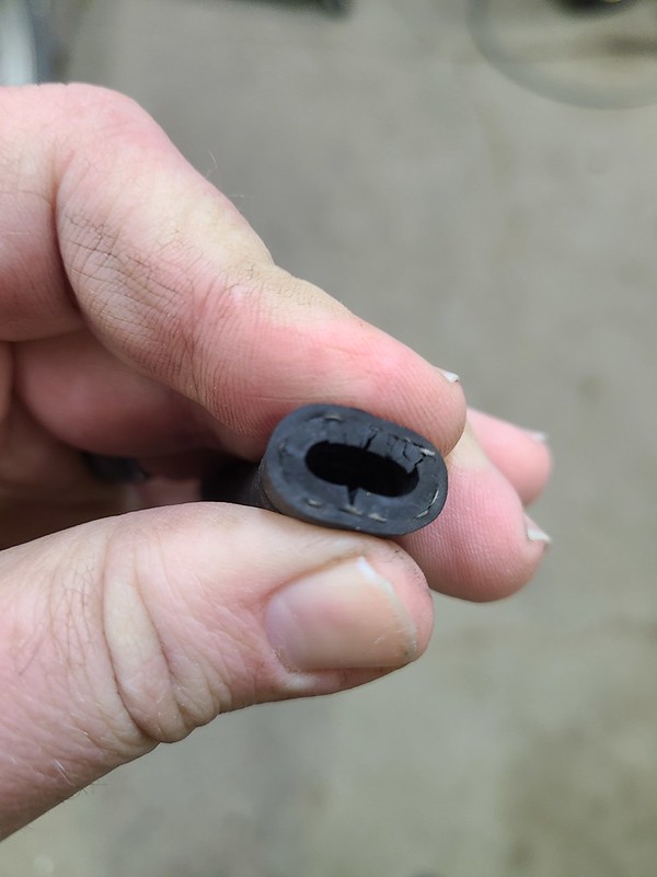

The stuff I was looking at was braided and has the liner. I don't plan on E85 but it seems the regular rubber fuel line likes to crack internally. I've never been around the EFI rubber hose...
