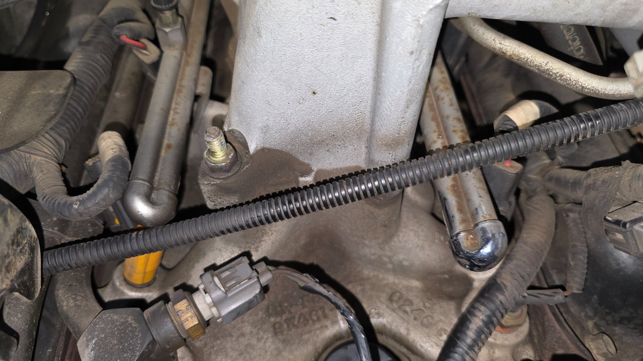

So, my 5.0l might have a return style system. While doing the cam synchronizer this morning, I looked at the fuel rail. It comes up along each row of injectors and doubles back. I can't see the back of the engune where the regulator and supplt line is. It's tight and crowded back there. So I don't really know for sure yet. I know my 3.0l just has a single tube going around to all the injectors.

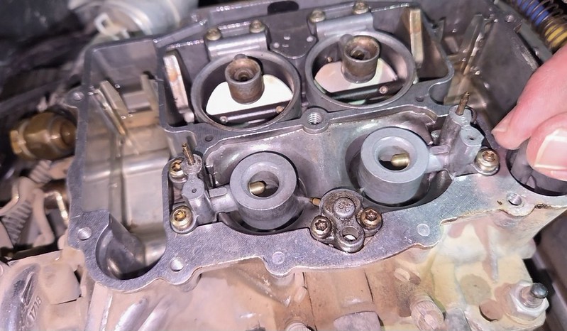

Starting issues persist. I have noticed it helps if I pump the pedal like a old Quadrajet. Accelerator pump is pretty inconsistent at startup.
Ran the fuel pump and popped the top off the carb. And the accelerator pump well is basically dry.

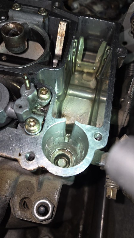

Using the old accelerator pump I could move no fuel. But I looking at things I noticed a big chunk of flash across the channel that feeds the accelerator pump.
'85 Ranger Restomod
So I grabbed that and ripped it off with my leatherman

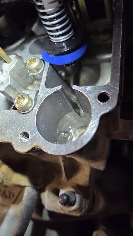

I didn't torque it down but I set the top back on it and turned the fuel pump on again... and we have fuel in the well.
'85 Ranger Restomod
And we have squirtage!
'85 Ranger Restomod
I stuck the spring back in the pump, set the air horn back on and cinched it in place and rechecked and it still worked.

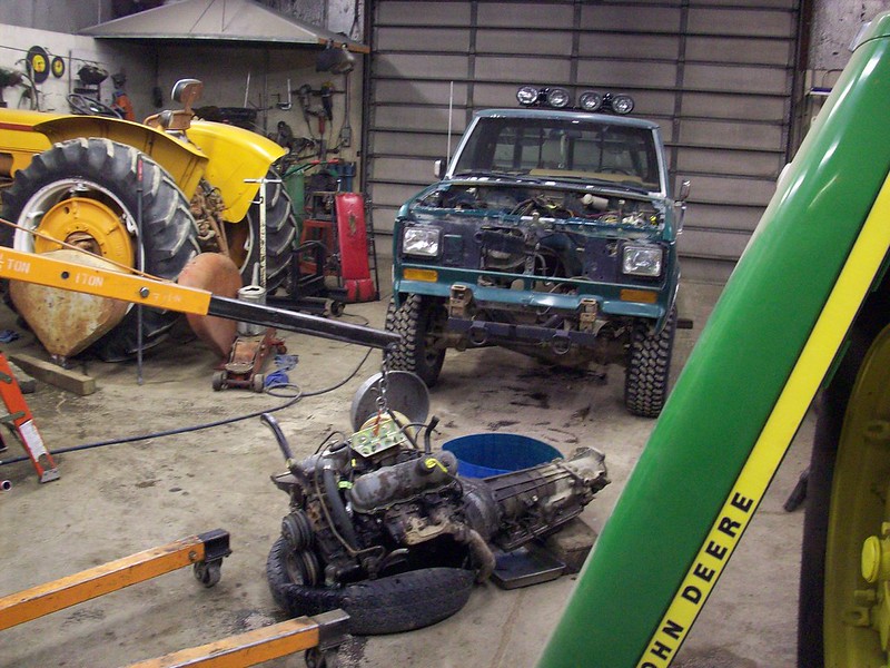

Its really crazy to think...15 years ago today I pulled the 2.8 out of this thing.
Its come a long ways... and still has a long ways to go.
