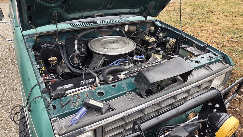

I went to start it today... same crap. Would not say a word. I have perfect spark, choke seemed to be working but nothing.
'85 Ranger Restomod
As I was playing with the choke even with the fuel pump running the accelerator pump was not doing accelerator pump things.
I even disgraced it by having my wife pull start it with her Bronco. It wasn't happy but did light off.

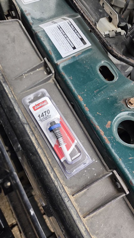

So I threw another $22 at it and snagged a new accelerator pump for it.
'85 Ranger Restomod

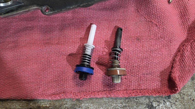

The old one had a pivot type thing going on, I tried it again before I pulled it apart. The old one did nothng. New one sprayed like the old one used to.
'85 Ranger Restomod
Was this my issue all along? Who knows. I would like to kick it so I can say I did win though. Plus I can have a working carb to try to resell.

Broke the door loose pumped the pedal once and twisted the key.
It did its historically usual very vast start and idled perfect. Like starts as soon as the starter touches the flywheel.
At this point it is probably yet another false fix but hey, I will take what I can for now.
I don't know why the old one would do that pivot action, I wonder if that is why it would sometimes work but sometimes not.
It has been running good all week, noticeable difference when I lay into it while driving now lol.

Last night it was actually kinda warm (36* when I came in at 11pm), I dragged the laptop to the garage and updated the schematic right there as I went through it, the keyed fuse block and its connector pinouts are done. The battery power relay block has all the functioning relays on it and is a lot more complex... I was getting tired so I didn't get into that one.

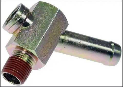

If you need to add a coolant temp sensor, check into a Dorman 47993 heater hose fitting - screws into your lower intake and gives you an extra bung for the sensor. Also gets your heater hose at a good angle.

That fitting will be awesome, since the EFI will control my fans I don't need to use that sender anymore... but it has bugged me forever the factory gauge in the dash doesn't work because I have nowhere to put a sender.
