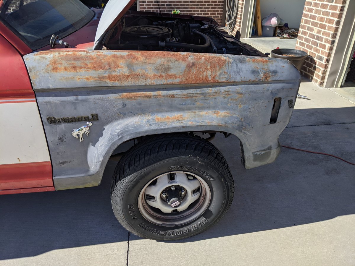

Also I picked up a junk yard passenger fender today for $50, it has some surface rust, but it's solid. A couple of dings, but I got it pretty straight.
I also found a snorkel for the intake for the air cleaner. My was rotted out, but luckily I've got a yard with an 85 still in it with the same exact drivetrain.
I also tried my best attempt at the stud welder from harbor freight. It actually works pretty well. I pulled my worst dent from behind the driver's door.

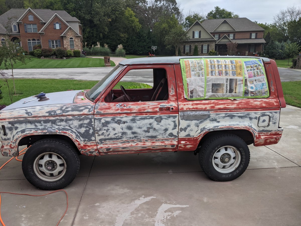

Was able to get door handles and lock cylinders off today.
Not to bad of a job. I found it easiest to just drill the rivets out. I actually used a center punch and was able to drive the rivet out, then stepped up in bits until I had it drilled out.
I also fitted my junkyard fender. It's pretty straight, couple of minor dents. Much better than my original one.
A day at a time. Primer is coming up soon.

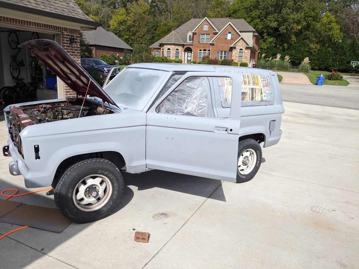

The work continues. I'm hoping to be able to spray primer tomorrow. I'm definitely close.
Looks great. Don't forget to do the inside of the gas door. Otherwise, every time you get gas you're going to be mad at yourself.
Yep I'm on it! I'll prop it open while I spray.
I already took the filler neck loose and got it out of the way.

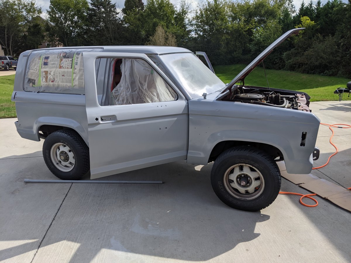

I sprayed my first coat of epoxy primer today. Went all well, I've got some stuff to learn, but I got good coverage and can begin the rest of the body work now. I have more primer left to do more coats and my final sealer coat.
Primer job looks great from 10 ft, but I have some screw ups to fix, but this is supposed to be very easy to sand so we shall see.
