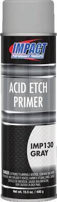

^ that's what I have been using. It get sprayed right after a panel is sanded. Very light coats, just a misting is enough. Probably available at your local body shop supply place or they will have something similar.
Primers really aren't a rust prevention method. Especially etch primer - it's only real purpose is to make your top coatings stick. If you are still driving your truck or leaving it outside I would probably try to at least use a 2k primer or epoxy primer over the top of your etch coat...that way the area you took down to bare metal will have at least a little waterproofing.
I have used two types of 2k primer on mine so far, first was Nason SelectPrime 421-19 and am currently using U-Pol 2253. I liked how the Nason sprayed but it is quite expensive and goes on pretty thin. The U-Pol is definitely a lot thicker and was difficult to apply even with a 2mm tip on my gun. Works a lot better with reducer added but that's an additional bummer - the primer/hardener was about $80/gallon vs $67/quart for Nason but if you have to buy reducer as well, the cost starts to become a wash. @BlackBII said he was using Speedokote on his, I am curious how that compares.
Put a clear coat over the primer to seal against moisture.

Edit - When I was doing my tailgate, I was out of etch primer so I bought some Rustoleum in a rattle can from autozone, and it wiped right off with wax and grease remover. No good at all.

I experienced the same exact thing when I was working on mine, the etch primer wiped right off. It will keep rust at bay now, but I believe I'm going with Epoxy. Tamco stuff still has the lead the more I read about it.
