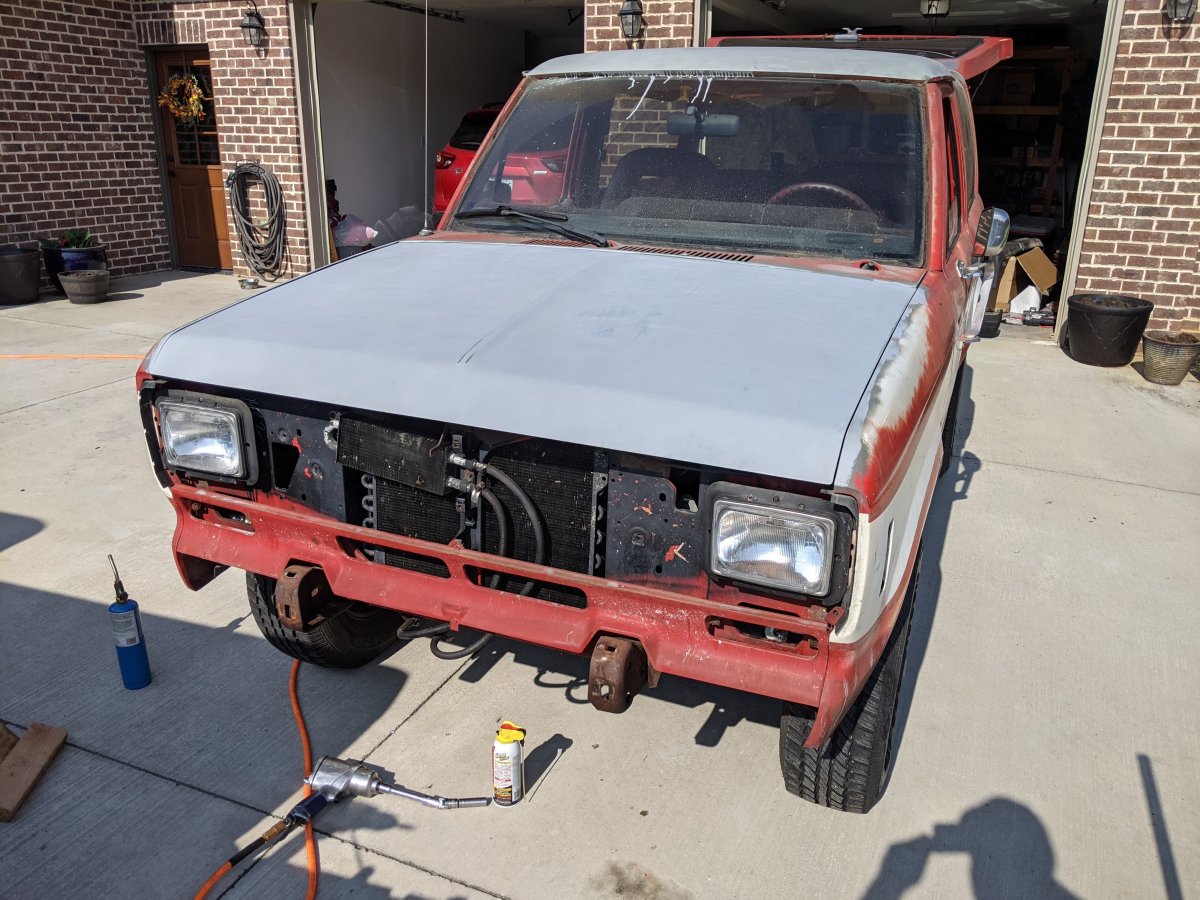

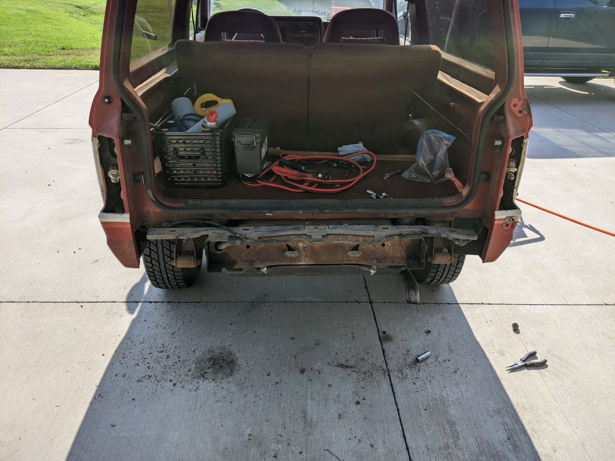

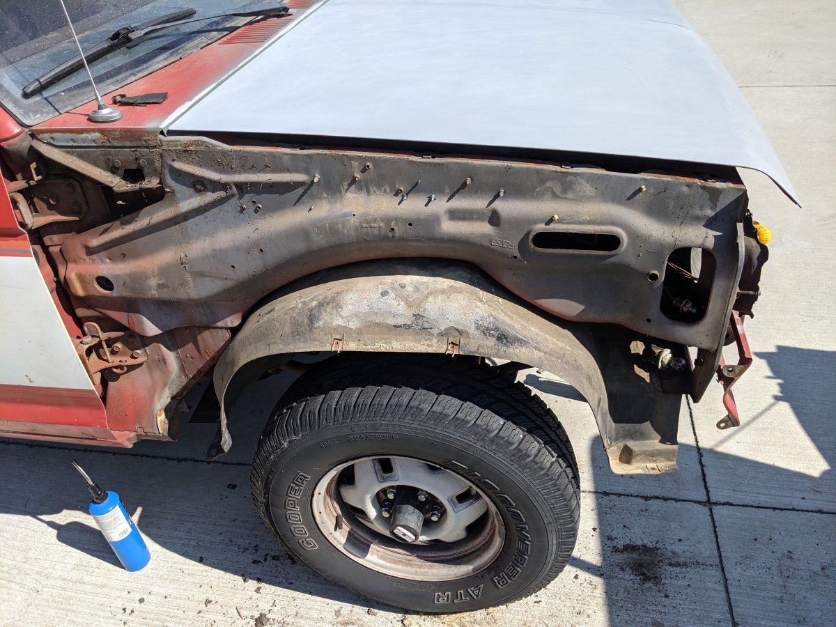

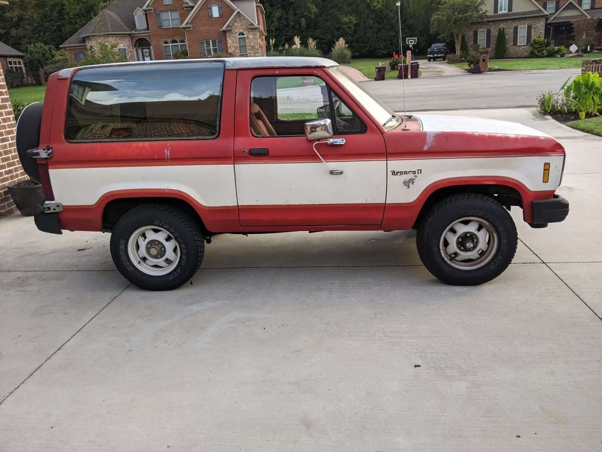

I started disassembly this morning so I can get ready for primer coat soon.

Always nice to be ahead of the curve. Glad things will work out on the job front.
I would recommend having the rear, doors, and 1/4 windows pulled, the windshield will be fine with just the trim pulled. I'm not sure if the 1/4 windows are like the windshield or if its a gasket just holding it in.
Anyway, the finished product will look a lot better with them out. I painted my truck in my driveway when I had a couple day stretch of sunshine. This was over about 3 weekends. Take your time and be sure to look at every inch of each panel before you paint. I didn't go down to metal completely but some parts were.
Do not even think about painting until you dream of this...

I'm really glad to see that you're still plugging away on this truck. It will be worth it!
It actually looks good in your first pic, and I'm sure it will be even better when you get done. And I actually like those wheels, as you just don't see them any more. I'm guessing that you've been driving it, and hope that it's doing you well.

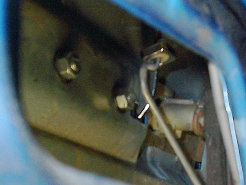

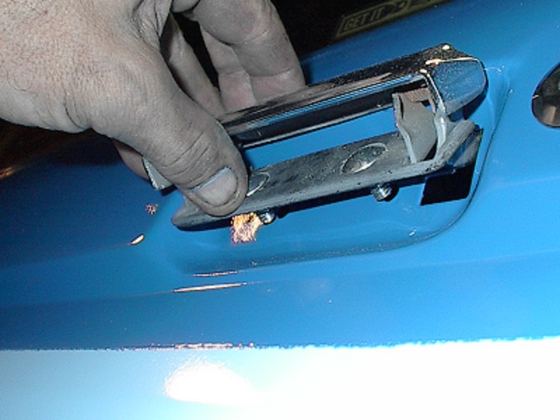

You can remove the rivets and just replace them with bolts, that's what I did. I used a nylon lock nut on the back side so they can't be easily removed. You can try painting around it, but it'll hard to get paint in there without spraying too much.
Did you fill the gutters with new seam sealer? The factory stuff is probably all hard and cracked. An epoxy like Fusor 129 is what I recommend using to fill the whole rain channel so it never leaks and rusts. Make sure you scrape all the old stuff out first of course.
On mine I cut the rivets and reinstalled with bolts. It wasn't too bad, and I think it's worth the trouble.
I used a file to square the holes, and used stove bolts:
67005
(sorry it's so blurry)
This makes for a finished look on the outside:
67006
And this is how it's mounted from the inside:
67007
If I recall (shit! it's been 12 years since I painted 'Ole Blue) I used a die grinder and cutoff wheel to grind away the rivets from the inside.
I started the removal of the old seam sealer today.
You guessed it, it's old and cracked.
