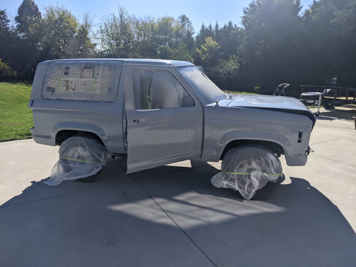

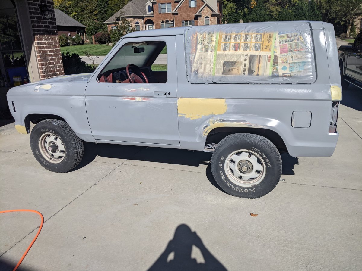

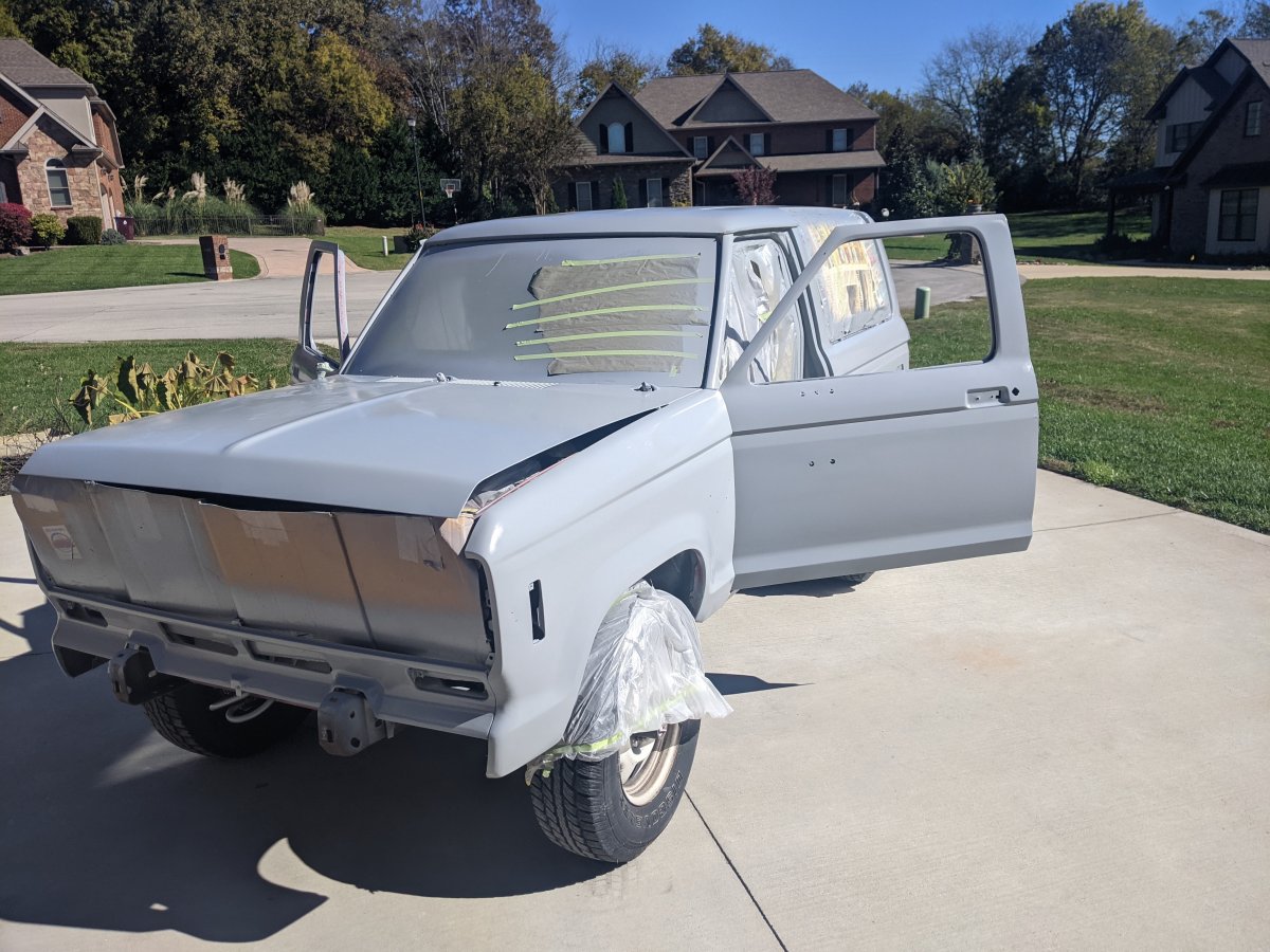

The body work begins. I'm basically a novice at this. Trying my best to fill, sand, fill, sand, repeat. I'm using the DA a little, but I'm mostly using the durablocks to try and get it pretty flat. The one behind the driver door sucks, bit I'll keep working at it. Good news is the epoxy primer sands very easily. I plan on shooting two more coats of it since I have it, but that is a ways off at the moment. Still more work ahead.

Looks good, you will want a bunch of primer over any filler you have, filler soaks up primer like crazy. I was advised to use etch primer over any bare metal that's exposed too where you sand through your primer.
Think about removing the nuts on your wiper linkage studs and letting the whole thing fall into the cowl... one of my first (failed) attempts at base coat involved spraying around those studs, it was very difficult to paint around them completely. Getting them out of the way made things significantly easier... the last thing you want is a run or a bare spot there because the stupid studs were in the way.

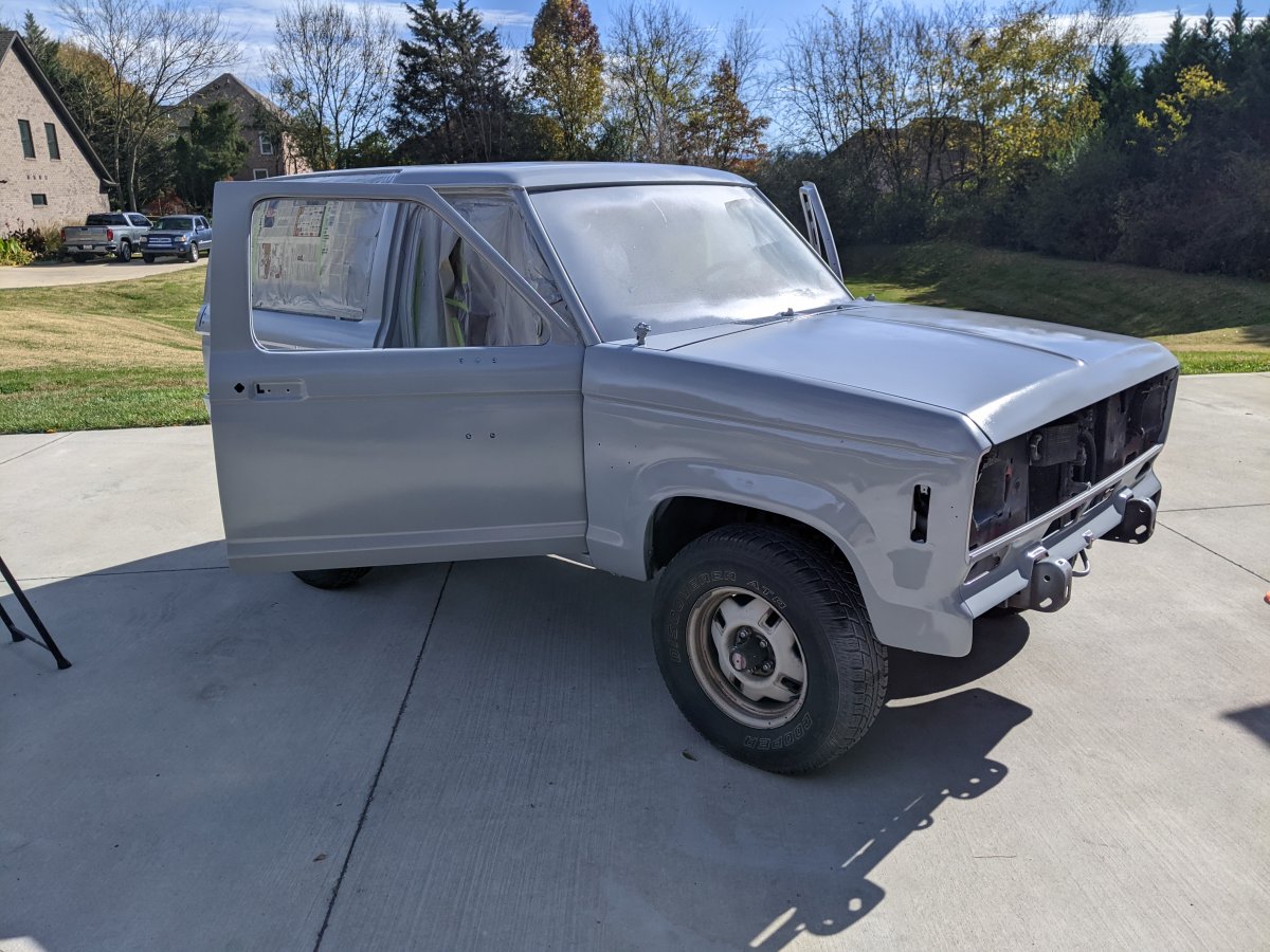

Was able to get another coat of primer on it today. Weather isn't warm enough for another, so I'll let it cure out because I was going to sand between coats anyways. I think I've got the dent behind the driver's door in good shape, but I need to fix a couple small things on the tailgate and the passenger fender isn't perfect yet.
Luckily this primer goes pretty far. I highly recommend the Direct to Anything primer from Tamco paint for anyone wanting to get an epoxy. Sprays great and is easy to sand. It is a rust encapsulator at 3 coats, and I'll probably end up with 4. I'm going to use it as a sealer as well.
It also has a slight sheen so it's much easier to see any imperfections at this stage vs before I every get paint on it.
My technique was much improved this time as well. Snapped a few pictures too.
Getting there a little at a time.

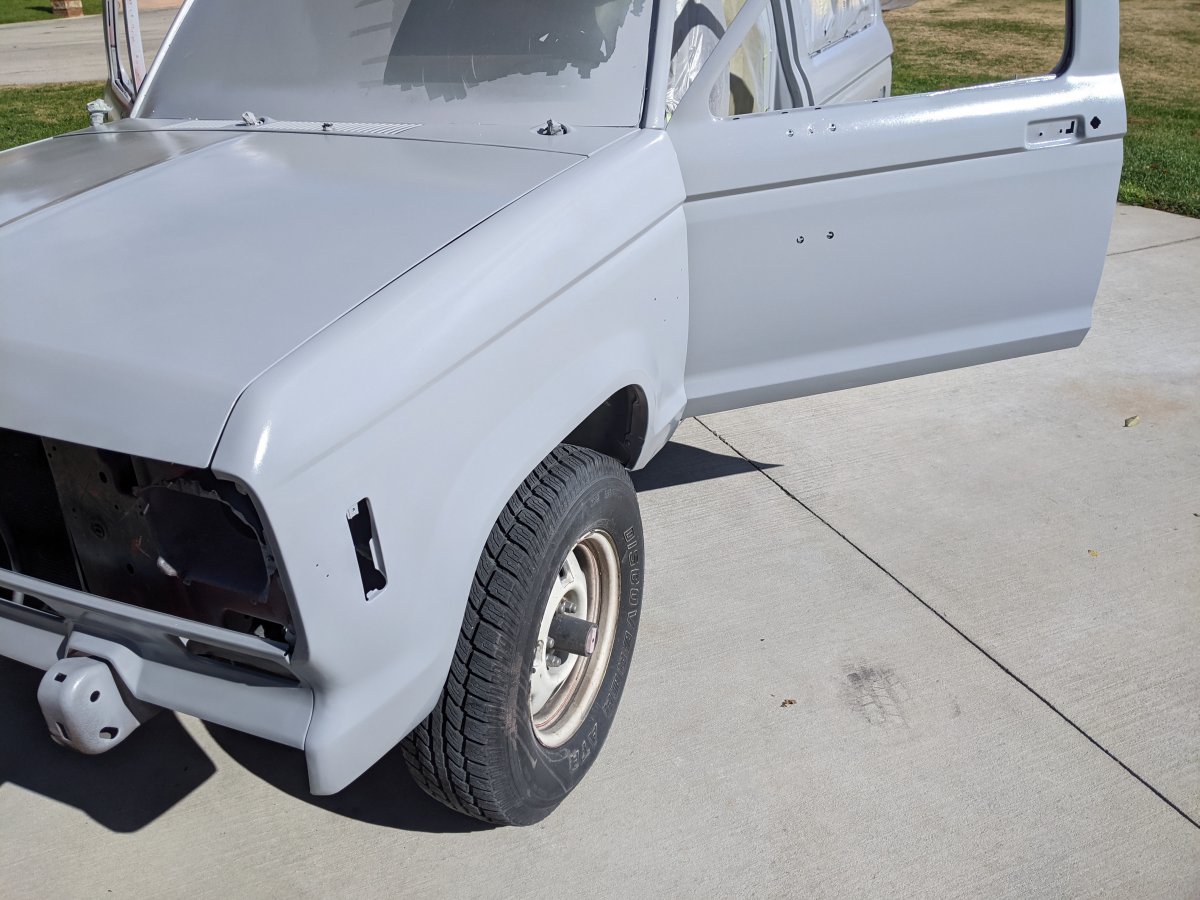

Another small round of body filler and a primer coat for today.
I think next we'll be wet sanding and one final coat of primer.
I think it's turning out pretty good. This won't be showroom by any means, but it shouldn't rust anymore!
The weather is the only that will slow down my progress at this point.

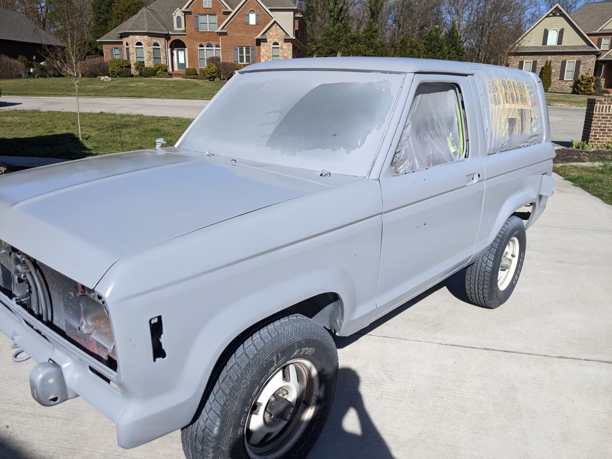

Did some wet sanding today trying to fix the last few minor things, then another coat of primer and it should be ready for top coat.
The weather is fighting me, been too cool to spray really. I might try to spray inside at some point, but that will require a lot of work I'm sure. Just have to weigh my options.

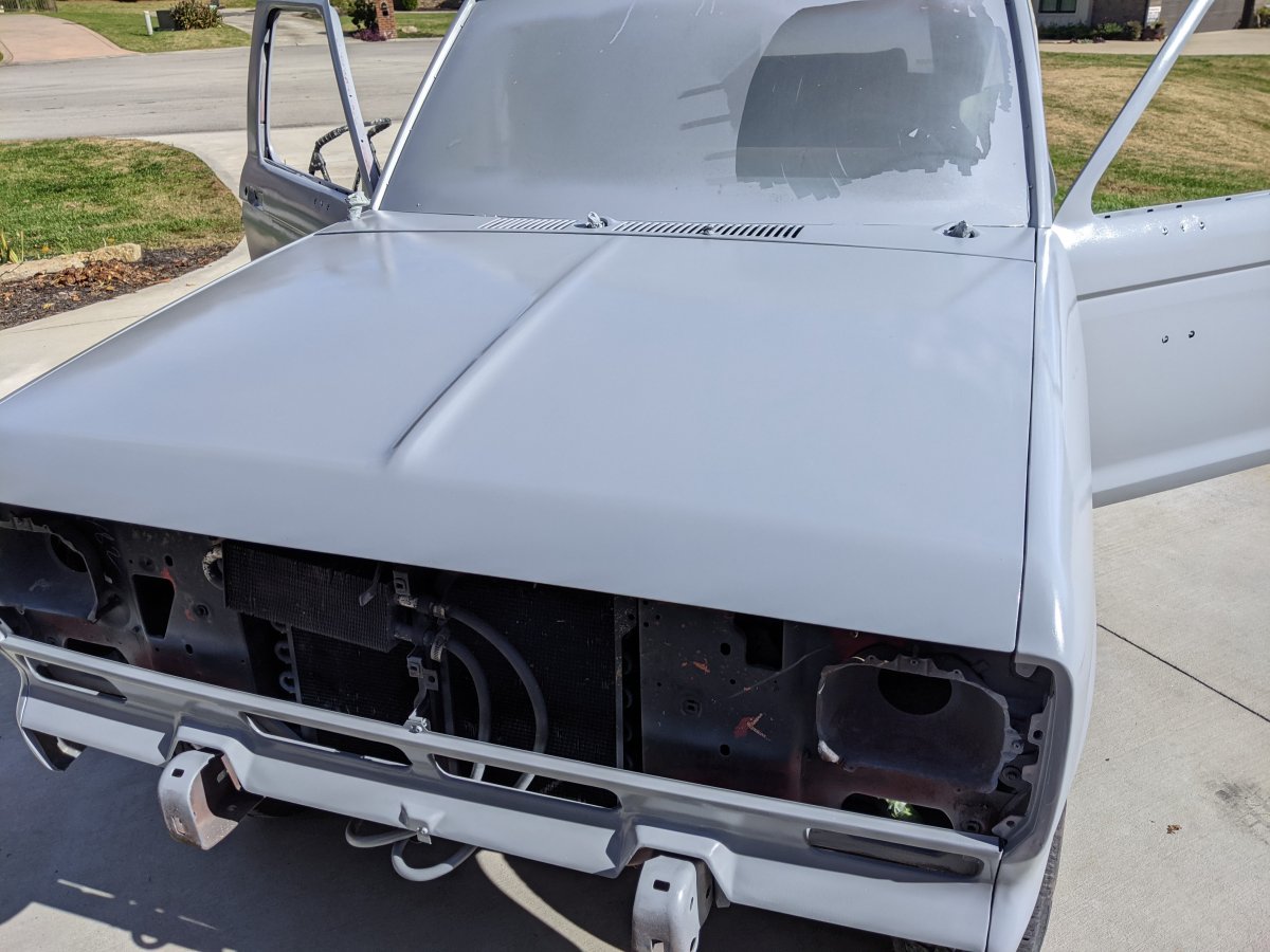

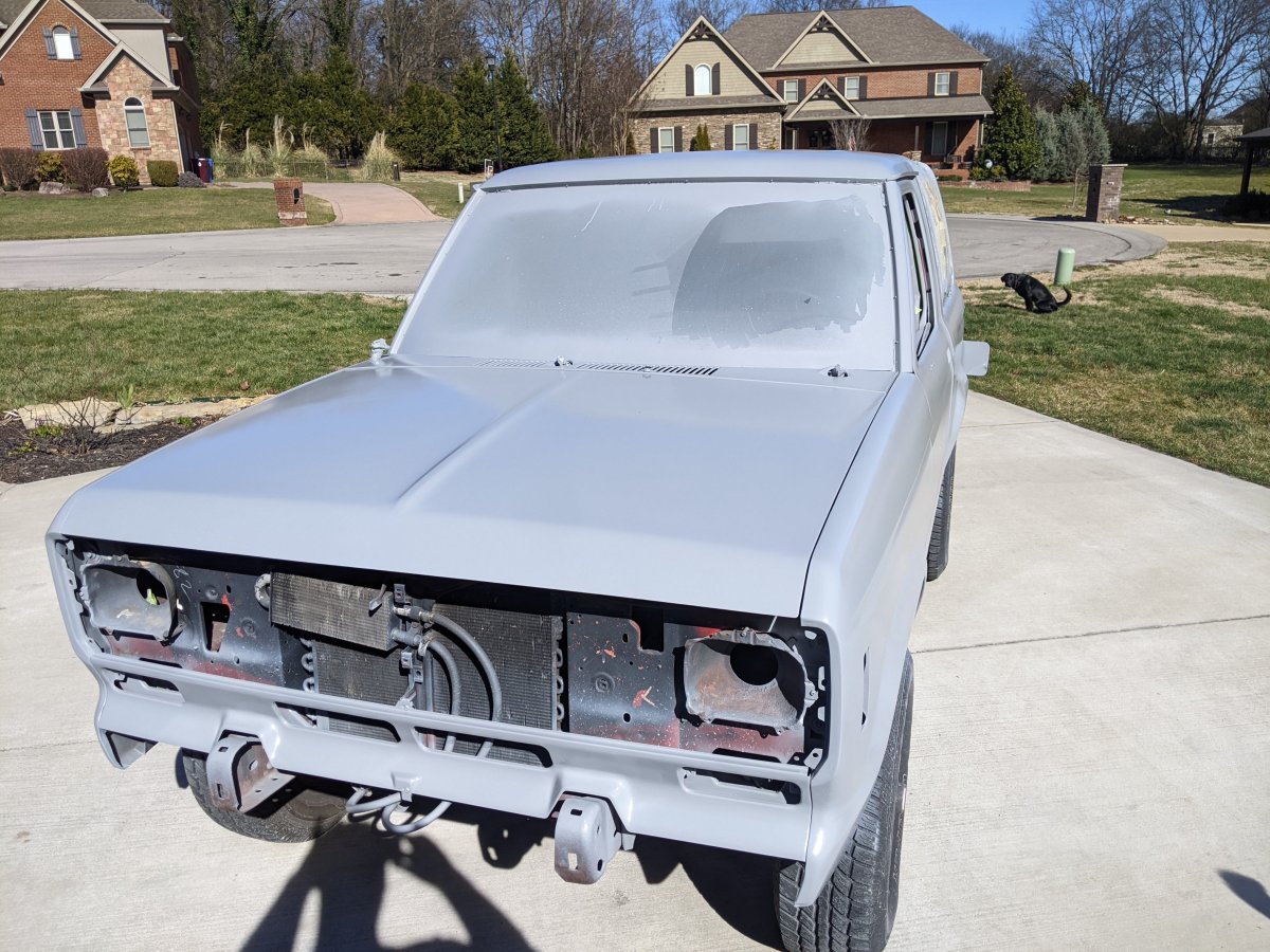

Well... Sitting here waiting on winter to be over. Really miss driving my Bronco, and the my commute to work is less than 5 miles one way now, so it is begging to be driven. I have started it and let it warms up and pull it out of the garage a few times. It has started and ran well.
It is leaking a little bit of oil from the valve covers, and my trans pan is leaking, but I'll tidy all that up once I get the last primer coat and get some paint on this beast.
Well... I've done all I can do as far as the priming goes, it is not absolutely perfect, but is good and will look amazing next to what it did. Plus it has protection from rust which was most important to me.
Now it is time to get the paint on order and pick a good weather weekend to get started.

Your auxiliary trans cooler looks identical to the one on my '84 Ranger. My thought is that these were dealership-installed; looks like a Ford part, but added after the assembly line.
That's really coming along!
Nope, that cooler' tis factory.
As far as I know it's factory.
I actually plan to upgrade to a bigger one I have on the shelf. I'll do that before I put the new grille on.
