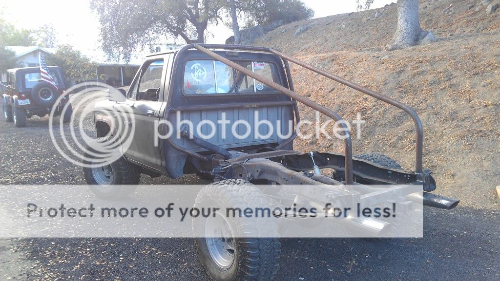

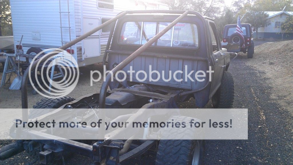

so ive started on my tubing work, so far ive taken off the bed and iv been doing some playing around with the bender cause ive never done this kinda stuff before.... oh and i found a huuugeeee exhaust leak!:icon_welder:
got started on the bed!:icon_welder:

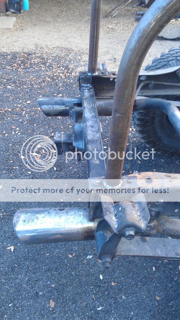

and i bobbed it to the shackles
looks good for a first timer. alittle big you think? You should bob the rearend more and move your springs forward.
Ehhhh... Id like to but I'm to busy to take that on till next summer, the only thing I regret about the bob is that I didn't weld that hitch crossmember thing to the upper part of the frame, I feel like I'm gonna drag it every time I come off of a rock
When bending, put the weld seam of the tube on the inner radius of the bend, this puts it in compression and results in a stronger design.:icon_thumby:
If your hitch doesnt drag your exhaust will. ^^^he's right. you'll learn as you go like most of us. good job though.

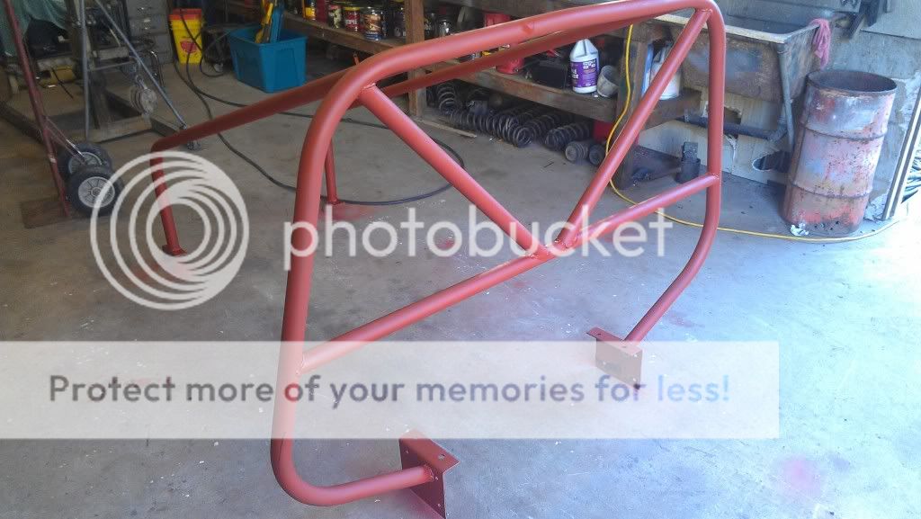

added the last tubing to the rear hoop section of the cage and primed what i have done

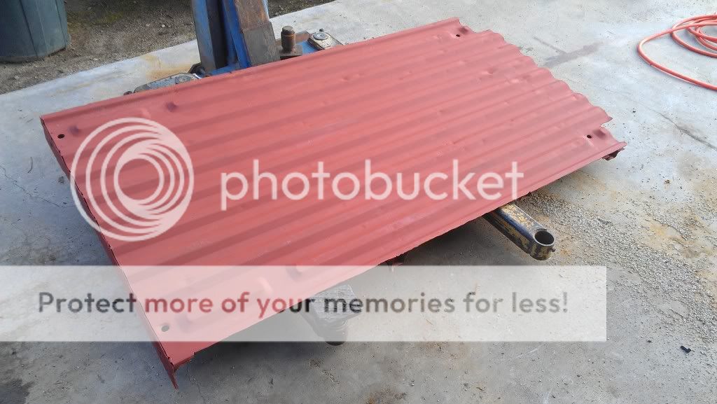

also i cut the platform part of my bed out and trimmed it up nice, forgot to take a picture of it all cleaned up and primed but its gonna go back on the truck

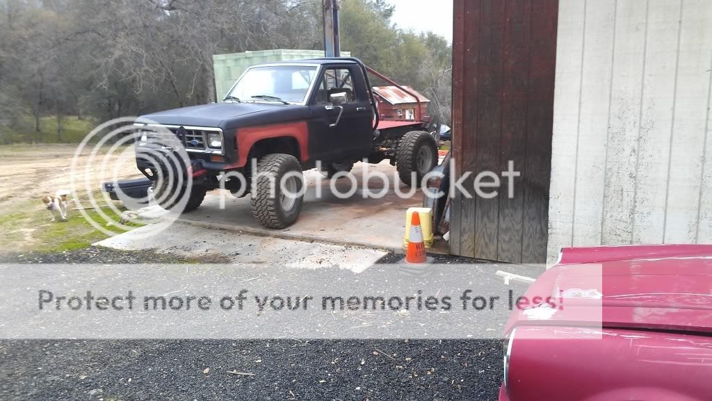

the ranger is back on the road!:icon_bounceblue:
i sprayed some gloss black where i wont be able to get it later and bolted the bed and tubing down. and i have a temporary-ziptied-mocked up-shitty quality-light bar on the back till i get to the point where i install the lights in the correct spot...
i love its stance from the front....
lookin good. keep it up and you'll be able to play with the big dogs. My buddy's up at shaver are pushing me to come up and do a snow run this year. Not my cup of tea but if I do I'll let you know and maybe you can join us huh?
