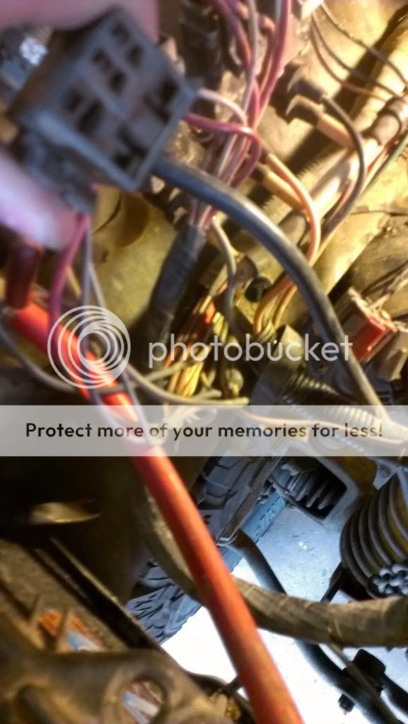

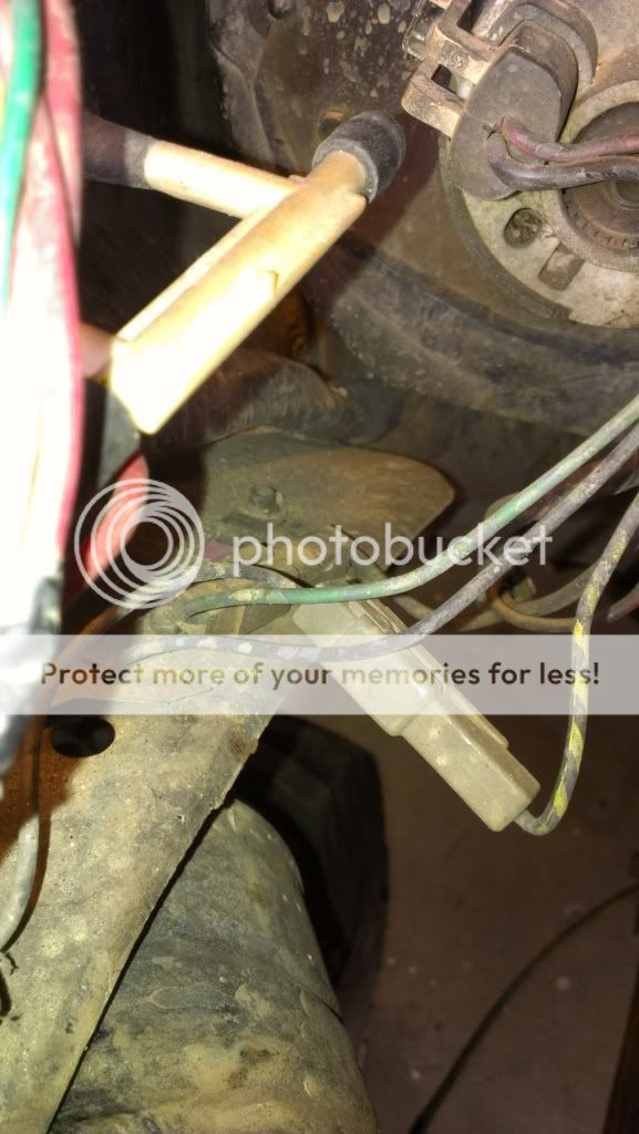

ok so iv been trying to figure out this really bad eletrical short that iv had going on for a while now and i think i have it figured out.... im pretty sure it is this thing
'84 ranger 2.8L 4x4 build thread
i had problems with it a long time ago and i went to carquest to get a replacement one, i think that the part is discontinued or something so the replacement one was from a newer ranger and im thinking that it might not be exactly right? i took it off of the truck and if the battery isnt dead tomorrow morning then ill know for sure that it was the problem... but for now, has anyone had trouble with this part before? or does anyone know where to get one that has the original part number?

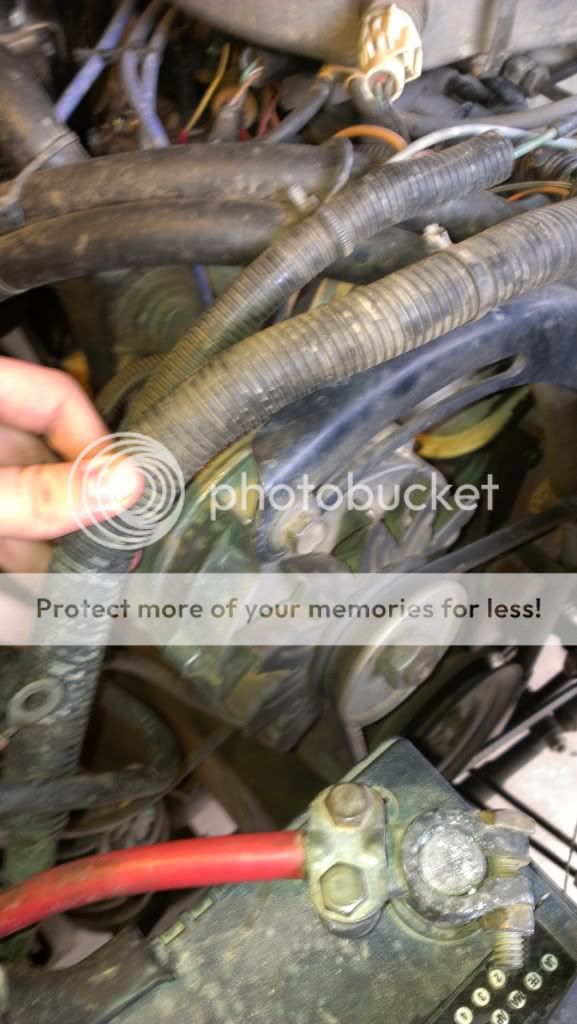

here are some more pics of it in case someone needs to see some more of what im talking about
this is the part of the harness it is in, the bundle goes to the computer in the cab on this side
over the alternator on this side
and to the starter solenoid on this end, its actually connected to the main power line to the computer

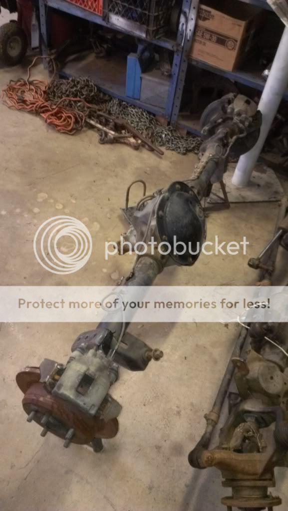

so i got great deal on axles! i got my buddy's HP dana 30 and Chrysler 8.25in for 700 bucks! from it im getting a high pinion, 4.56 ratios, a stronger rear end, a VERY tight L/S in the rear and both axles have less than 2k miles on em after a professional rebuild. im fuggin happy! so now ill be able to afford a front locker sooner than i thought... im thinkin that running a front locker and the L/S out back will get me where i want to go.

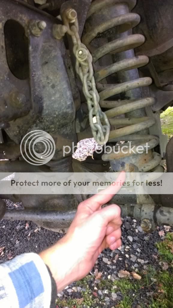

I see that you have used what looks to chain as limit straps for your front axle. Care to go into details on that? Im looking for a cheap way to make limit straps. Also how have the CV joint front axles been working out?
the chains work out great! ill post pics of where and how i attach them tomorrow if ya want, and as far as the CV axles go i havent really put enough miles on em to give a real answer but so far no problems... my new axles are just traditional u-joints though
I have been running the CV joint axles since I got my D30, came with it, but have a set of ujoint ones that just need new ujoints put in them. The CV hold up fine but the damn rubber boots are the down fall.
I would love to see pics of how you hooked, made, etc... the limit straps. Chain isnt that expensive and I see it lasting forever.
Ahhh... Sorry, I completely forgot to get a picture of the chains today... I'll try again tomorrow :D
Sorry, iv been really busy with work... But I took a picture! I basically bolt the chain to the top coil bucket and to the swaybar bracket

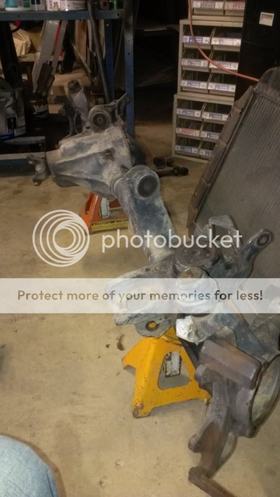

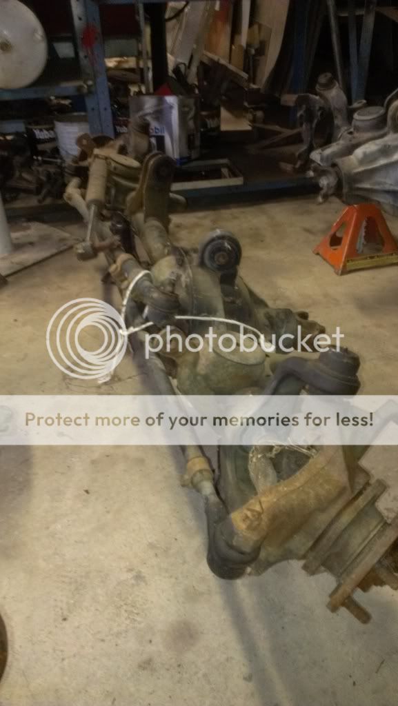

went and picked up my axles! i have to take the shafts out of the parts d30 and put em in the new one, that and moving the rear spring pads are the only things ive gotta do till i bolt em in... but im thinking of making a little truss for my front axle... i might not even need it but who cares, it looks cool and is fun to build

Can I ask why you went with a low pinion 1999+ cherokee axle?
The new one? Or my old one? Cause the new one is a pre 98 high pinion and my old one is a 1998 grand Cherokee low pinion, I only got that cause I didn't know any better at the time

so i swapped in my new axles and WOW huge difference in performance!

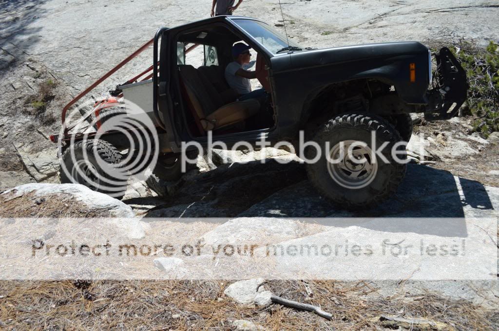

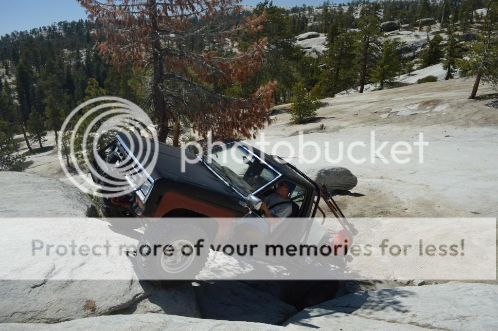

im halfway done making some tube doors and i put in rear speakers, i dont have any pictures of that yet though. i didnt really change anything suspension wise when i installed the new axles, but the 4:56s and posi rear end helped soooo much on my last trip! i could do a lot harder lines and actually didnt find anything on bald mnt that i couldnt do...
