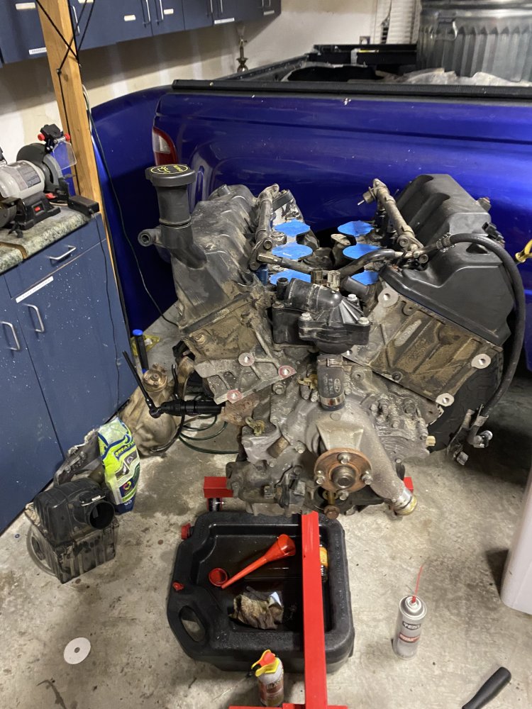

After a looong weekend, I did it. I got the engine out.
Getting it to clear the core support was interesting....my hoist kept hitting the top of my open garage door. So I took the front wheels off and lowered the front down until it cleared. Not the easiest way to do it, but it worked.

Ironically enough,
A) Despite having a 4x4, I don't have a balance shaft for some reason. Guess I can return those parts.
B) the guide that failed was the front cassette guide, and not the far more common rear guide, though I suspect it's not far behind.
This update has been a long time coming!
After an entirely too long Christmas break, the timing repair is done. Everything I could have replaced I did, no cheaping out with a job this big. Both cassettes, sprockets, chains, tensioners, rear main, upper and lower oil pan gaskets, water pump, front crank seal, etc.

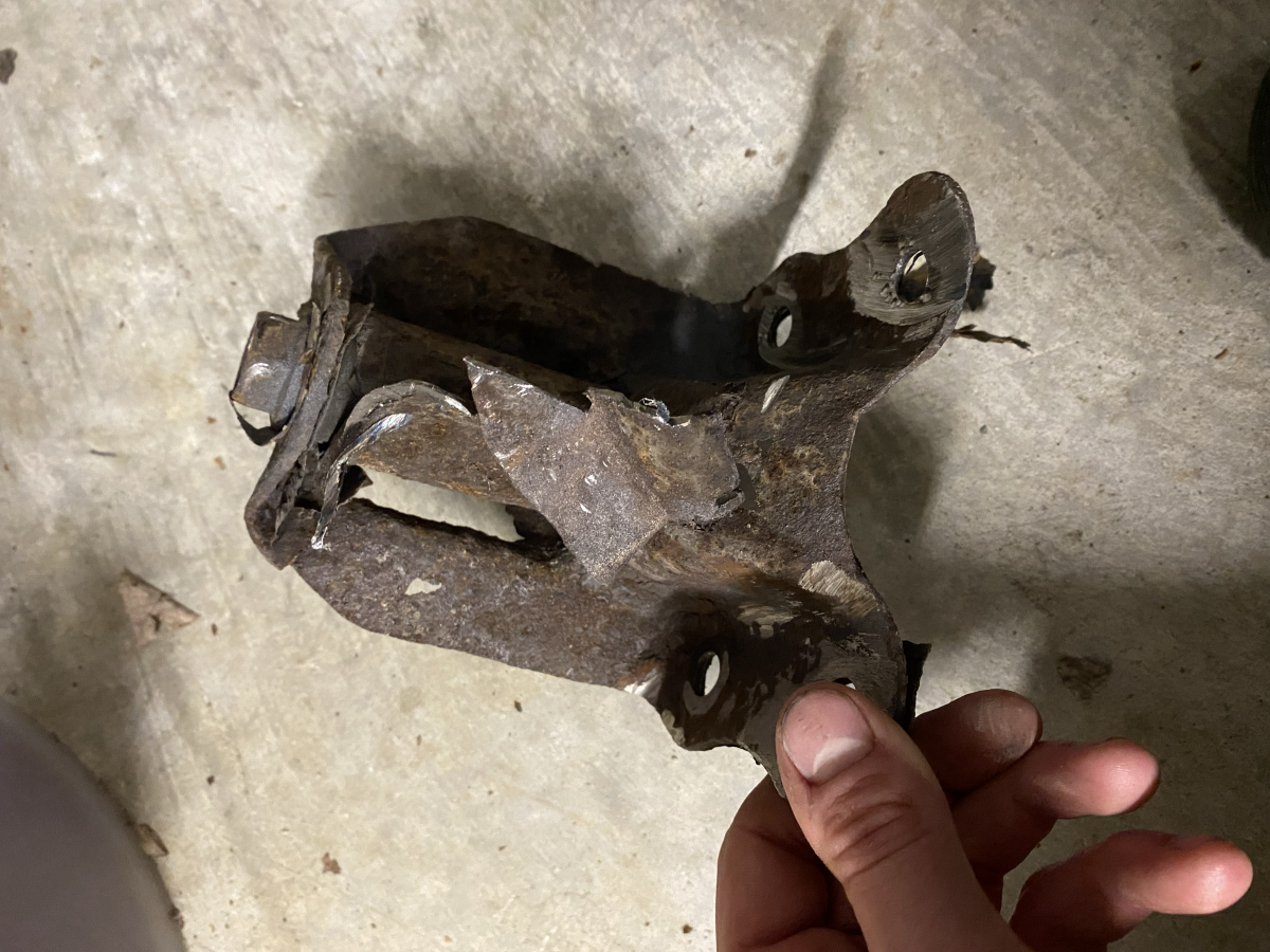

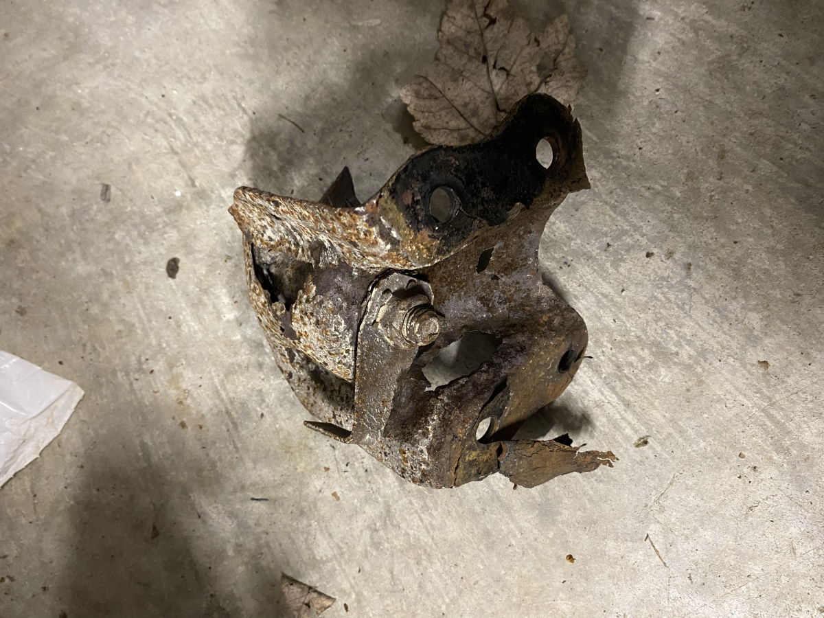

I've also done the passenger spring hanger, as it had a giant rust speed hole through it. The previous guy only did the drivers side, and only when the hanger rotted to the point where the spring broke free and rested on the bed. Just do both of them!
Here's the (mangled) hanger after about an hour of grinding and pry bar-ing.
