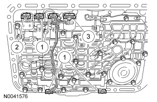

I've been struggling too find a diagram or something too show me what 1 of the 4 shift solenoids is my A solenoid (1st-2nd)
Here is the harness layout showing the locations of the solenoids. The numbers are the pin numbers in the large connector.

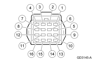

Here is the connector.

What one of those would be for my #1 solenoid then? 7,9,10,14 or 16? Haha.
There is no #1 solenoid. There is A B C D solenoids.
I think you are correct. A solenoid would be wire #16. Wire 10 is common.
If im looking at the diagram correctly, it will be the solenoid on the passenger rear corner of the transmission, would you say that seems right?

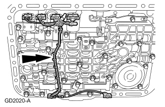

Here's another picture of the valve body wiring. Only thing I can tell you is when you pull the pan off, look for the large round thing that is shown in the pictures below.

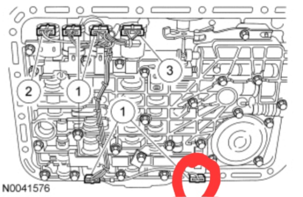

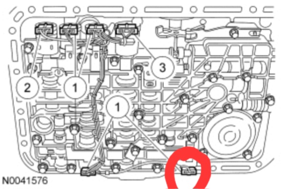

circled solenoid is my A?
  • 5R55E shift solenoid A (1-2) location.
