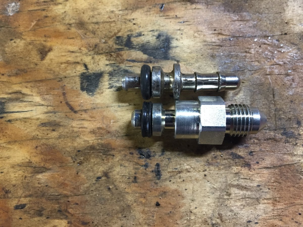

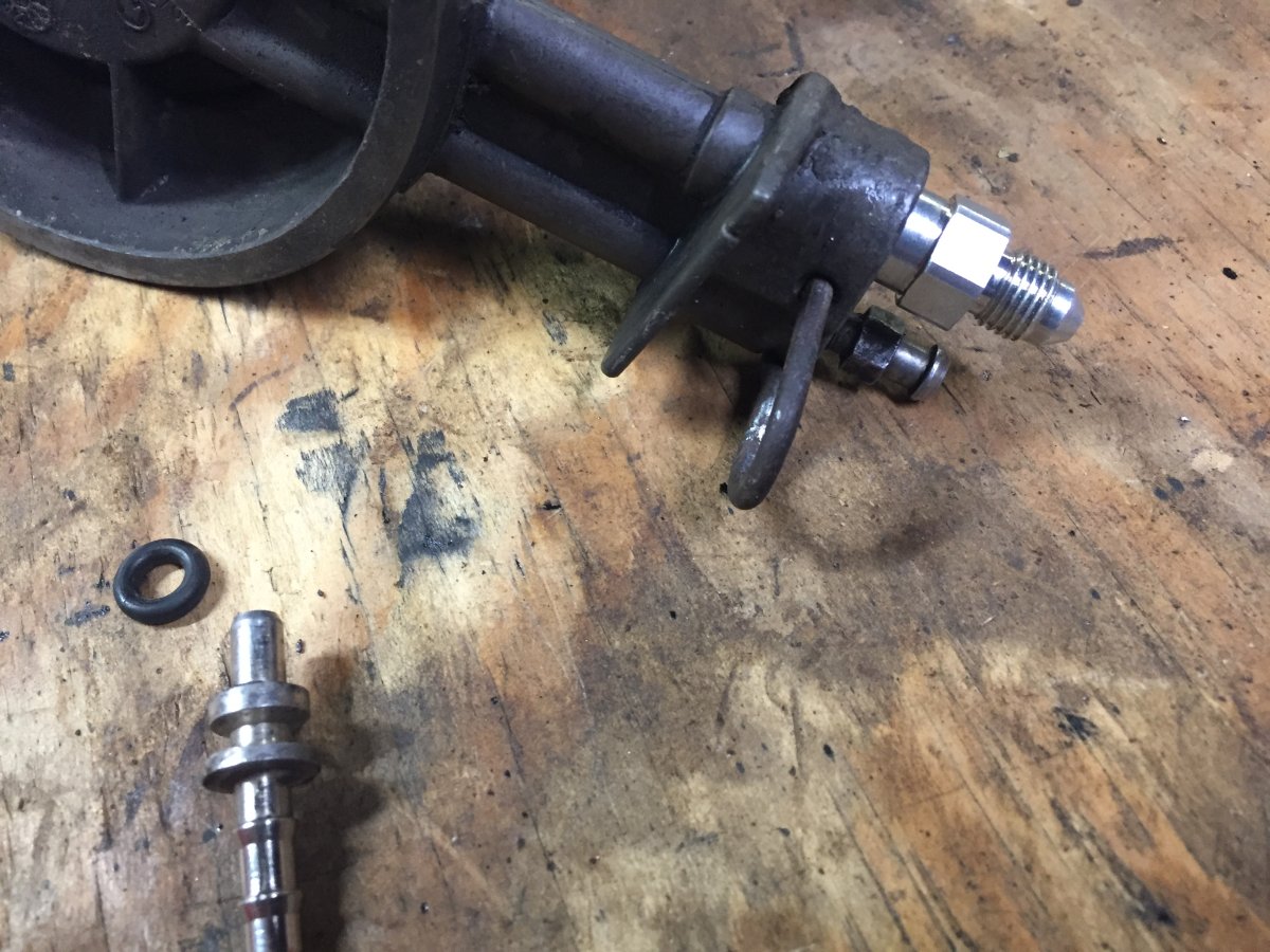

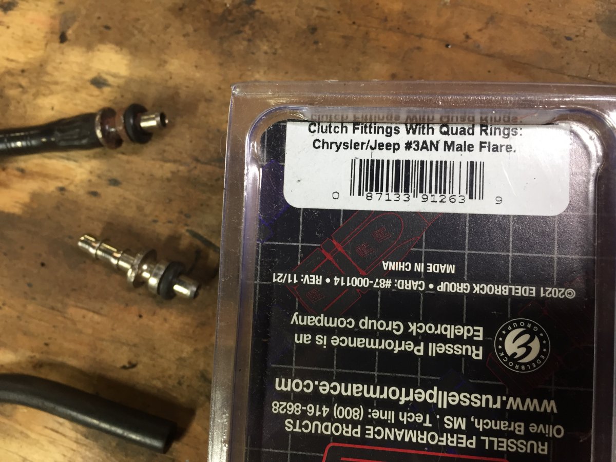

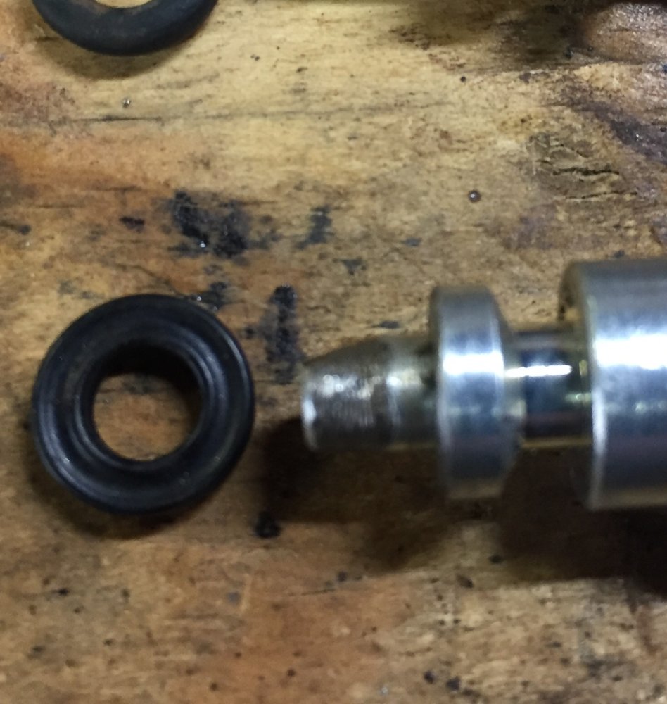

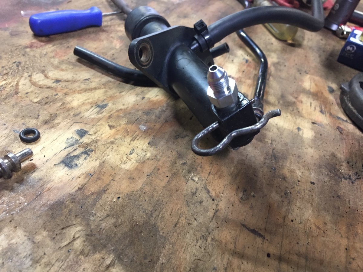

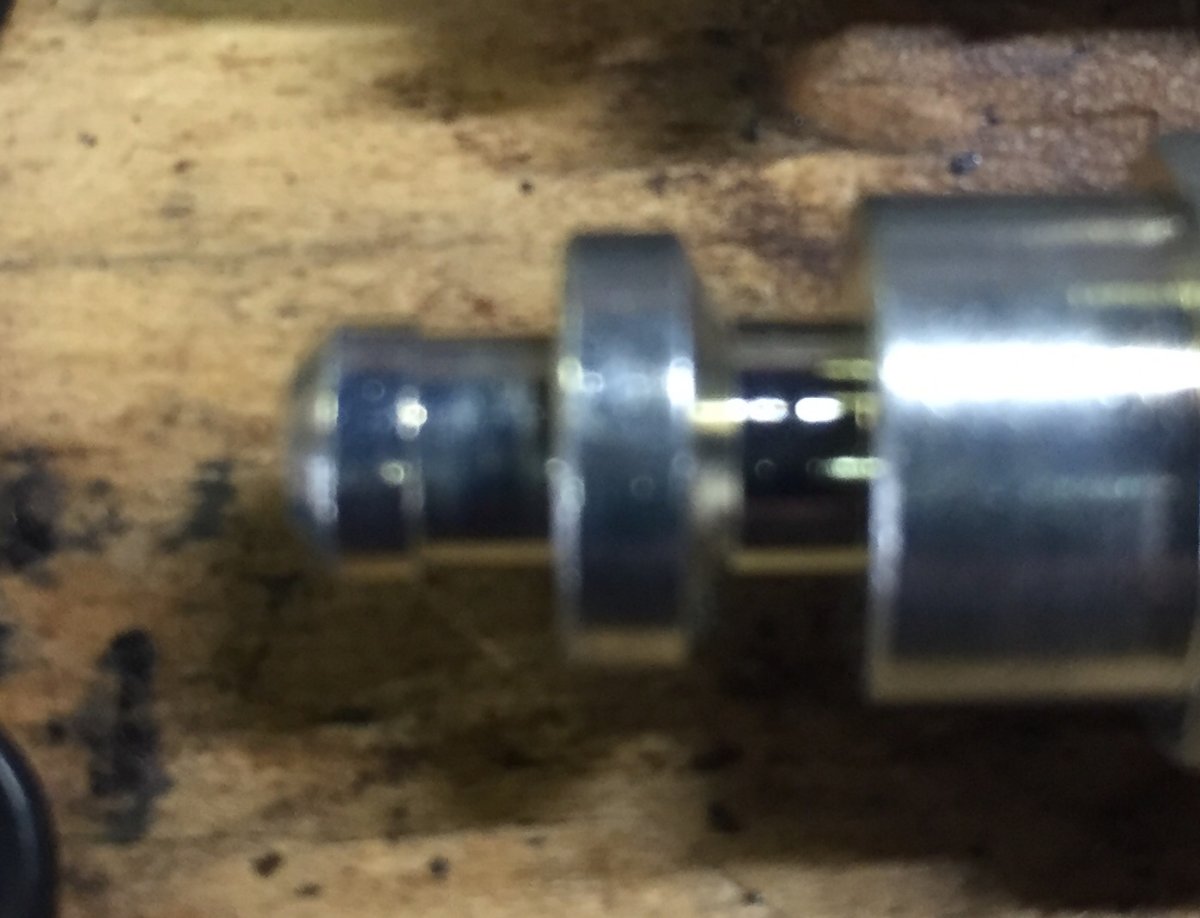

I recently did some work on an FM 145 and am familiar with your clutch line issues. The hydraulic line is N/A and you will have to find a used one or make your own. I found these clutch adapters that will fit in the master and slave and allow for a custom flexible hydraulic line to easily screw on the adapters.
5 speed swap
5 speed swap
The nipple has a ridge on the end that needs ground off but once removed it slides in the port.
5 speed swap
5 speed swap
I picked them up at summitracing.com.
