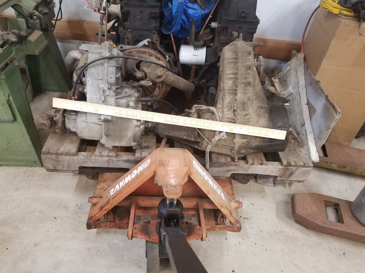

The 4406 is not much bigger than a 1354, the clearance issues are on the 1356 that was in earlier F150's... I conveniently have a 1354 and 4406 sitting next to eachother on a pallet (one spare for the '90 Ranger and one to convert my other V8 explorer to 4x4 from AWD), we'll see if I can get a comparison picture tomorrow night... You'll likely need a front driveline out of a 4.6L F150 or Expedition (assuming you're keeping electric shift so you can add in Expeditions to the search) and might as well grab one of the rear drivelines (don't know if any lengths match up unlike on an Explorer where a rear Expedition shaft from a 5.4L bolts in)
Ok, here's a pic of a comparison between the two cases, the 4406 is a bit longer but not too much more offset. I thought the yard stick would show up better but apparently not
