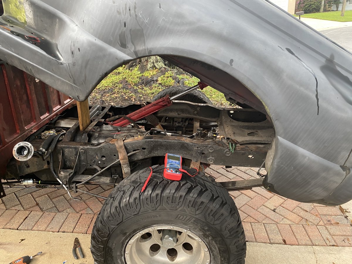

I recently bought a 1998 ranger with a carbureted 5.0/c6 already swapped into it. I bought it to build into a streetable truck (not a daily) that can handle more serious off-roading/mudding. My plan is to do a sas with a Dana 44 up front and a 9 inch rear end. I am currently in the middle of regearing and narrowing the rear diff. I took 6 inches out so the new width will be around 59 inches. Waiting on some 5.14 gears to show up to go with a spool. I’ll post some progress pics when I get a chance.

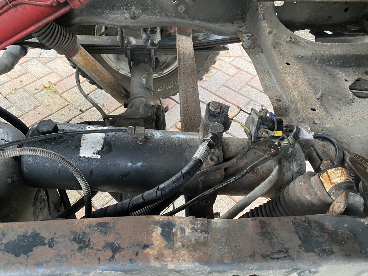

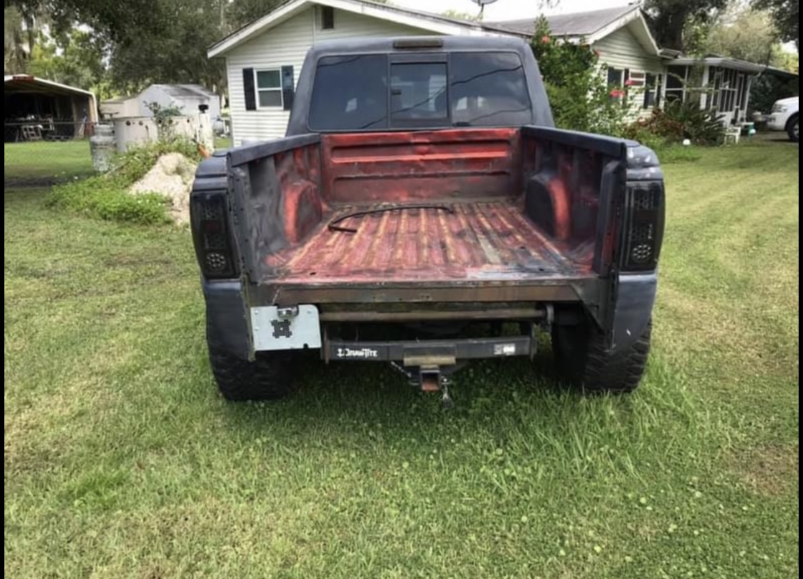

What makes this build a little different and to my surprise, when I bought the ranger I found out a previous owner installed a hydraulic arm under the bed to use it as a dump bed but the wiring to control the hydraulic was all cut up and broken. After some research and a afternoon wiring things up I now have a mini dump truck with a v8 lol.

Here are some additional photos
The dump bed hydraulic

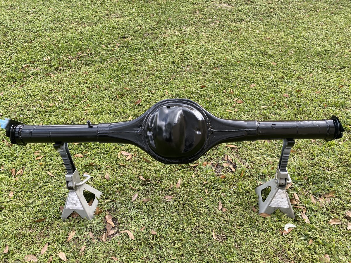

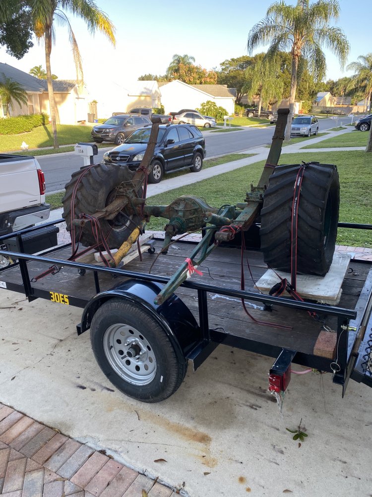

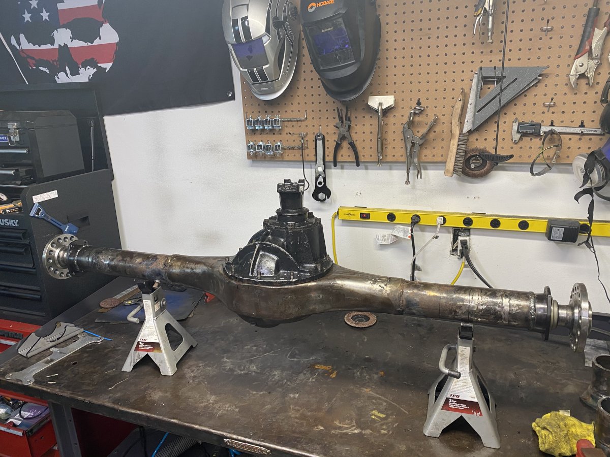

donor rear end out of a 1979 f150 converted into a swamp buggy

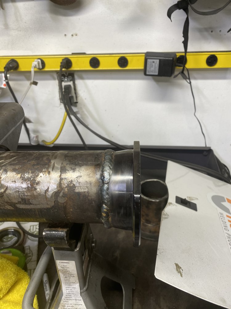

prepping the housing to be narrowed

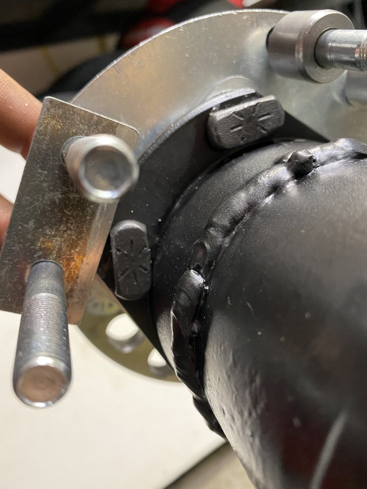

welded on new housing ends

Looks nice.
You might find the first picture interesting.
One day I will get better pictures....
Wow! Nice find. That will be handy for hauling home some mulch for the flower beds.

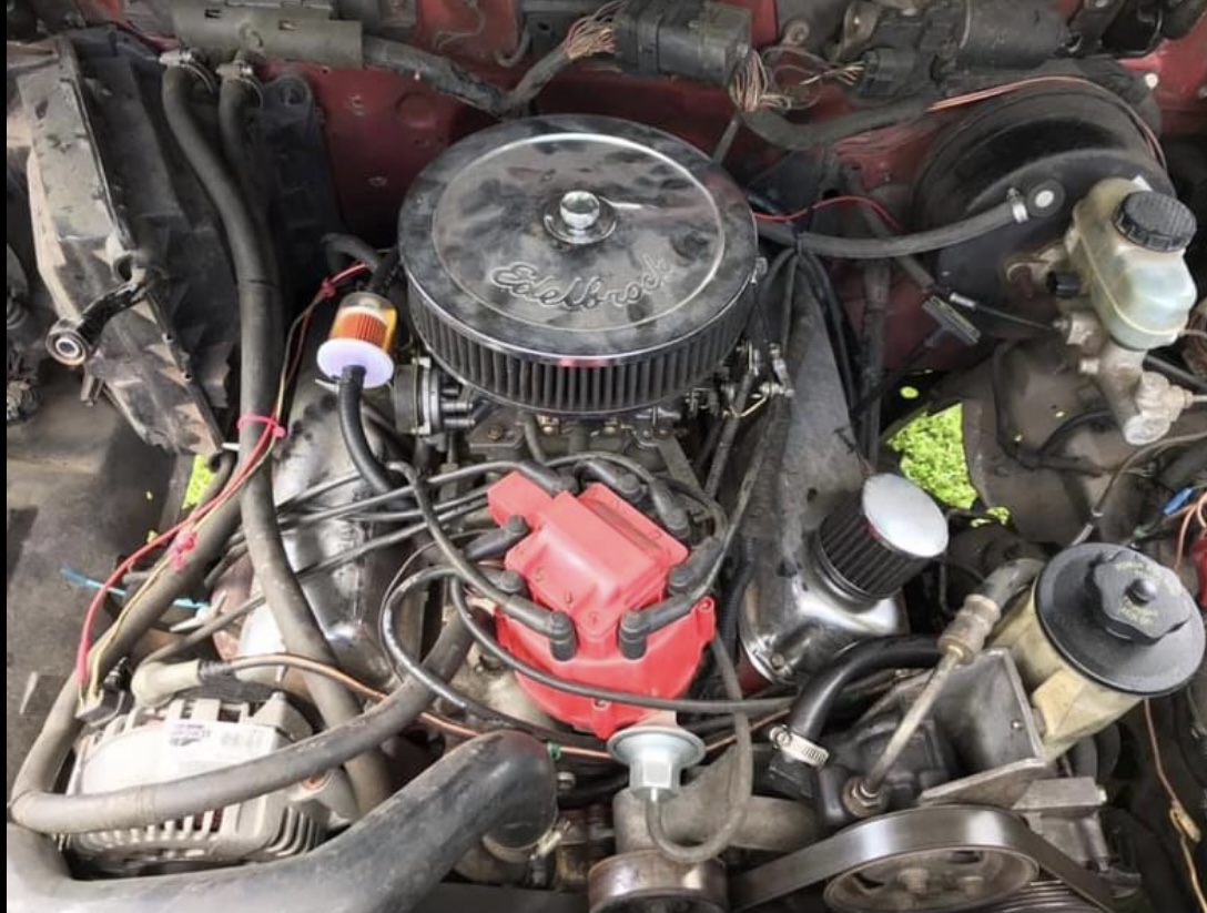

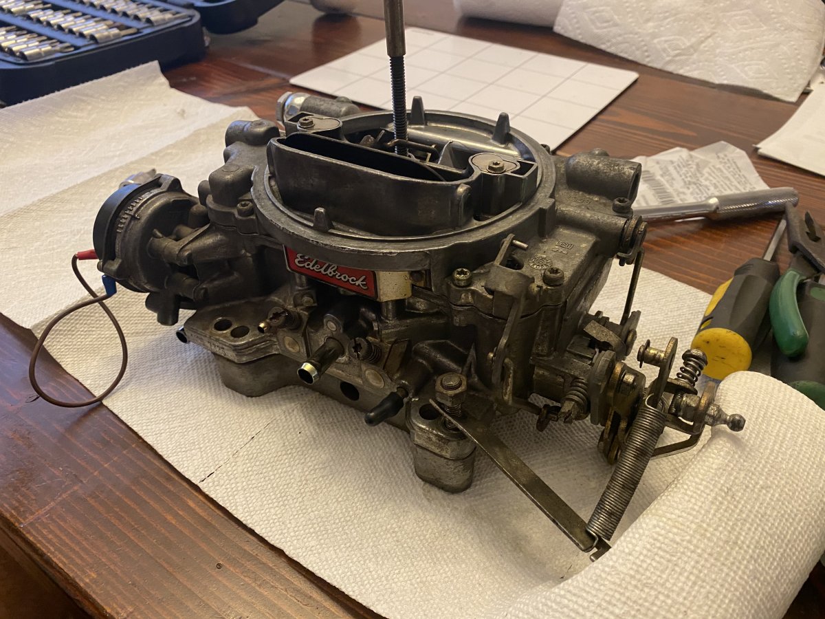

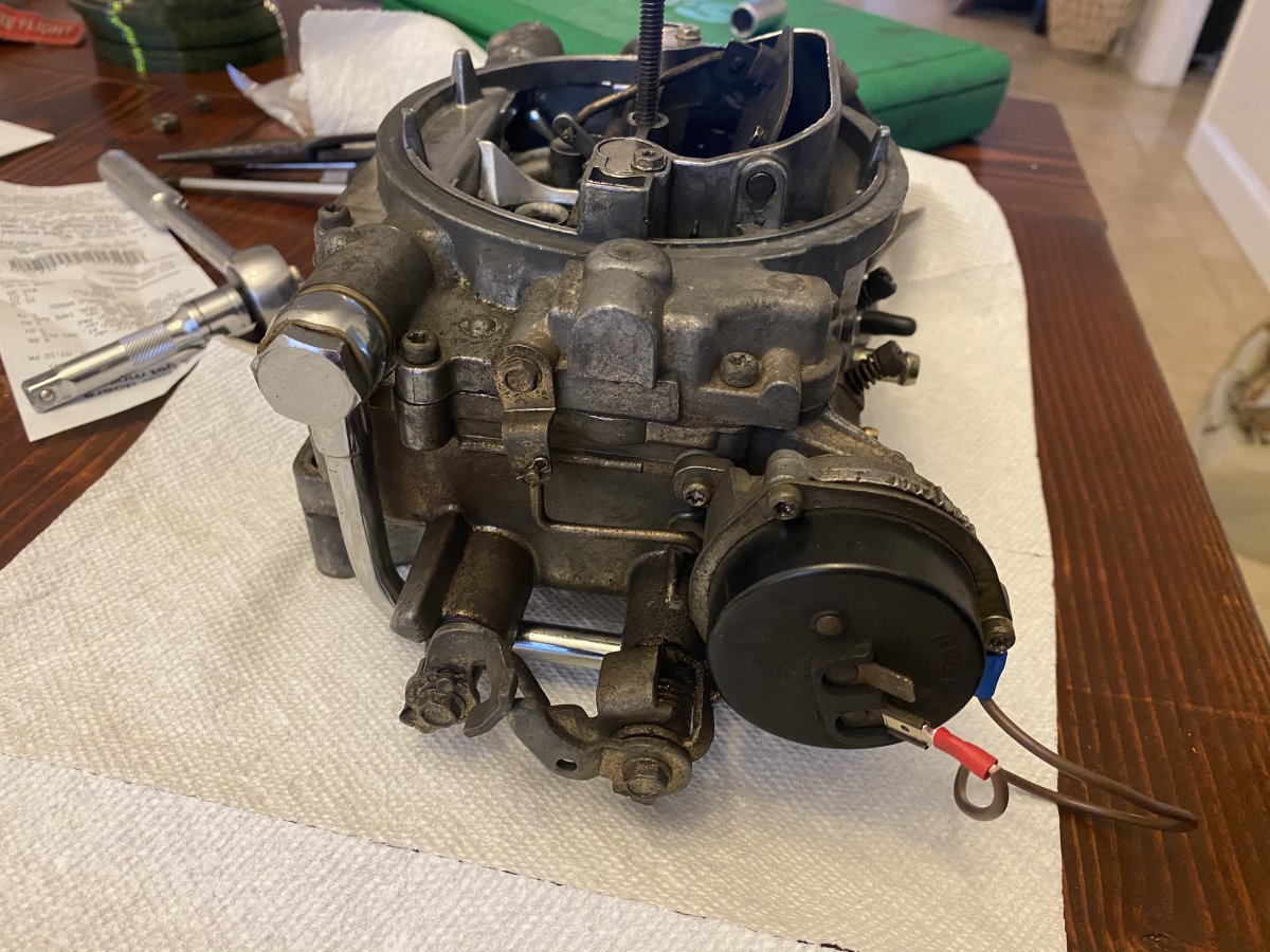

Once the truck was running I found it periodically had a nasty backfire when accelerating. I checked the sparked plugs and their gaps. Everything came in between 0.040 - 0.045 “ as expected. So I decided to rebuild the Edelbrock carb. This helped the engine run smoother but the backfire was still present. Then I started looking into timing. The truck has a HEI distributor and was setup with 6 degs initial timing. From my understanding that is the correct initial timing for a stock engine but with aftermarket intake and carb the engine needed the time advanced. I bumped it up to about 10 degs initial and haven’t experienced a backfire since. I am still playing around with increasing the timing to find the sweet spot on the butt dyno. I’m currently closer to 14-16 initial and 36 total timing. I plan on trying a lighter set of distributor springs in the future. I have never played with a distributor and timing before. I am amazed at what a difference it made in performance. The engine is a lot more responsive and snappy off the line.

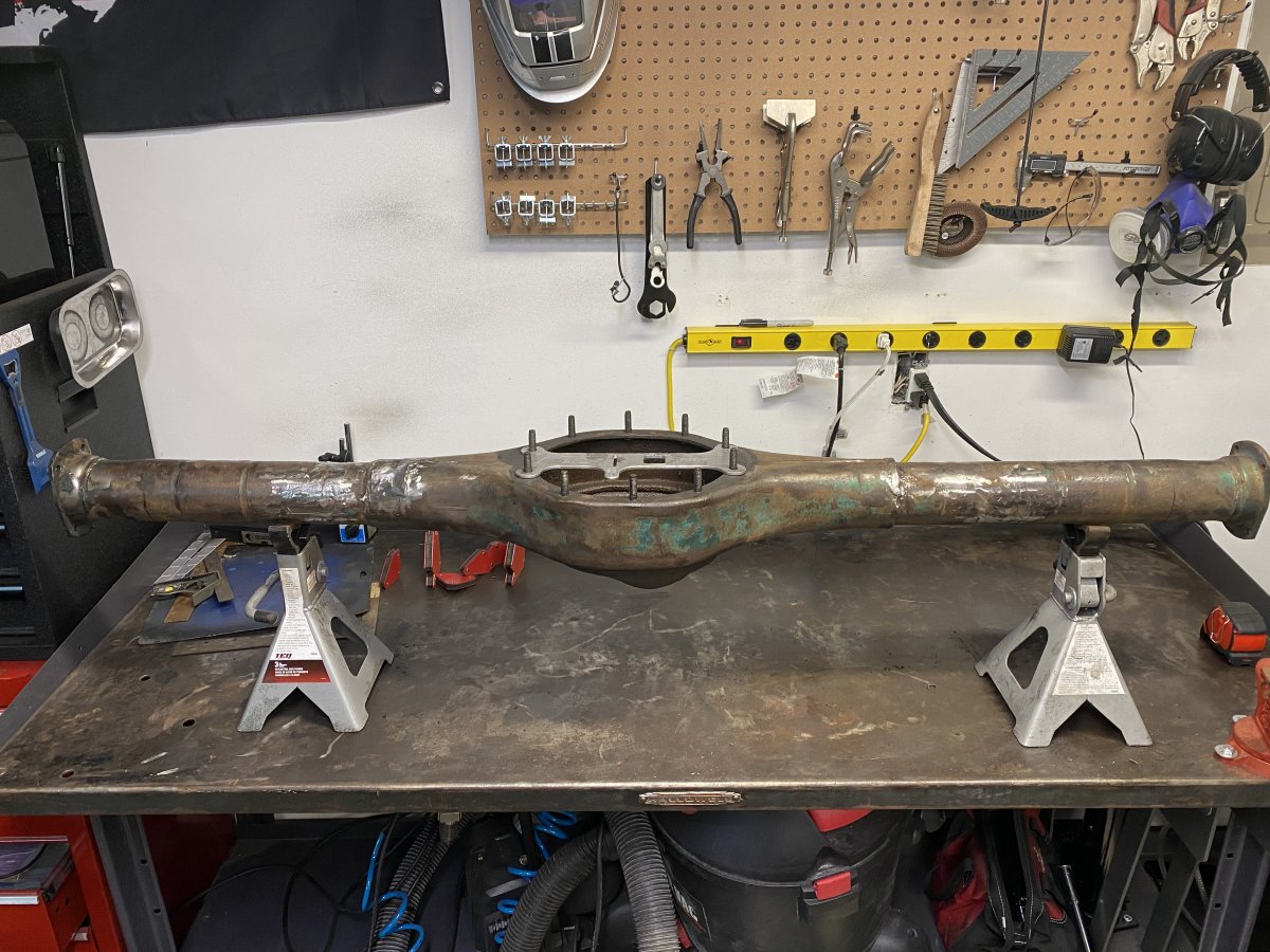

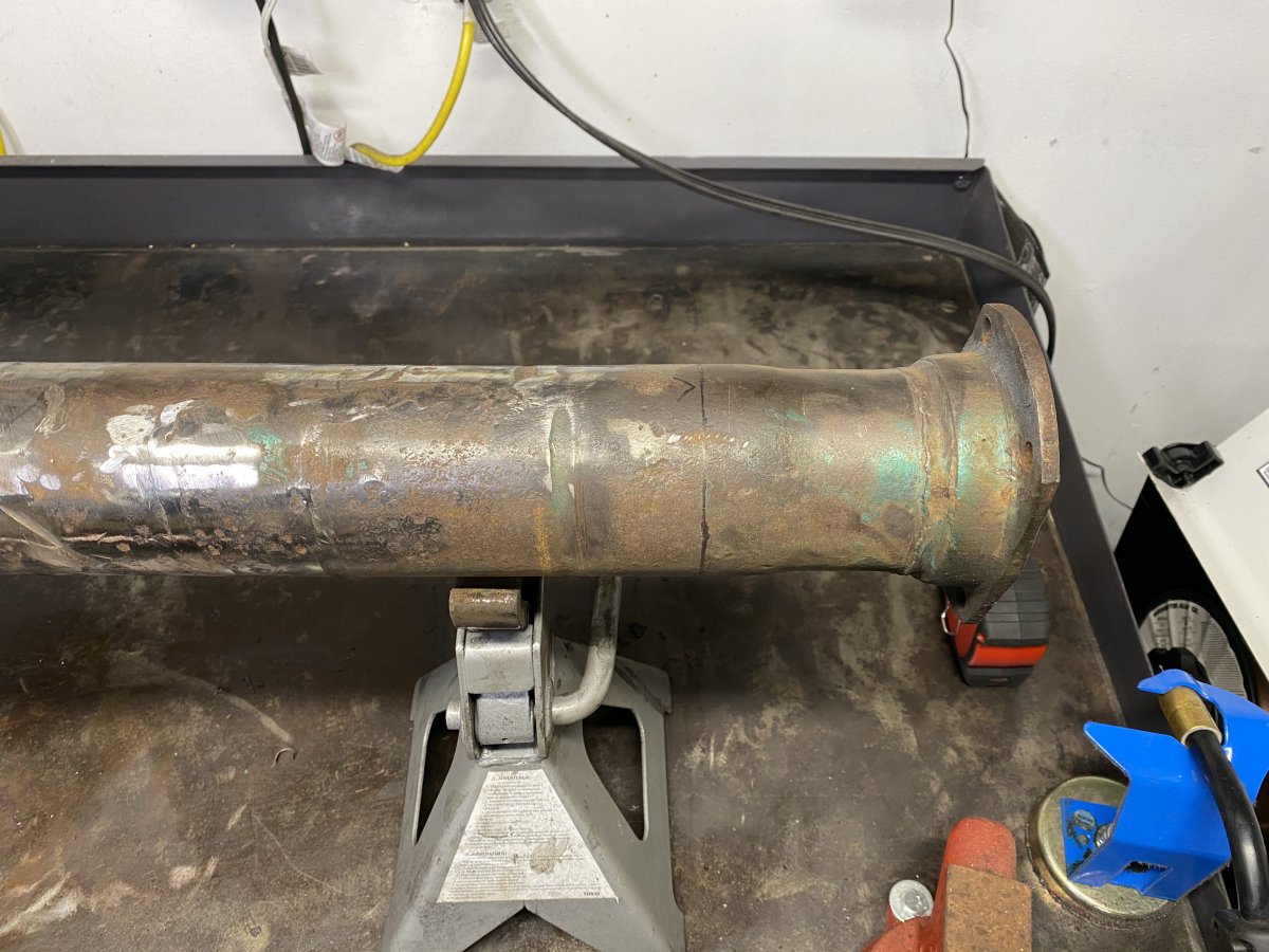

To narrow the axle housing I bought some alignment pucks for a Ford 9” on eBay. Then I went to a local metal supply and got a 60” long piece of 1.25” diameter solid bar stock (1018 cold rolled steel). After cutting off the desired amount from either end of the housing you put the pucks in the carrier and the housing ends to align everything. The housing was slightly bent which is expected from an older housing. You could tell because the new housing ends on the alignment rod did not line up perfect relative to the housing. It was 1/4” off in some areas. Based on a few YouTube videos I tried heating the housing with an torch and quenching it to get it to bend in the direction I wanted. I can provide more specifics if anyone is interested. I also tried bending it with a bottle jack and chains. In the end I got it to within 1/8” on either side so I was happy with that. Using the alignment rod suggests the axles should line up like they should to function properly even if the housing it’s self is slightly bent.

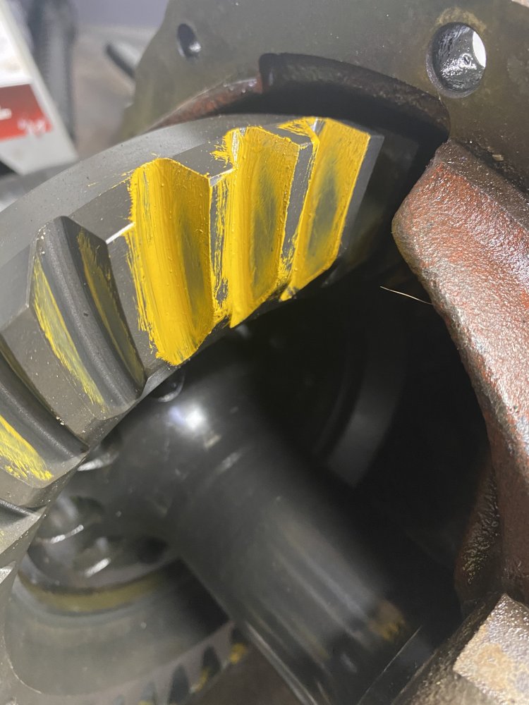

I finished up the ring and pinion install on the carrier tonight.

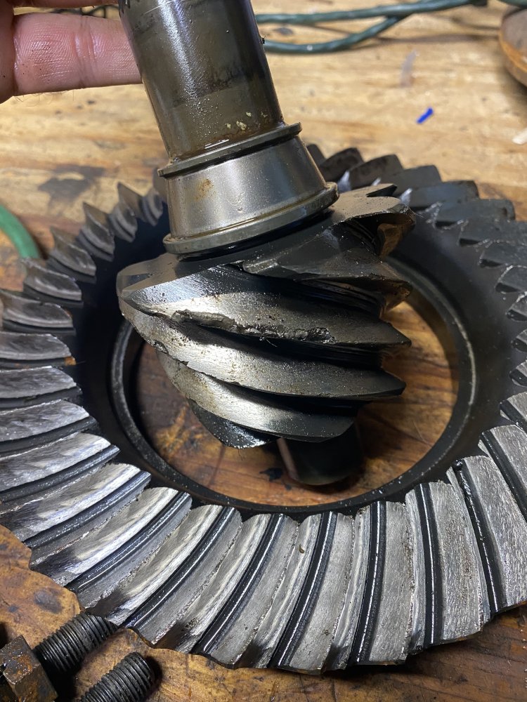

Here’s a pic of the old rig and pinion. You can see chipped pinion teeth and the ring gear wearing away. Some one did a terrible job setting it up. No shims anywhere and they used the pinion pilot bearing retainer as a spacer in the pinion carrier.
4x4 SAS 5.0 dump truck build
my final pattern. I think it looks pretty decent compared to what I’ve seen it should look like. This is my first time doing this so if I’m missing something please advise.

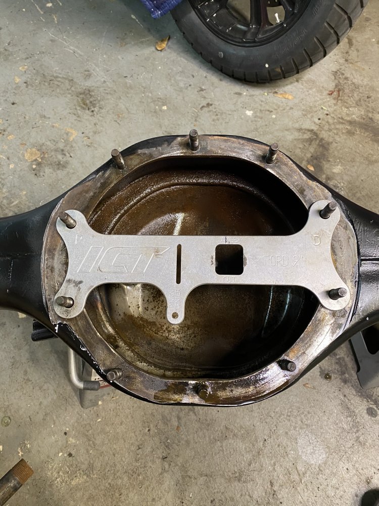

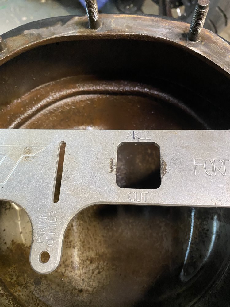

I got the axle shafts cut to length today. I only had to take about an inch or less from each axle shaft. The cut guide tool below has been really useful throughout the whole axle narrowing process to take measurements from.
ICT Billet 9" Rear End Axle Tube Narrowing Cut Guide Rearend Pinion Dogbone Tool

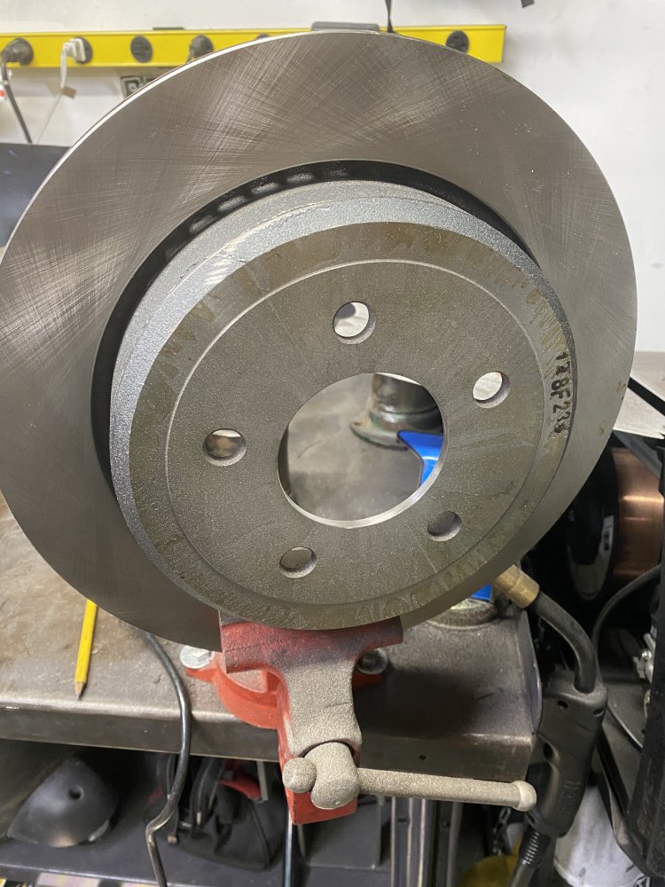

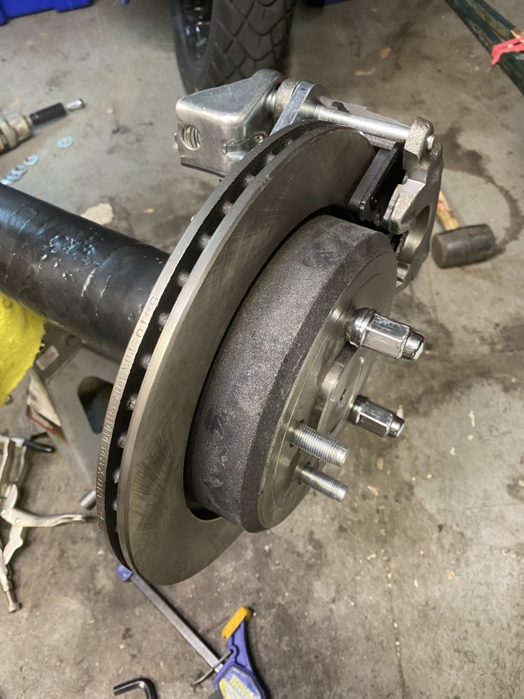

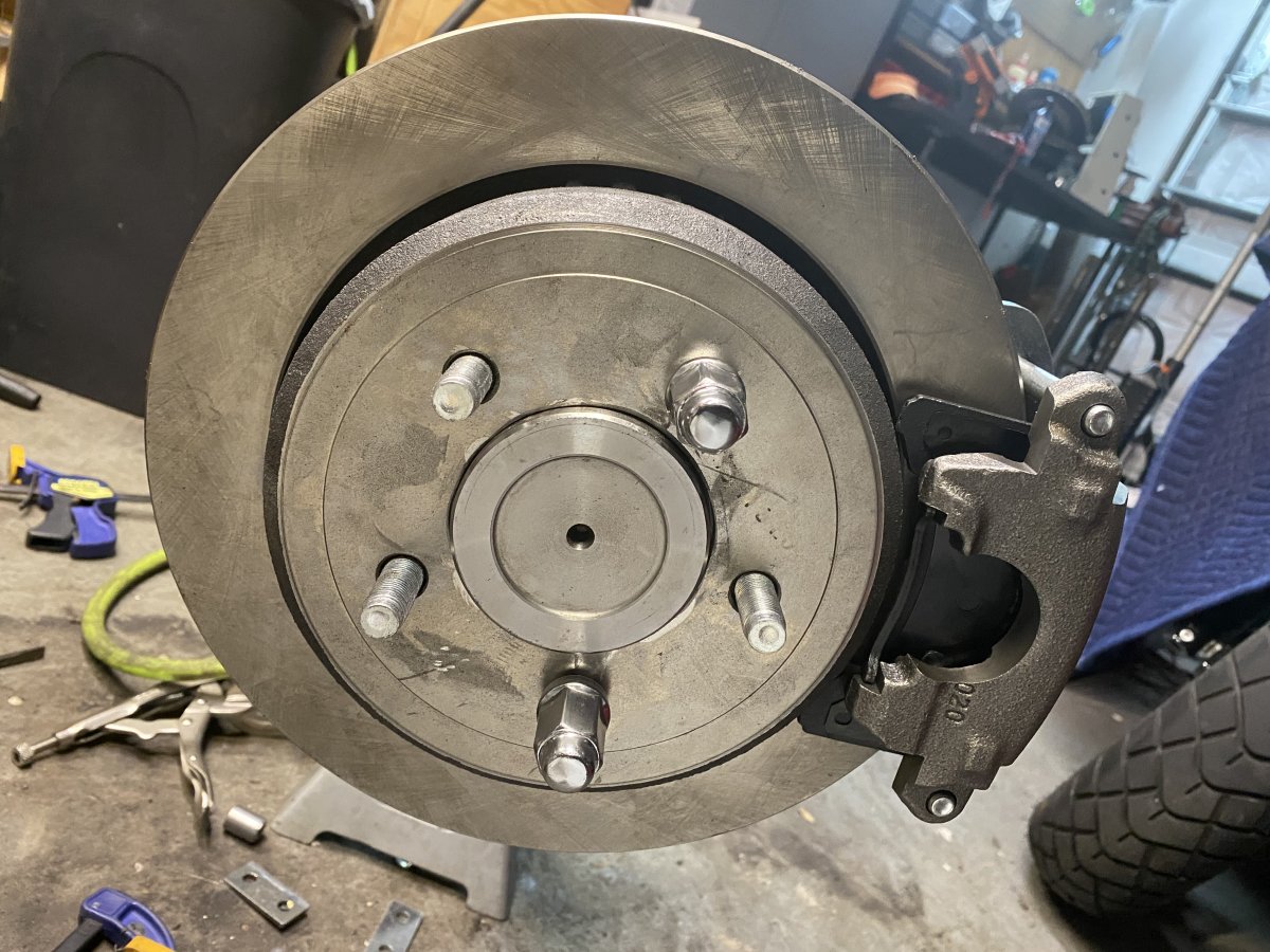

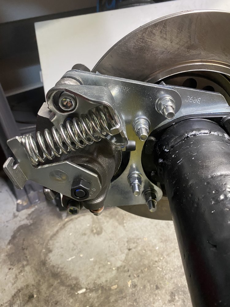

The axle shafts I ordered ended up being a different bolt pattern then I thought. They accommodated multiple bolt patterns: 5x4.50/5x4.75/5x5.00. Well when I ordered them I misread that last size for 5x5.50. As such I ordered a 9” disc brake conversion kit with a 5x5.50 rotor. So I was a little mad at myself when I discovered 5.50 was a 5.00 bolt spacing. Ultimately I decided to keep the axle shafts and go with the 5x4.5 pattern and bought a set of front rotors for a 2003 Crown Victoria. I went with these because of the 5x4.5 pattern then other dimensions were close to what I needed except for one... The center register of the axle shafts (I’m not sure if that’s the correct term - the round thing in the middle of the bolt circle?) is 3” in diameter and the crown Vic rotors has a 2.78” inner diameter. So I have been going round and round with a Dremel and die grinder to open up the center of the rotor until it slips on all the way. One side is complete so far.

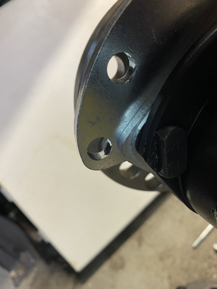

The dis brake conversion kit has been decent. It’s one of the universal kits from speedway motors. The instructions could be better. And I had to lightly modify the aftermarket bearing retainer and a couple of the caliper bracket spacers to create the clearance I needed around the axle housing flanges to get things to bolt together nicely.

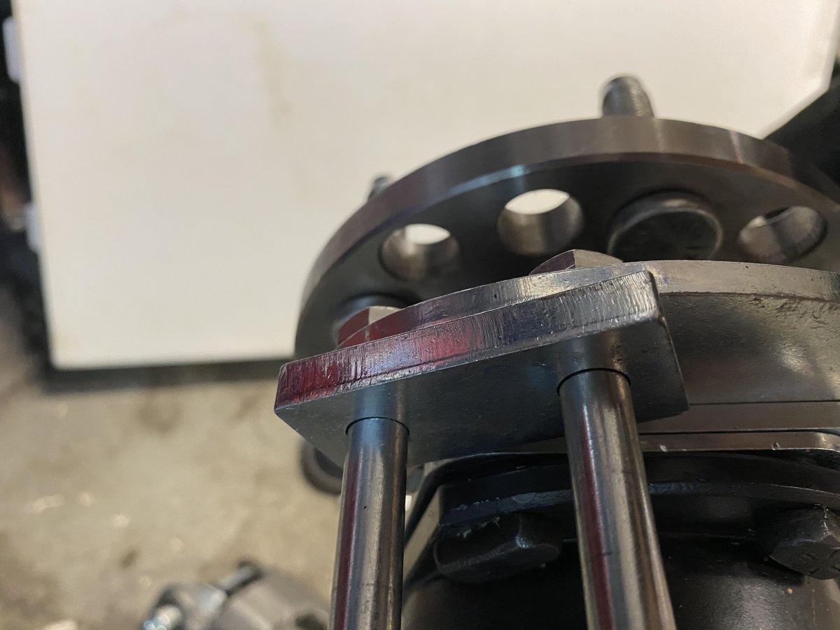

you can see the bearing retainer sticking up past the spacer and the flange here. I ground down some of the excess of the retainer to make it flush with the spacer and flange.
Here you can see how the caliper spacer wants to over lap with the flange. It’s a little exaggerated from the angle.
This is a test fit of the spacer after grinding away a little on the side.
This shows how much I took away from the side compared to an unmodified one

This is my rotor work station for opening up the center hole.

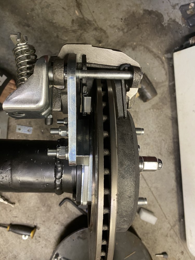

the rotor finally sliding on and some shots of the brake setup
