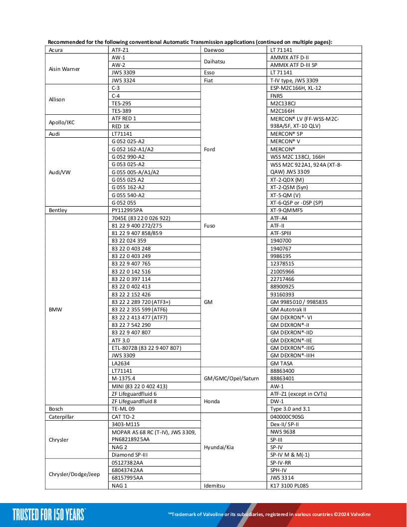

Valvoline Multi-Vehicle Full Synthetic ATF. Here's the compatability listing from the product information sheet and Mercon V is on there.
Based on my studying, it had been used successfully by a lot of people in the 4R70W. In addition, with recommendation, I added a bottle of the Lubeguard Synthetic ATF Protectant which is also supposed to help with high mileage transmissions.
