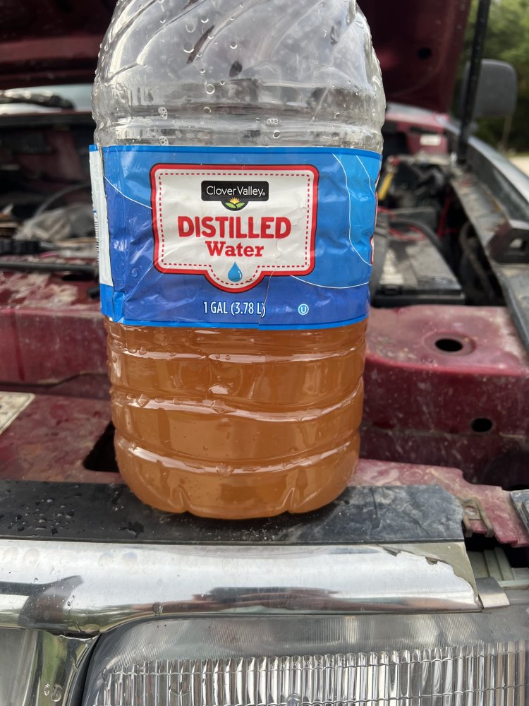

Sample from flush #6 is looking much clearer in person. But I’m definitely doing more flushes tomorrow and the next week or so.

I've had to fill, run and drain 6 to 9 times before for a neglected cooling system that's really gunked up.
Are you draining it with the petcock on the radiator? That moves the coolant real slow. a higher drain flow works a lot better for flushing the crap out.
What I do to flush mine is to run the truck, then let it cool off and CONFIRM that the system isn't pressurized any more.
Start the engine, for just a few seconds (this freshly agitates the coolant).
Loosen or remove the radiator cap ( this lets air displace coolant, and verifies that the system isn't pressurized )
Then pop off the lower hose at the radiator.
The coolant will puke out, carrying a lot more crud out of the system versus the petcock.
It helps to break the lower hose loose beforehand, and treat the inside where it goes over the radiator outlet with silicone. The clamp will still hold it fine, and it'll be easy to pop off for the flush after you've loosened the clamp.
Just use common sense and be careful.

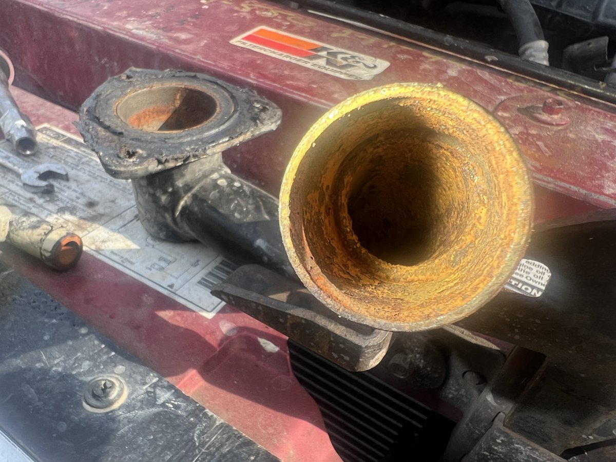

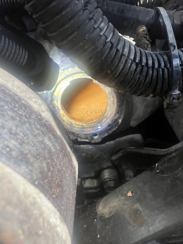

I flushed the heater core both directions a few times. Pulled the thermostat tested it and it passed, also shot water through the water pump until it came out the thermostat hole. Nothing crazy came out that I could see, and fresh water is flowing out now. There is just a ton of the orange slime buildup in everything, even the fairly new (1.5year old) radiator hoses and thermostat neck. I guess the only way to get that stuff clean is many more chemical flushes.

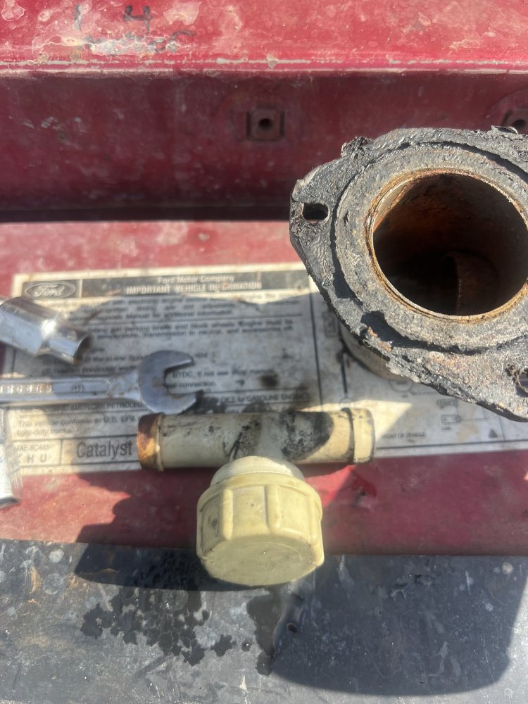

Also found this T fitting spliced into the heater core hose, I thought it was a shutoff valve but it appears to be a port to flush from or idk. This can’t be stock right?

it definitely looks like one of those kit parts that you could get at walmart that lets you flush a system
Probably gonna delete it, gotta see if I have enough 5/8 silicon line in my stash to replace them both.
It may take weeks of multiple plain-water or light chemical flushes to get the coolant to look acceptably clear.
But go conservative on the harsh flushing chemicals. If you overdo the chemicals you could end up with leaking freeze plugs. They're not thick metal to begin with, they've pitted over the years, and nuking the motor with too much flushing chemical could open a pit into a pinhole.
It'll take multiple flushes. That's another reason I pop the lower radiator hose; it makes the flush process much faster.

Uhg I somehow forgot this, but the top right thermostat housing bolt just spins and never gets tight, and the top left one goes in sideways as a mofo but does eventually get tight. It’s not leaking, despite putting the gasket but no thermostat in. After the flushes when I out the thermostat back in I’ll have to try to retap the holes, probably have to go bigger on both of them.
