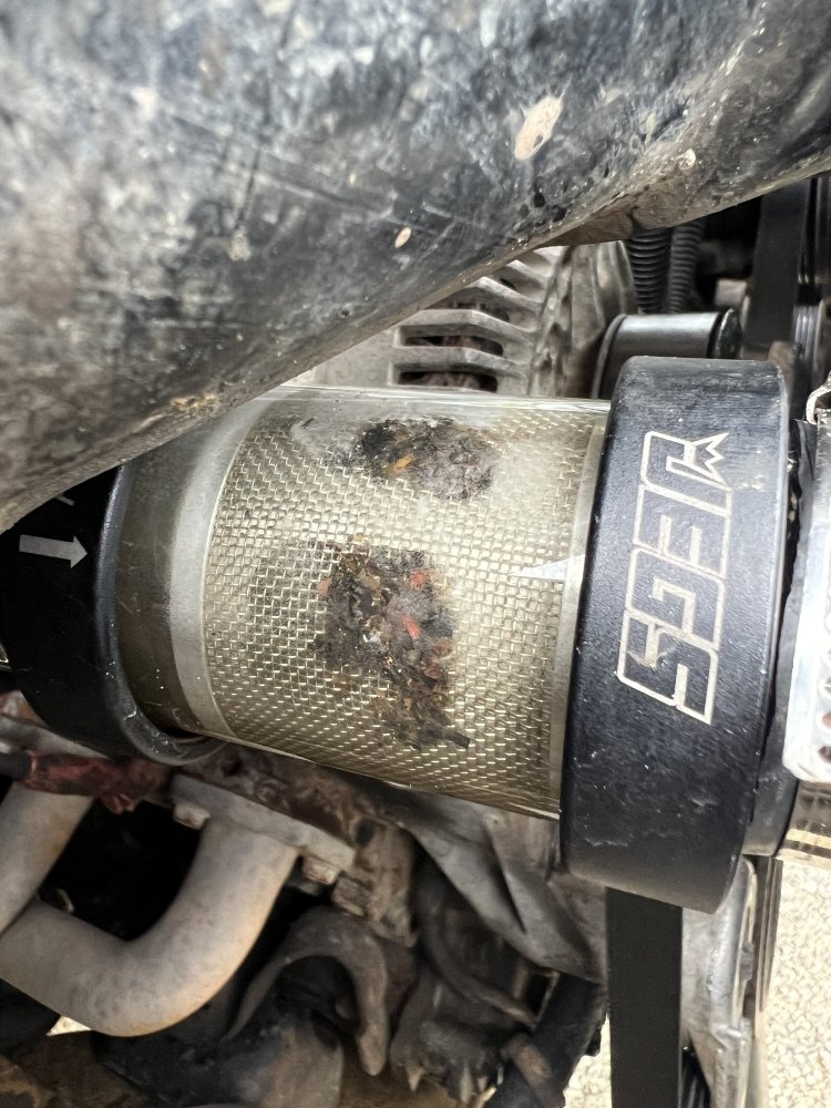

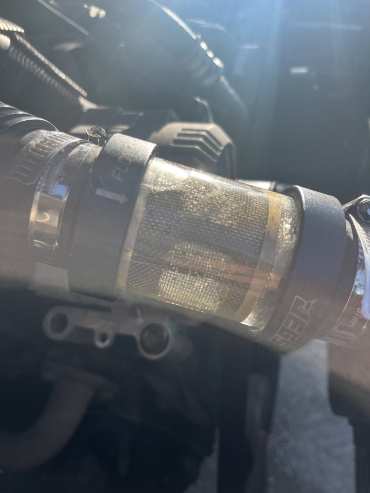

This filter is pretty cool, this was from my commute today. I cleaned it out and flushed the system again with fresh water today. Tomorrow I’ll go grab more evaporust and do another few days with that stuff. It seemed a little better today I did a long hard 3rd gear pull up to 4,500 then a little into 4th. It did get to halfway on the gauge during that but it recovered almost immediately which is a big improvement!

Been following, you're dedication is inspiring. Thanks for that. My favorite cleaner is what ever dollar store 'Tub & Tile" cleaner I can put my hands on. Currently after pulling the lower radiator hose for some in line temp sensor splicing, finally got a decent flush. So I kept up with it for a day after. Why not. Keep up the good work.
Thanks! I like experimenting and I very much dislike things getting hot when they shouldn’t be. I’ve driven a lot of crappy vehicles and never had such a bad cooling system.

Also the rust dissolved seemed to have a lot of very small particles in it when drained but it can’t have done a ton because there’s still small chunks being caught in the inline filter.

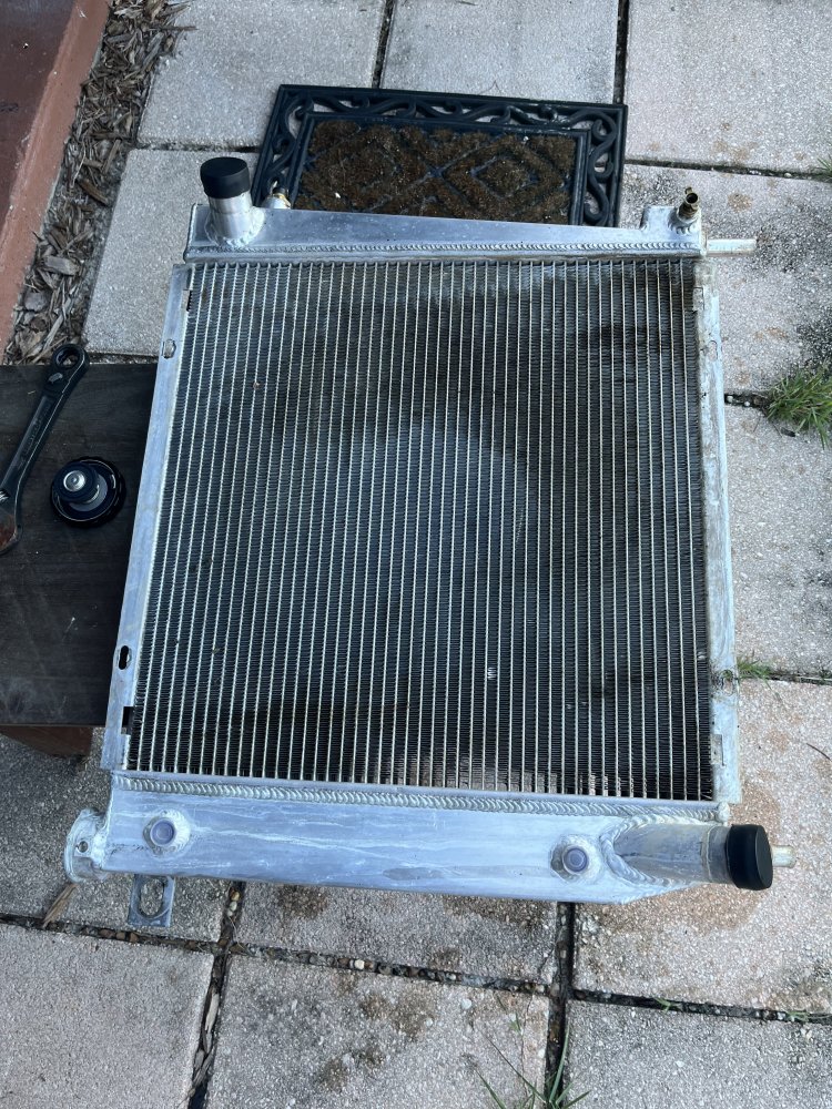

Just slapped a brand new radiator in and burped it real good. I let it idle for nearly 30 minutes with the fan OFF and it didn’t even get to the N in normal. Went for a rip down my sandy road and after two or three short runs never going above 3k but mostly staying around 2,500 It got very hot like usual, past the L in Normal. Did a good 10min cruise around the block and it cooled down a little but when I got home the thermostat housing was still reading 225* on my IR thermometer, which matches the gauge reading between M and A.
So clearly it wasn’t the radiator and I spent $300 for no reason. Also worth mentioning is that the water currently in the system comes out clear and clean, and the pre-radiator rust catcher filter is not even catching chunks. So the rust in the block or heater core or whatever problem is gone, but the radiator being clogged with rust isn’t the issue.

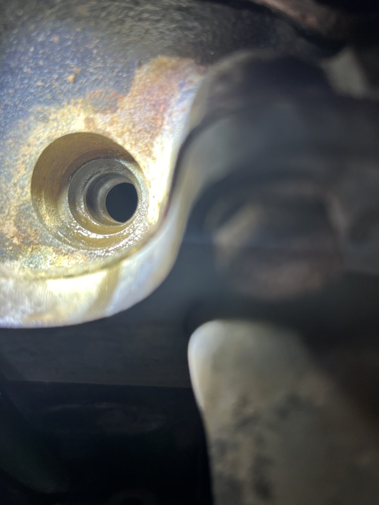

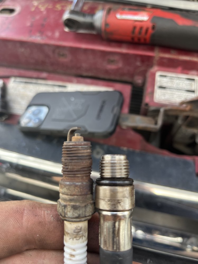

Unbelievably annoying is that the threads for the plugs are deeper in the head than the leakdown tester can catch. So I gotta go try to find some sort of adapter that’s got longer threads or I can’t do a leakdown test like I planned. These plugs are only a couple months old, and my god they look horrible. I’m definitely thinking this thing is toast. I run a fuel cleaner in every tank I never imagined they would look this bad.

Define horrible? Oil fouled, burned off, ?

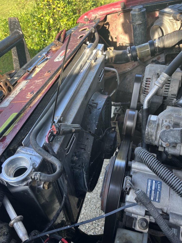

Alright I wheeled this thing for 6 hours today in 95+ temps and got some interesting data. I can creepy crawl trails, blast down sandy roads, or drive highway speeds with the AC off and the truck stays ice cold. But during any of those scenarios if I turn the AC on within 5-10mins it starts to slowly heat up.
So this isn’t a motor issue but an AC issue?
Condenser getting hot? It’s only 2 years old, the whole system is 2 years old.
Maybe over serviced and causing condenser to get hella hot?
Maybe condenser needs a front pusher fan?
Condenser and rad too close together? Or too far apart?
