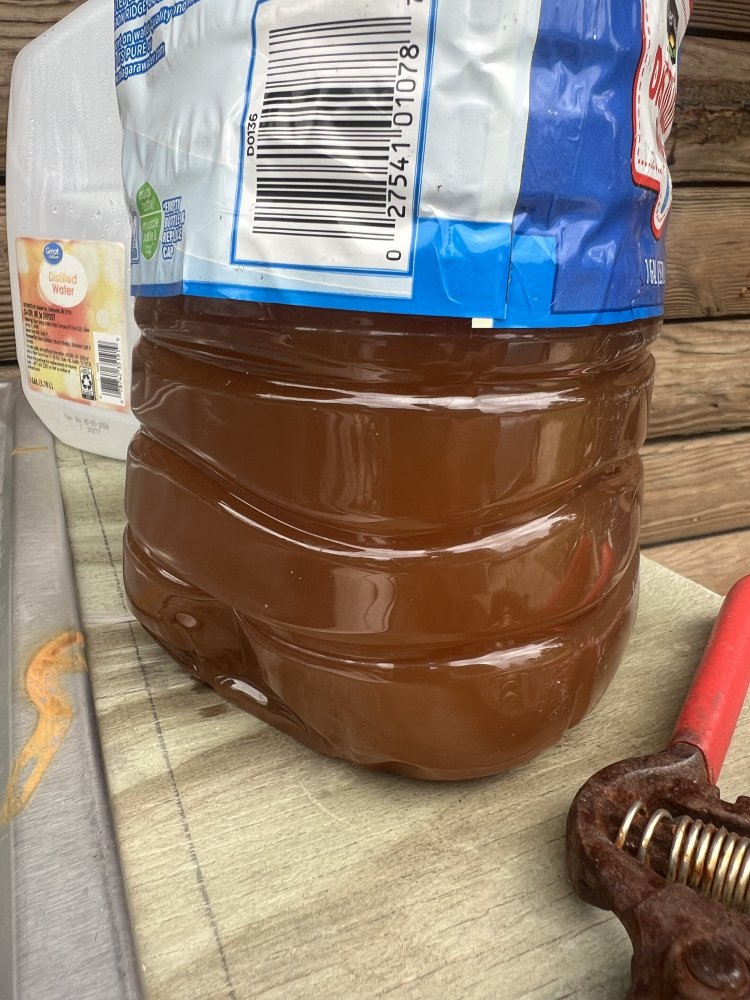

Even after all the hosing this is what came out after 15miles of driving.
