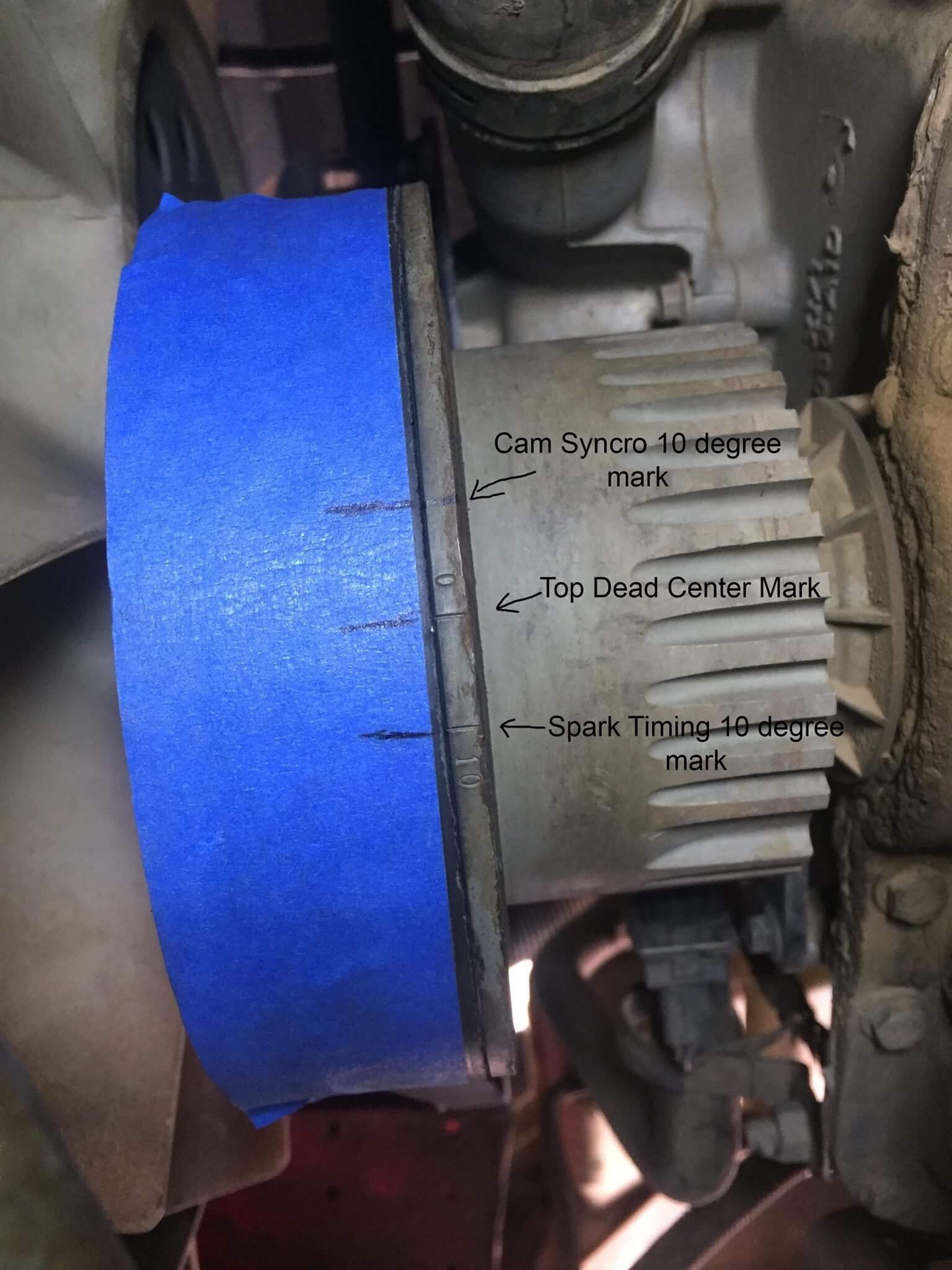

That mark is 10deg BEFORE TDC, its for spark timing, you want 10deg After TDC for synchro
So that same distance but ABOVE the 0 mark in your picture
Oh thank you Ron!! Did not know that!!! I'll be sure to make the same distance with tape on the other side of 0 and measure it and confirm it at 10 degrees. Haven't stabbed it in yet since the new syncro I took out has some play in it. The old one has a lot of play in the shaft and the new has a little. I don't know if I should risk putting a syncro in with shaft play. Better to buy a brand new one and return my old one?

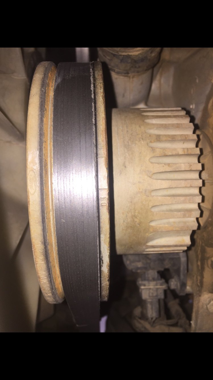

Just to be double sure so i do this 100% correctly and to provide reference photos is this photo correct Ron? I have to line up the needle on top of the crank to the line that I drew, not the line thats on the crank correct.

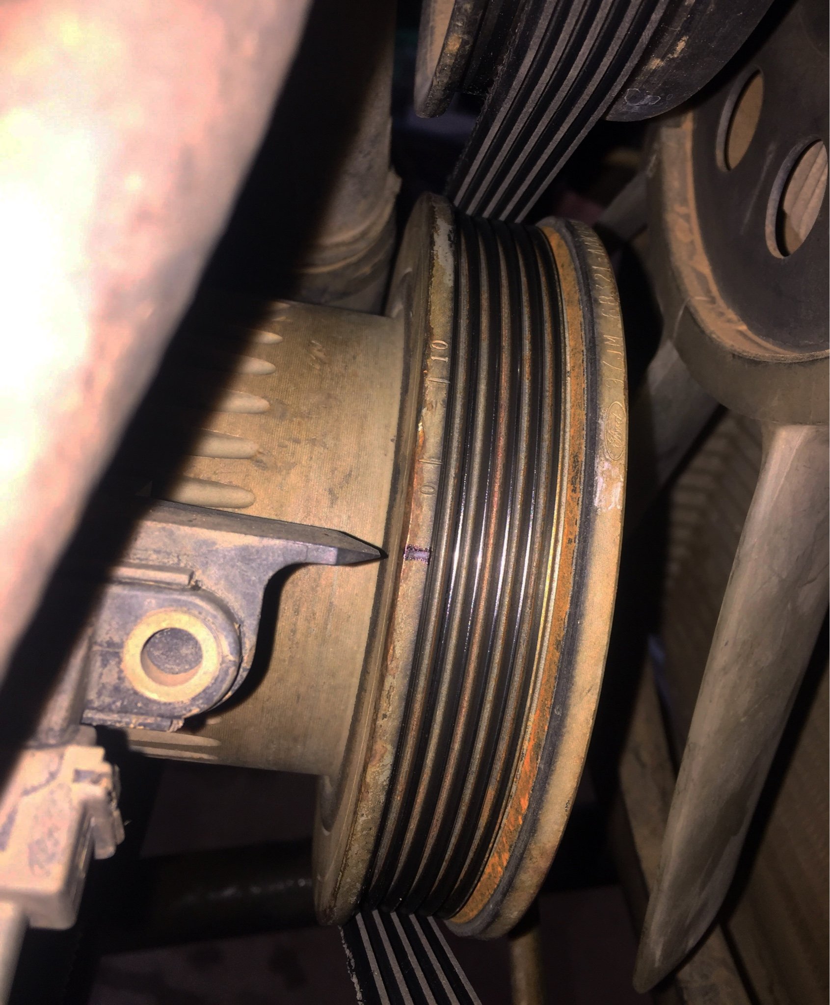

. Lines up with the sensor correct? Passenger side of the tdc line
Yes, and thats on the COMPRESSION STROKE of #1 cylinder
Or it will be 180deg OFF
