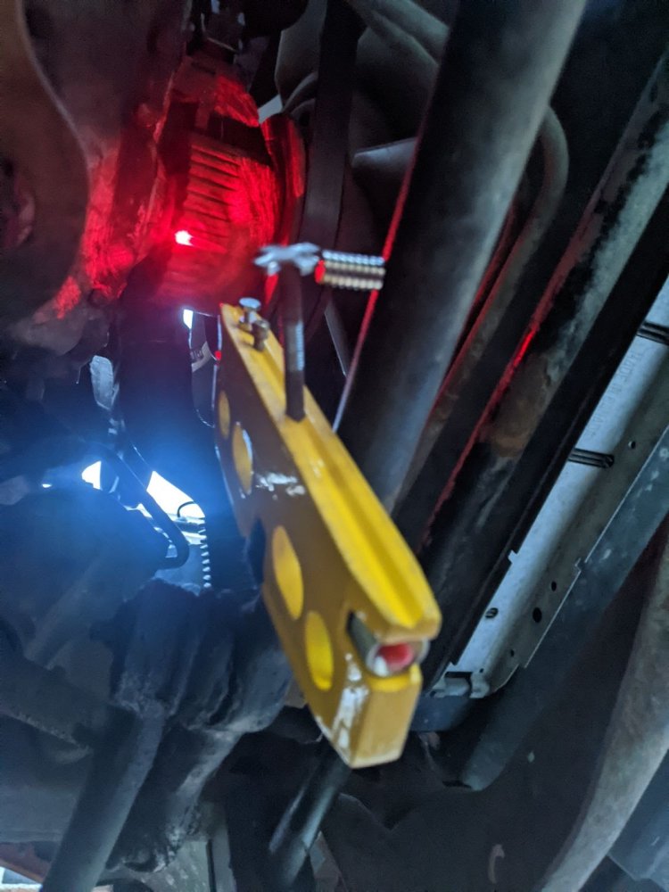

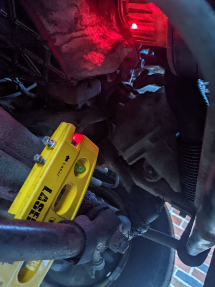

I am working on a 1997 Ford Ranger XLT 4.0 liter OHV engine and trying to perform a cylinder leak down test on each cylinder. I have the firing order for my engine as, 1-4-2-5-3-6.
Compression readings from the compression test were the following:
Cylinder 1 175psi
Cylinder 2 170 psi
Cylinder 3 165 psi
Cylinder 4 150 psi
Cylinder 5 175 psi
Cylinder 6 165 psi
I am just trying to run a cylinder leak down test on each cylinder. I believe I can find cylinder one TDC, easily, but I get lost from there... Should I just simply count four notches on the harmonic balancer to get to cylinder 4 TDC from TDC of cylinder 1?

The Tone ring/reluctor wheel has 36 teeth - 1, one tooth is missing, pretend its there, lol
120 deg is 1/3 of a circle(360deg)
36/3 = 12
So you would rotate the crank clockwise 12 teeth from #1 TDC Compression stroke to get to #4 TDC compression stroke, then 12 more teeth to #2 TDC
Then 12 more teeth and you should be back to TDC mark on crank pulley to test #5 TDC
Then 12 more for #3 and 12 more for #6
Its a 4 stroke engine so crank spins 2 full turns to complete one full firing order sequence
