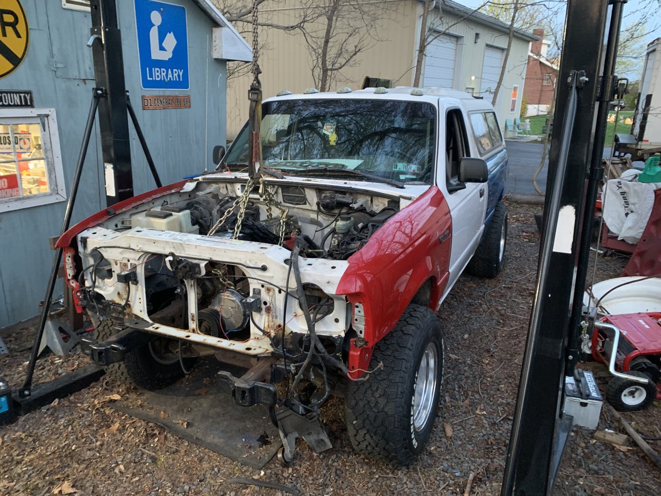

Currently working on my 300 swapped 1998 ranger named “rocket pop” posted a bit in the “ford six” forums but figured I spread out to other forums.
My name is Ethan and I bought this 1998 ford ranger 2wd with 70,000 miles on it, found a red front end, and a blue bed of my old ranger. Lifted it 2 inches. Drove it awhile and melted the wrist pin out of a cylinder and decided I throw my favorite motor in it.

I've seen one other 300, running, but in an older ranger. How far have you got?
300 straight six is my favorite engine as well - I assume you had to go electric fans, no room in front... did you have to remodel the firewall?

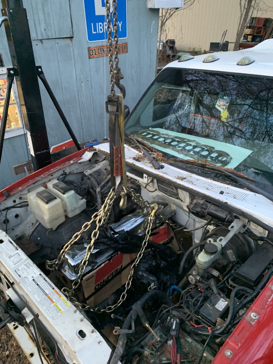

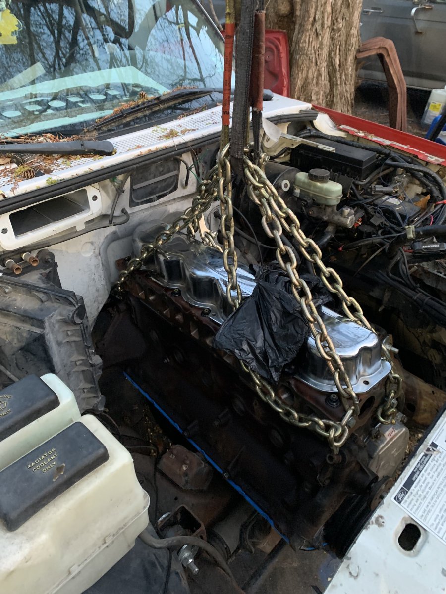

so far I have gotten the engine about were I wanted roughtly. got the front rad support removed and tomorrow I am going to bolt the transmission on tomorrow and get it in the truck and see how she fits.
yeah I going electric fan route for the radiator. today I got the engine about were I would like it. tomorrow the transmission is going to go on and I will see how much remodeling on the firewall I will have to do.

yes I did. bought it off of marketplace and rebuilt it new bearings, rings, gaskets. The guy before me put a cam in it. I have a 4 barrel and EFI system for it. Efi manifolds. the head was reworked with bigger valves. should be a rowdy little motor.

Where are you planning to install the radiator ???
I'm surprised it fits but robust engine. Great idea.
It will definitely be interesting to see how you make it work. A straight six is a long engine for a Ranger engine bay. Good luck and God speed!
should fit right in front of the motor got an electric fan so that saves space.
