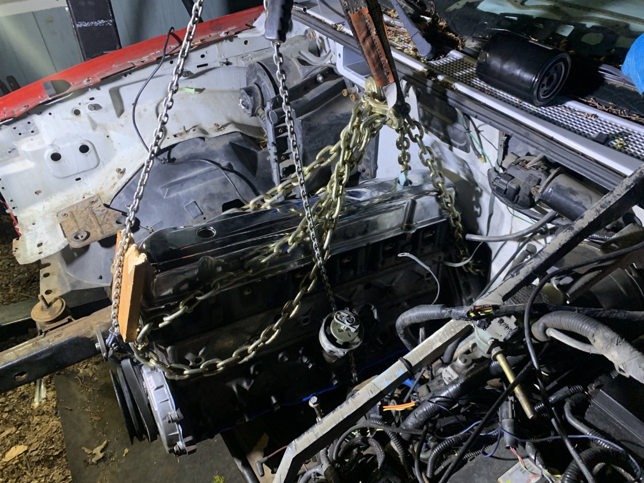

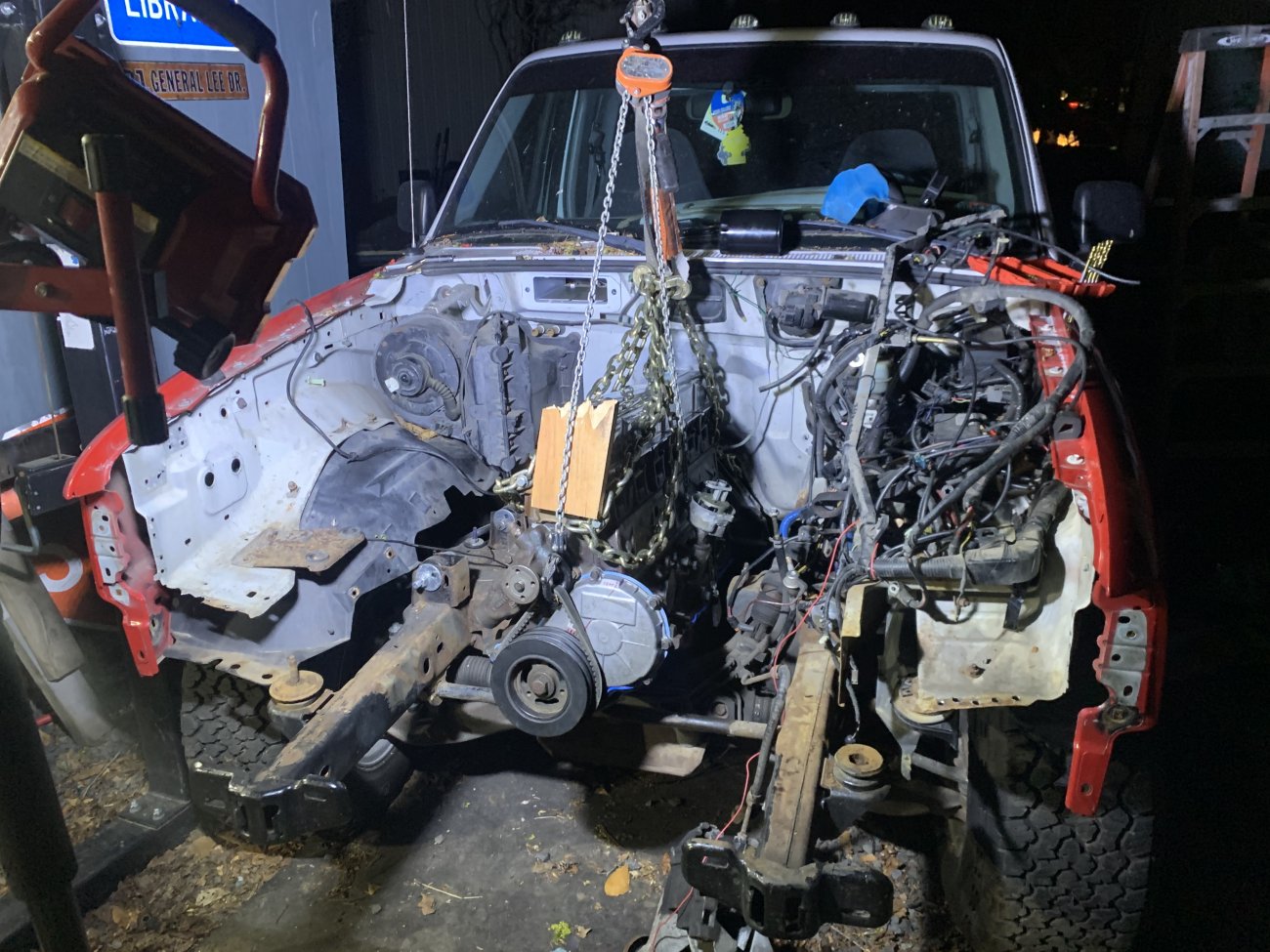

It will definitely be interesting to see how you make it work. A straight six is a long engine for a Ranger engine bay. Good luck and God speed!

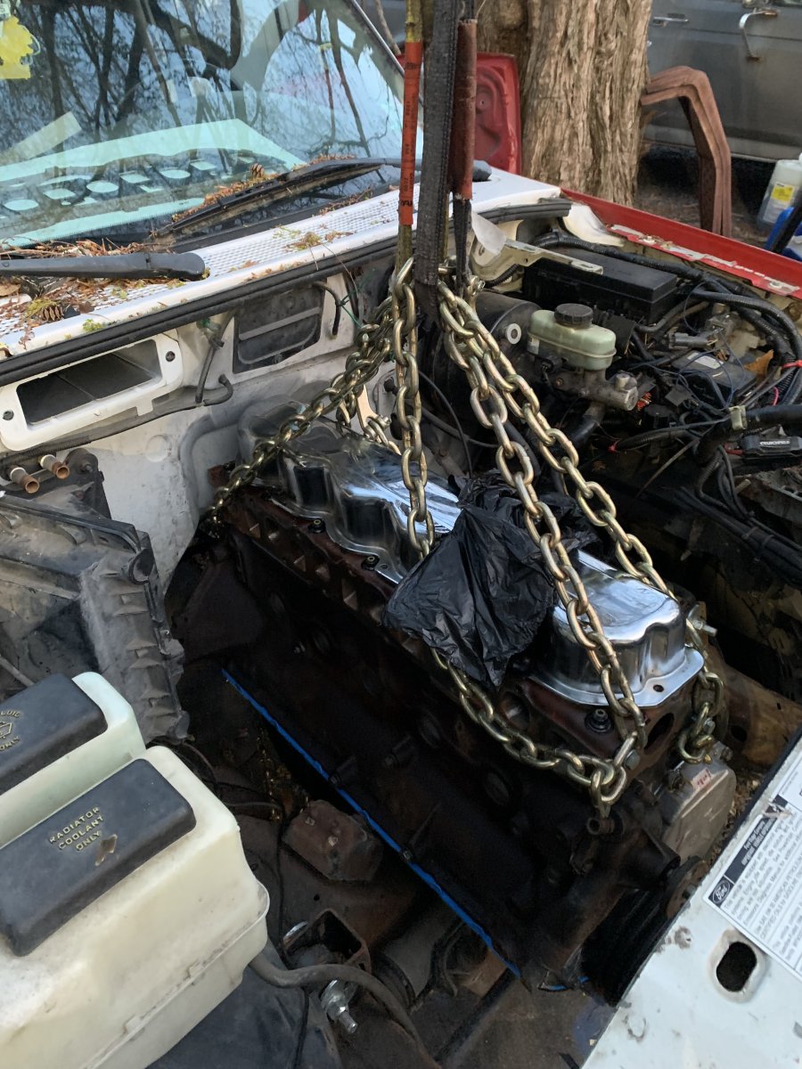

Thank you! I am pretty impressed with how it is fitting.
in the engine bay with the transmission bolted to the motor. Drilled the spot welds and got the front rad support removed

I know a couple people were asking in another group so I figured I should bring you up to speed on the other things I have done.

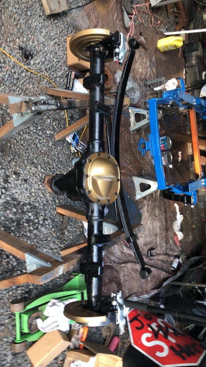

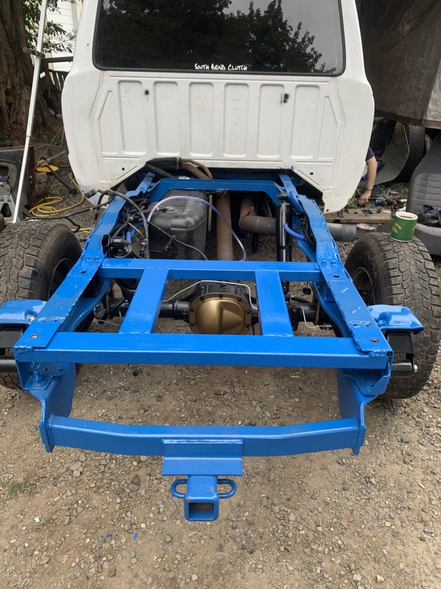

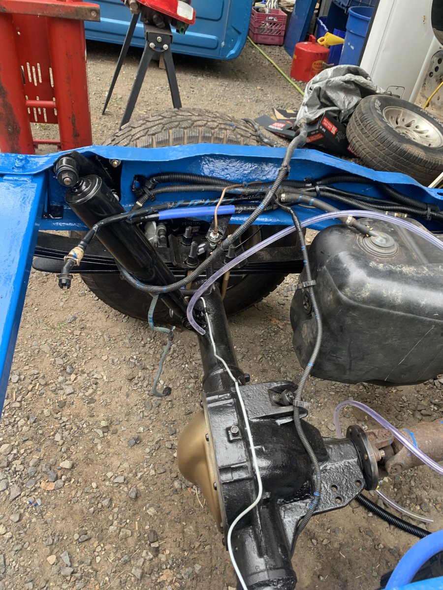

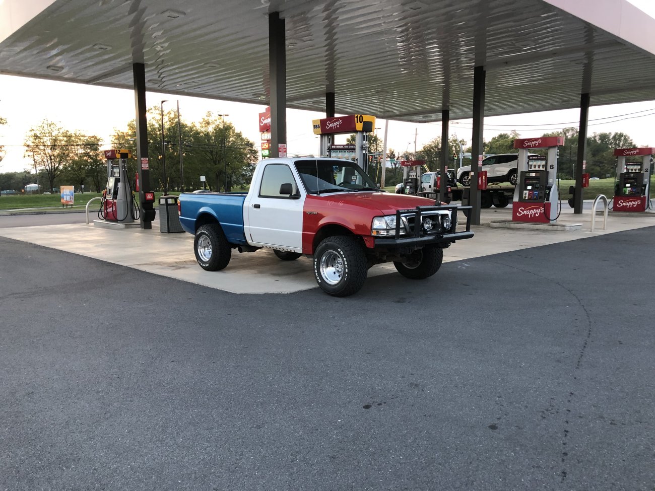

I bought it, it was all white 1998 Ranger 2.5 2wd base model truck. Passenger fender was a 2 tone panted matte white and the hood was all bent up. went to the junk yard and got a full Red, Hood and Fenders. Also a Bumper off a square body chevy. Installed them over a couple of months. when we removed the bed to add a trailer hitch we found more Rust then I remember when I bought it:)
Did the complete back half of the truck, wire wheel, paint. Rust buster Frame patch panels. 8.8 LSD with Disk brakes and a 3.73 rear Gear out of an Explorer. Used the bed off of my old 1993 ford ranger bed. that I wrecked in high school
Put some 15x10 wheels and 2 inch lift in the front and drove it for a few months until I melted a wrist pin bore in the 2.5 and thats how we ended up where we are today.

Nice work. Never noticed the red, white, and blue colors before...
