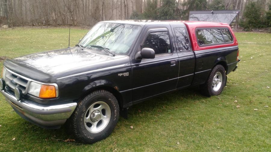

Hey there! New to the site. I've got a 95' 2wd xlt ranger with an auto trans and posi 8.8 with 3.55 gears. I've put 265/70r16s on it (about 31" tall) and I have a stock suspension. My question is what should I do to it to get it ready for some overlanding? If that's even possible with a 2wd. Will add pictures when I can. Thanks!

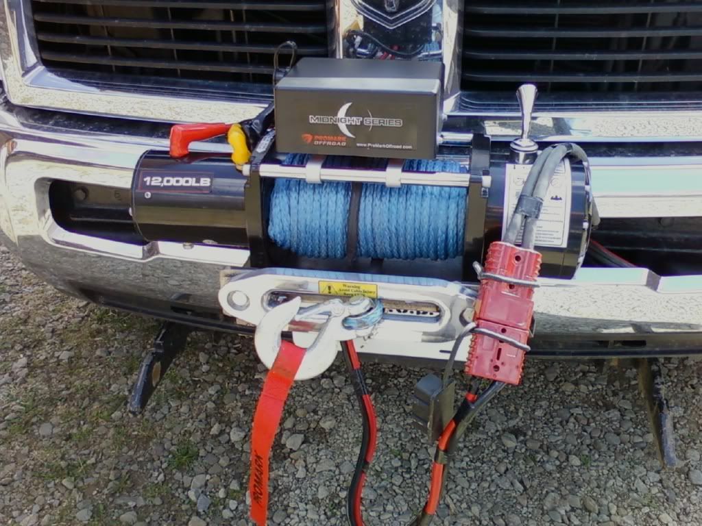

What winch would you recommend?

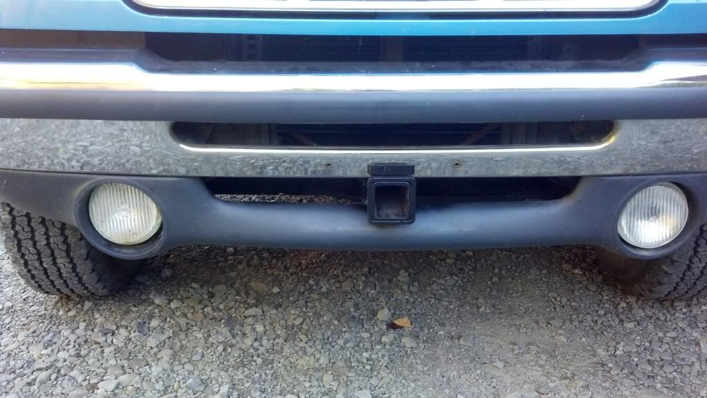

Whatever U can afford. Even Harbor Freight have decent ones. Get an 8,000lb winch, larger is good but they get heavier as U go up. Add a 2" receiver front and rear and wire the winch with a cradle so U can put it on either end.

Here is mine. A local guy welded up one for me. Here is also a pic of the same setup on my Dodge 2500.
2wd overlanding?
This way U can put the winch where it is needed and also carry it inside the vehicle to prevent corrosion and keep it cleaner. I used welding cable to run power from the battery to the red Anderson quick connectors. Lately I've had a problem with one of my connectors corroding badly so keep an eye on those.

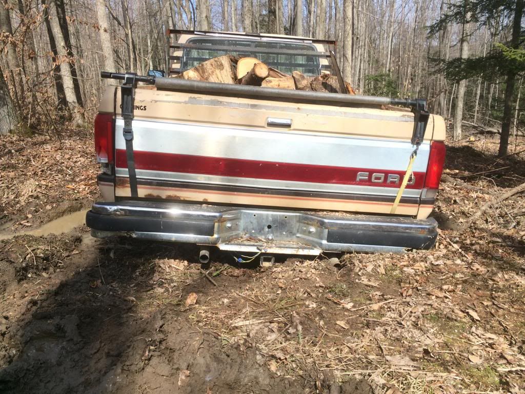

Action pic of little ranger pulling out F150
2wd overlanding?
My 90' F150
