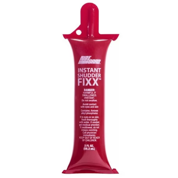

Some have said this will fix it
2021 Bronco Sport : Surging at low RPM
