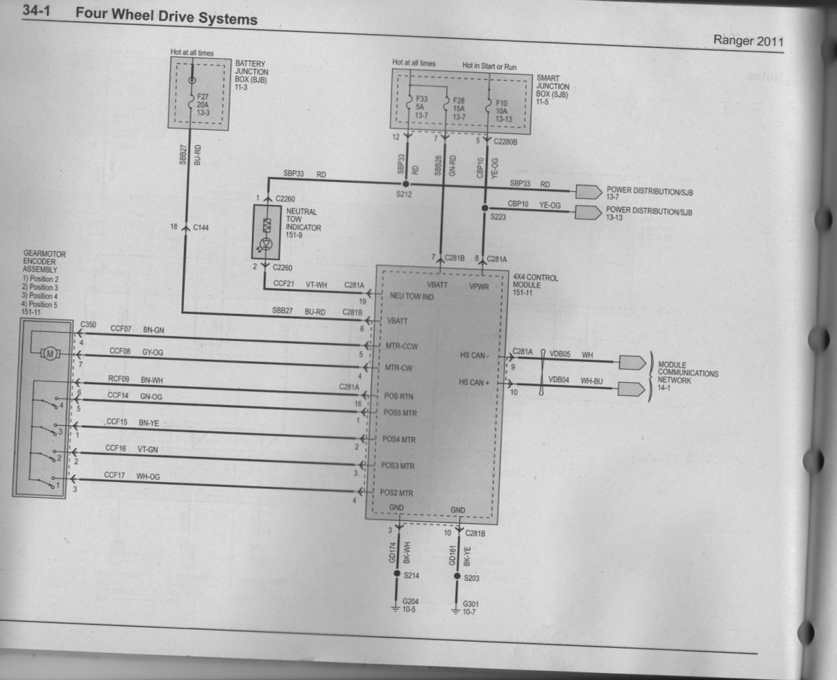

Well, now it has a new trick.
I took the motor off, hooked my bench supply to it, and tried to run it both ways. Turns out, even switching polarity it only goes one way off the bench supply.
No matter. Ran the motor around, stuck it back on the truck, and hooked it up. It wound itself back around to 2wd. Cool. Life signs.
Now, when I shift to 4H, it goes to shift into 4wd, gets there, then returns to 2wd.
I'll upload a video.
