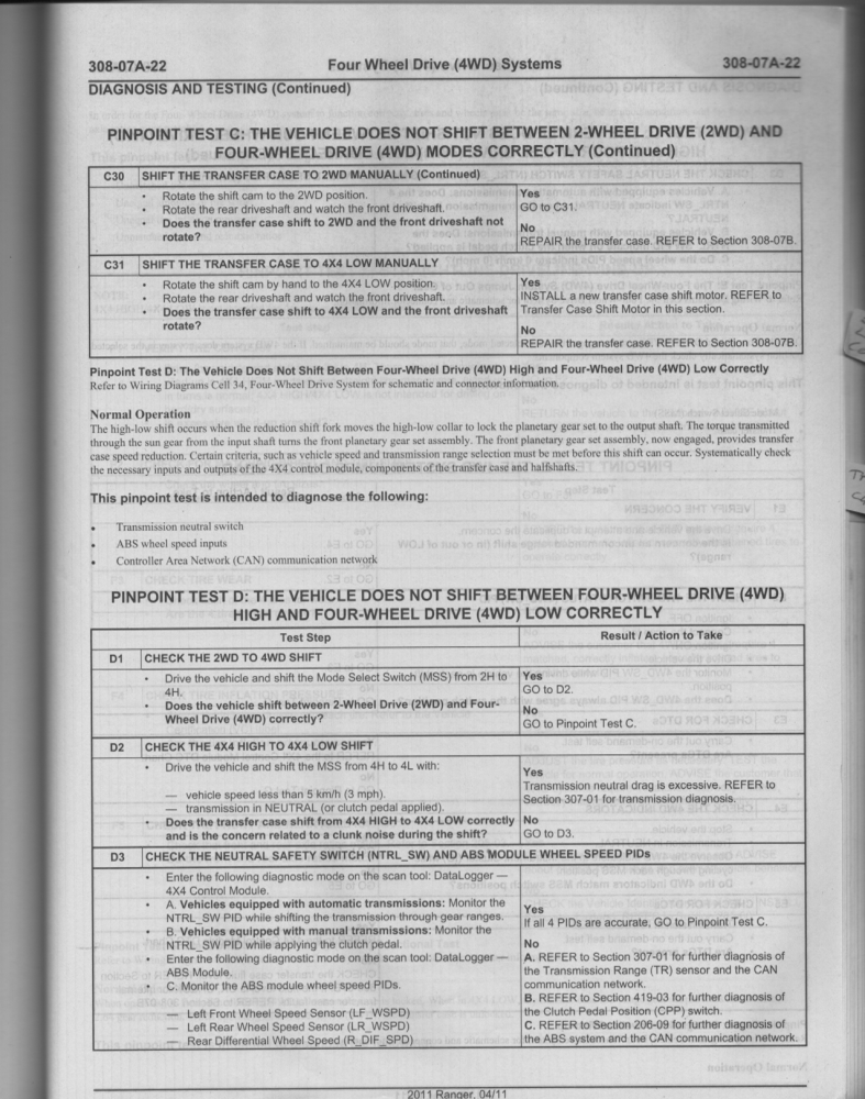

I'll look in the Service Manual and see if there is any troubleshooting information.

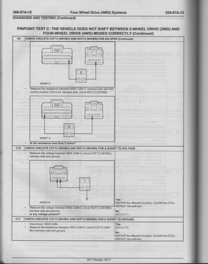

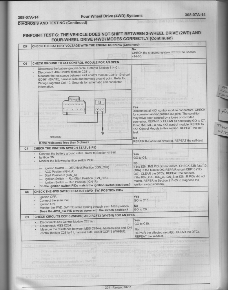

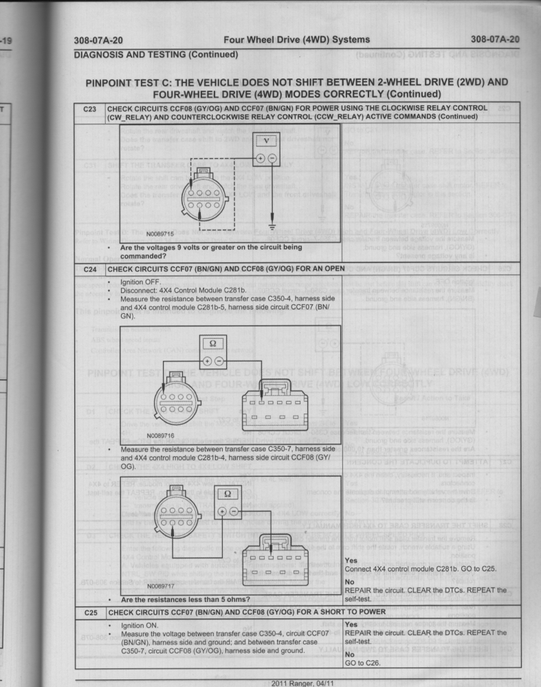

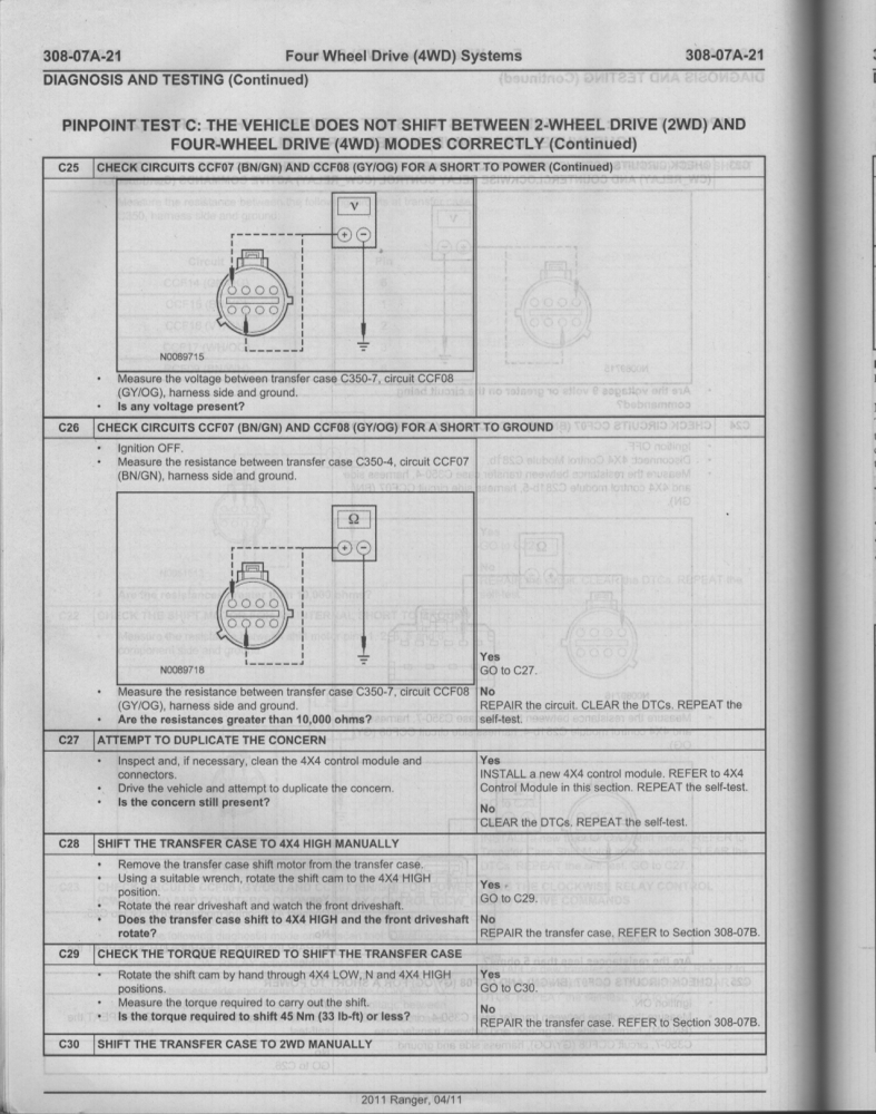

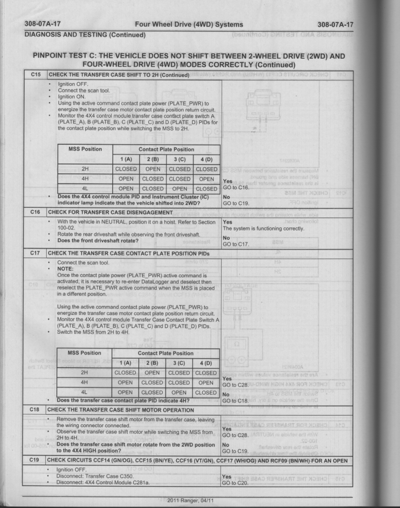

For DTC 1867: Pinpoint Test C
70798
70799
70800
70801
70802
70803
70804
70805
70806
70807
70808

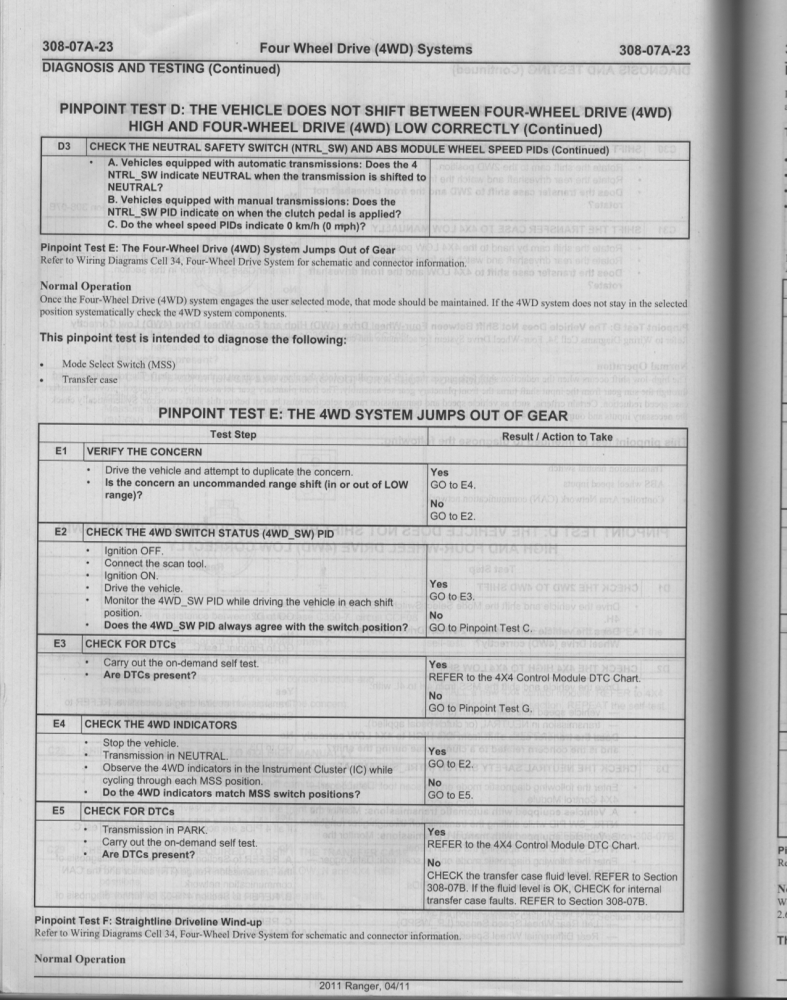

For DTC 1891: Pinpoint Test D
70809
70810
Snoranger was kind enough to bring Parts Catalogs to the meet. Let me know if you need any parts number since I saved the catalog for 2011.
