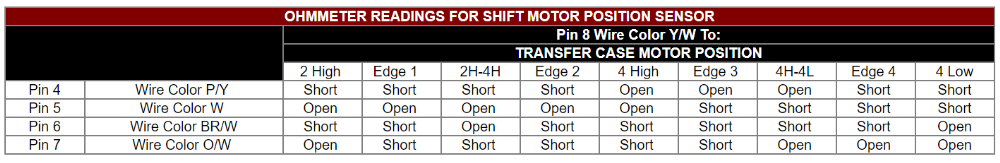

The Controller is not getting info from the shift motor sensor, for position, so it starts to move the motor and when there is no change in the position sensors it moves it back to last "known" position
You could test sensors/contacts using this chart
71366
Not sure wire colors are the same but the way it works is
There is one Common wire, the yellow/white in this case
The other 4 wires are either connected to it(short) or not(open)
4H-4L is Neutral, just FYI
You can manually power the motor to test sensor/contacts to see what Controller sees

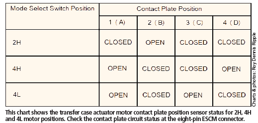

Found 2010 4WD wiring, looks like the brown/white is the Common wire
But thats the truck side of wiring, shift motor harness may have different colors
Found this one as well but not sure what model its for, and it shows different closed and open contacts
