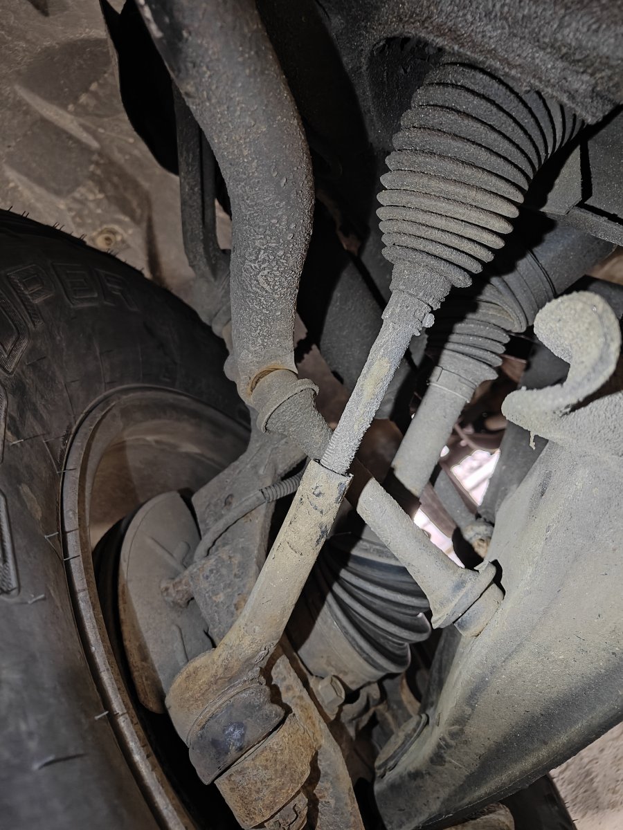

After work today I lifted the front of my truck and it appears to be a bad inner tie rod on the passenger side. It looks like these are discontinued from Motorcraft so I'll have to get aftermarket.
Can anyone recommend Moog or Mevotech? Is it recommended to replace both tie rods of only one is bad? Should I replace the boot too? Thanks!
Everything else seems fine so I don't see any reason to throw parts at it.

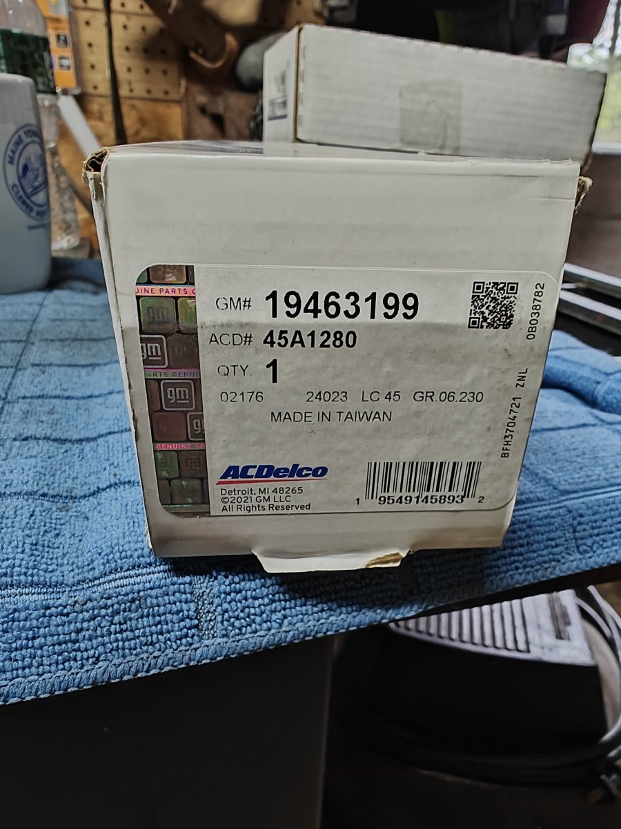

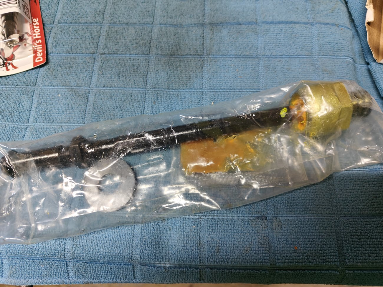

When I ordered these Ac Delco Gold inner tie rods it never occured to me that Ac Delco made GM parts. Are these the correct ones for my truck? Just seems odd to have a GM sticker on the box lol
If the part number is correct…
A lot of parts anymore probably come from a couple factories. I’ve opened Duralast (Autozone’s house brand) boxes before and dumped out a part stamped Moog or Bosch or something. Brand on the box doesn’t seem to matter a whole lot anymore.
Personally, any wear parts for my stuff, I buy from Autozone for the lifetime warranty. OEM parts are getting harder to source for older stuff and general quality of parts has gone down. So I joke my trucks have a lifetime warranty…
Yeah true. These inner tie rods are discontinued by Motorcraft or I would have gotten those. I'll look at Rock Autos website and see if these are an alternate for the OEM part #. Just seems odd to have a GM part.... As long as it fits I don't care.
Things like that usually just come in a box specified by the customer from the actual manufacturer.
I'd suggest replace those sway bar end links as well. The one in your pic looks questionable.
Ok thanks, what would you recommend? OEM or links with polyurethane bushings?
